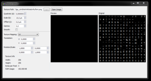

StompinTom wrote:When using a texture to control coating thickness, the input field could use a couple more decimal places! It's not possible to enter 0.0000001, for example... Perhaps a multiplier?
How about simple textfields in place of those numerical sliders, so any value can be put in, including scientific notation ? "Can't do better with it" is not good enough :)
edit: I'll add that the up and down arrows as currently are of little help because their increment is arbitrary.

The units we added to the parameter contols (in the material editor) were meant to be passed through to the texture control, it just didn't happen (yet). I just added that to the next version.
Nick also made the spin boxes take more decimals and I added some code to trim the trailing zeros :)
The texture from the coating parameter

Post by CTZn » Thu Dec 06, 2012 4:18 pm
Good stuff, thanks guys.
