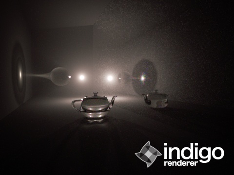

ior wrote:Try to render my orignal scene and have some caustics on the reflection of the pot (no way!).
I don't see any mirror on the scene you've uploaded, It's equal to the first scene.
And on the picture, it was NOT made on indigo.
Yes, there is a large flat mirror dividing the scene, on the right side. That is why you see two pots and two lights and two spheres.
Try to have some caustics on the reflection of the pot, i think this will be very hard:
pixie wrote:And on the picture, it was NOT made on indigo.
None of the existing unbiased renders can do that in 30 seconds. for now iv done simple test with fryrender (to long to get caustics) and i will try maxwell. I will post some tests when i have time and proper internet.

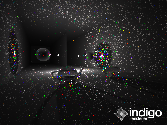

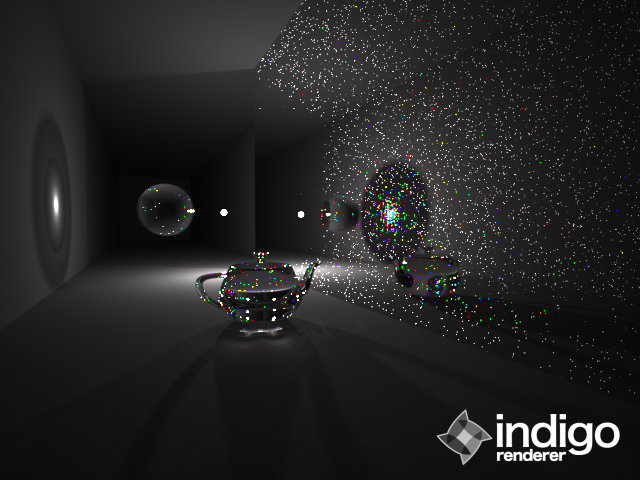

Lets admit that indigo and other unbiased renders have problems with reflection and refractions of caustics.
If a mirror get hit by light it will cause caustics to the scene (witch will render fast on objects illuminated by this mirror caustics with BiDir), but on the other side of the mirror the caustics will render very slow compared to the caustics that are viewed directly by the camera (no idea why the render as this behavior), it should render slower on the mirror but not 1000 times or more :( .
With BiDir+MLT witch was said that was the best to tackle this problem, small caustics will not be visible (because MLT is rendering them), only the larger ones, but you have to wait 100 times more time to see this larger caustics (small ones not rendered at all even if you wait for ever).
With simple PT all the scene caustics seems to behave like inside mirror caustics so when there is a mirror in the scene, the caustics will be even in all the parts equally, but it takes lot of time, till all the fireflies disappear.
With only BiDir all seems to work well, like iv said, the caustics converge nice on the scene but on the mirror side is like you are using PT, wait 1000 times more than on the objects viewed directly by the camera.
There is something wrong here, why is a caustic on a mirror is so difficult to render if it render fast on direct geometry? A ray path when reach a mirrored object just bounces back and what one should see on the image is the color of the object it hits next, if that is already fine in the image, what is the problem of rendering this extra parts that are seen by the mirror, the same way the direct parts are, and then with little effort display them on the image?
Can this bee implemented?

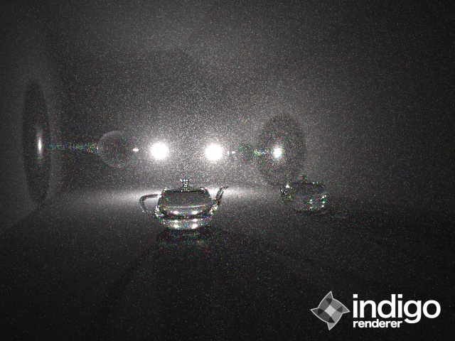

The glass cauchy_b is ste to 0.003 only for testing, in this case there is no much difference in using it.
Iv been rendering the scene with fog with simple PT witch seem to be faster than BiDir in the mirror.
After 15h it looks tike this:
simple PT, 15h 69000 spp
