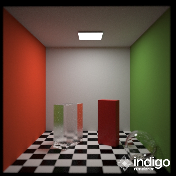

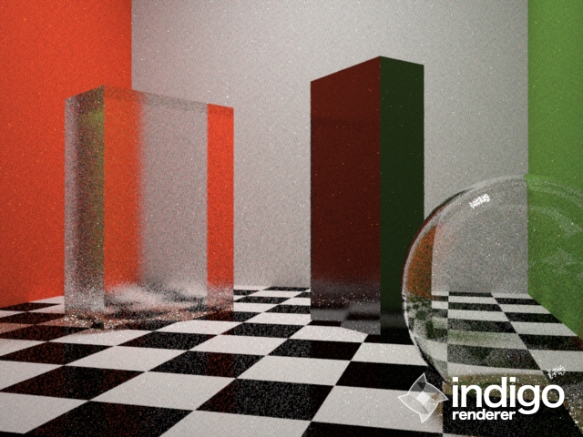

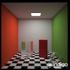

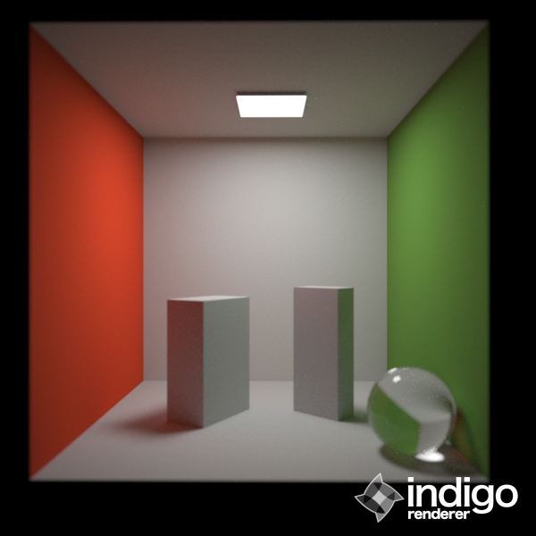

First litle test...It's work very well the interface it's in max style..I really like
Render time for render 1 e 2 it's 3m.
in the 3 render I don't have a render time max it's stop and I failed to save the file, I think this has happened to indigomax, why I closed the render buffer while render advanced and I open the render tad immediately
In the 3 render autofosus it's on, and the target of camera it's in center of the red cube
In the material don't work a bottom to add a map in the side of diffuse colore, it's work in the list of map
thanks

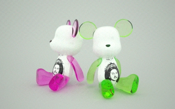

hi,
just a quick and incomplete test.
the scene is a simple vray test scene.
all materials are vray and there are 2 vraylight plane in the scene.
:D
subpixel
Posts: 237
Joined: Sun Mar 28, 2010 9:09 am
Re: IndigoMax ver. 0.2 - VRay support
Post by subpixel » Sun Oct 17, 2010 7:44 pm
Hey jinj,
Thanks for testing. That's a nice image. Anyway, there's still a lot to do with Vray support, but I think it's a good starting point.
As always, I'm open to suggestions and bug reports.
