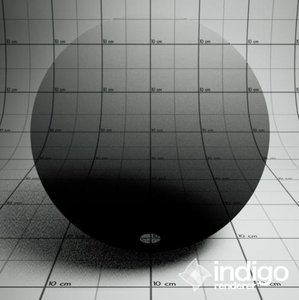

And I get this material:
As you will see at the base of the sphere the mist material is almost transparent, that's because the paper es above the sphere's base, but the material should be volumetric

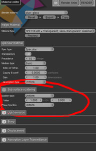

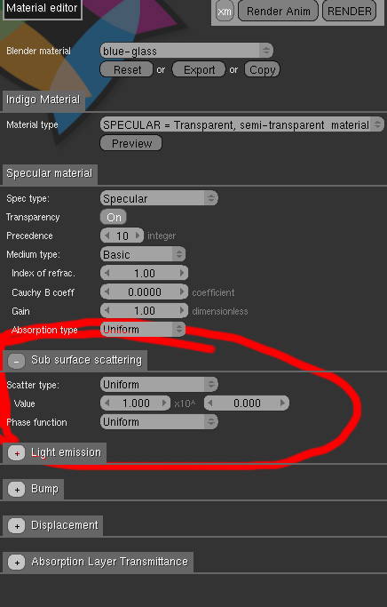

You need to use an SSS material. So something like IOR 1.0 (doesn't need to refract light) and a Uniform scattering factor of 0.01 or something.

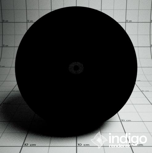

With 0.0 IOR I get this result:
edit 1.0, but the image is correct
