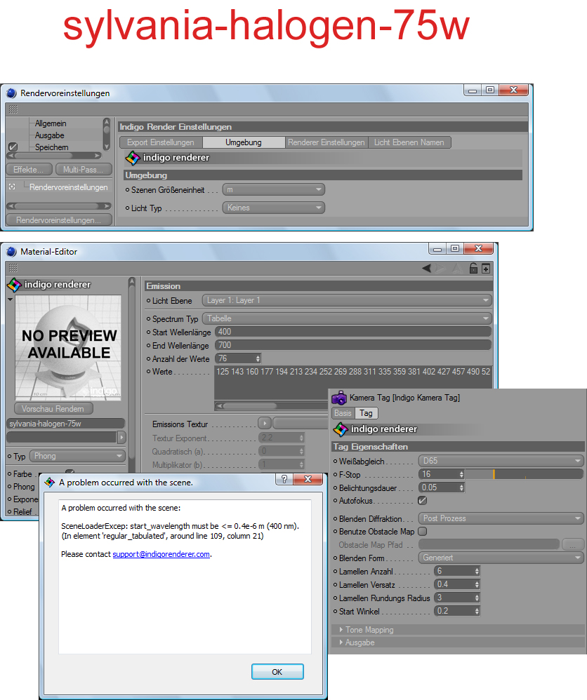

oll the Light-Mats dont work in Cinema 4D R 11.5!!
I have the aktuell Programmversions.
At the "Blue LED" my PC crashed completely. :evil:
I can the parameter "Start wellenlänge" set at zero-- the the renderer beginn,
but then all the colors are gone :cry:
What can i do? here my Preferences:
Regards,
Frank
http://www.cycot.de
Re: Many new light materials
Post by fused » Thu Feb 04, 2010 10:53 pm
Hm, yes I already heared about this. Investigating...

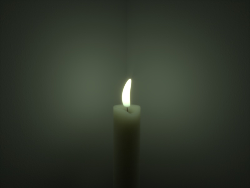

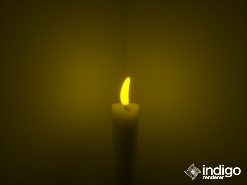

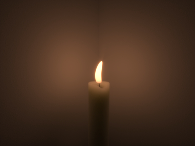

Danger of simple linear interpolation is that you can dramatically change the peak areas for peaky spectras, which then ends up in a sensible change in color.
I tried the candle-material again, cause to me it looks different than expected.
First picture is based on fused's code, second one is galinette's, both use "E" as whitebalance. Third one is second one with different tonemapping and light layer adjustments, custom whitebalance.
Just to illustrate the dramatic change of color. Which is really quite dramatic. Dougal, please double-check before defining presets! Cause it is really the coolest idea to have them working in blendigo!
