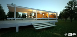

I would like to start a WIP on how to make very nice architectural visualizations. There are a couple of works I had seen here and on other forums that are very hard to distinguish from actual photos. This is the goal I would like to accomplish.

Some initial renderings, I prepared.

6c and 5g look great! I would work on the grass and leaf materials now: add some low, rough specularity and possibly some translucency, it's too diffuse and unnatural right now.
Re: Architectural Visualization Study - The Fansworth House
The last one, 5g, is by far the most fantastic ! Wow
Looks nice, but plants a bit flat as mentioned
I also find the vignetting pretty excessive and distracting. Makes the pics look claustrophobic
Like a really old beat up camera
I hope one day Indigo will have an on/off switch for vignetting...

Thanks a lot Tom! I'm working on that now. The grass and leaves materials have some translucency but it's not yet enough and it is not even noticeable.StompinTom wrote:6c and 5g look great! I would work on the grass and leaf materials now: add some low, rough specularity and possibly some translucency, it's too diffuse and unnatural right now.
Thanks a lot Stur! That image was also my personal favorite.Stur wrote:The last one, 5g, is by far the most fantastic ! Wow
Thanks a lot CoolColJ! For the vignetting, I still do not know how to control it .CoolColJ wrote:Looks nice, but plants a bit flat as mentioned

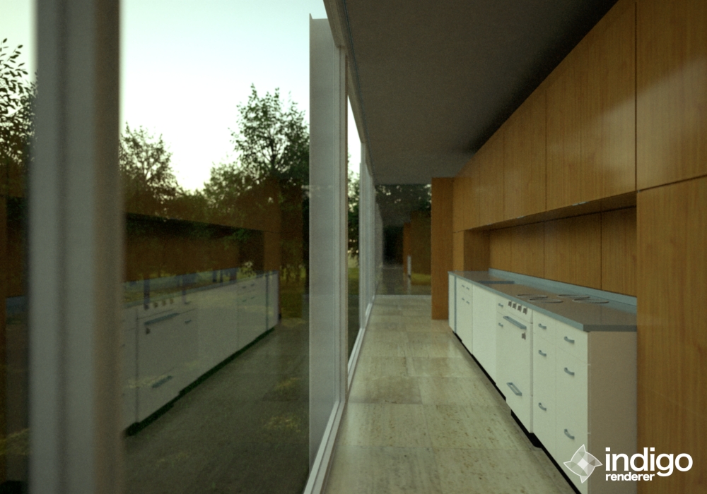

Some more exterior and interior test renders done during the past week. C&C's are very welcome.

Setting a smaller camera aperature value does seem to help reduce the effect. It's not too bad at f5.6 compared to f16Jeff wrote:

The Fantasy.
How much on time occupies the visualization.

Thanks a lot for the info CoolColJ!CoolColJ wrote:Setting a smaller camera aperature value does seem to help reduce the effect. It's not too bad at f5.6 compared to f16Jeff wrote:

Most of the renders are at 4000 samples/pixel and render times average from 8 hrs. to 15 hrs.on an intel core2quad 2.3 Ghz.Prof4D wrote:The Fantasy.
