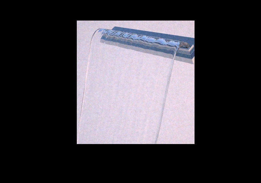

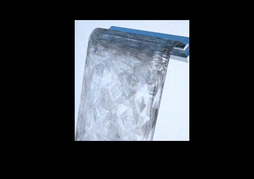

Next evilness is breaking SubDiv finally even more than it was :P
Best seen for transparent materials:
I just started and only had the same issue about the licence data with the Network manager.
At least networkrendering works fine for me and networkmanager finds master & slave,
but both are droping following message each 5seconds:
Making licence request connection to Network Manager at 192.168.0.71:7200...
Error: Request refused.Indigo sets them always to BlackBody 6500 and converts the color... so I loose my exported light settings -.-
Nothing gets detected, not RGB light not uniform, and also BlackBody with different Temp. gets converted to 6500.

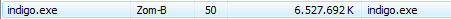

I had a issue in 2.2.12 for my renderslave where the networkclient started in indigo.exe doesn't get killed after closing, but stays in taskmanager crunching 1 core to death.
Now with 2.4.2 this is getting even heavier!
Closing my network client, it stays in taskmanager and grabs for 2 cores to burn them and also eats RAM each second like a pro:
