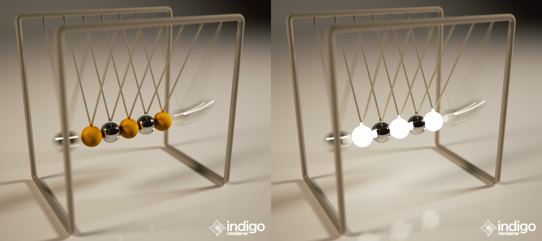

One example...
(with or without light, I don't know
Cotty
Cotty
Re: How to Use Motion Blur
Not tried yet, but after cotty's test I can't wait for!
Wow those are great! I like the one with lights because it makes you think how in the heck are those lights hitting the metal spheres without breaking!cotty wrote:One example...
(with or without light, I don't know)
Cotty
