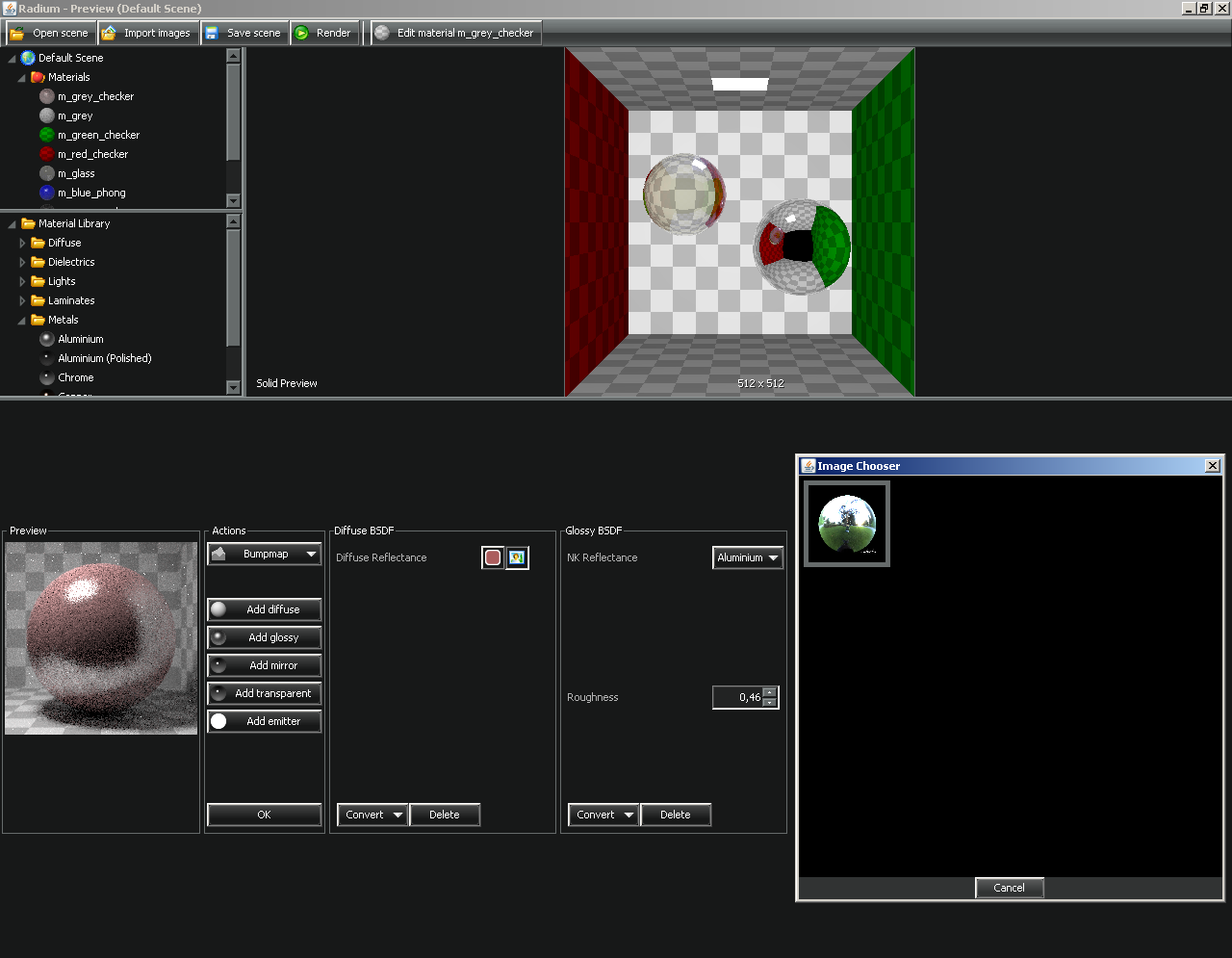

Hi all, last day I see the radium forum and I can see the second version of this renderer, and I can see a great menu and other day I saw too an images of preview menu of the next luxrender. I don't know if indigo in the future will have a menu to setup the scene but I think that's a great idea and I would like of course.
