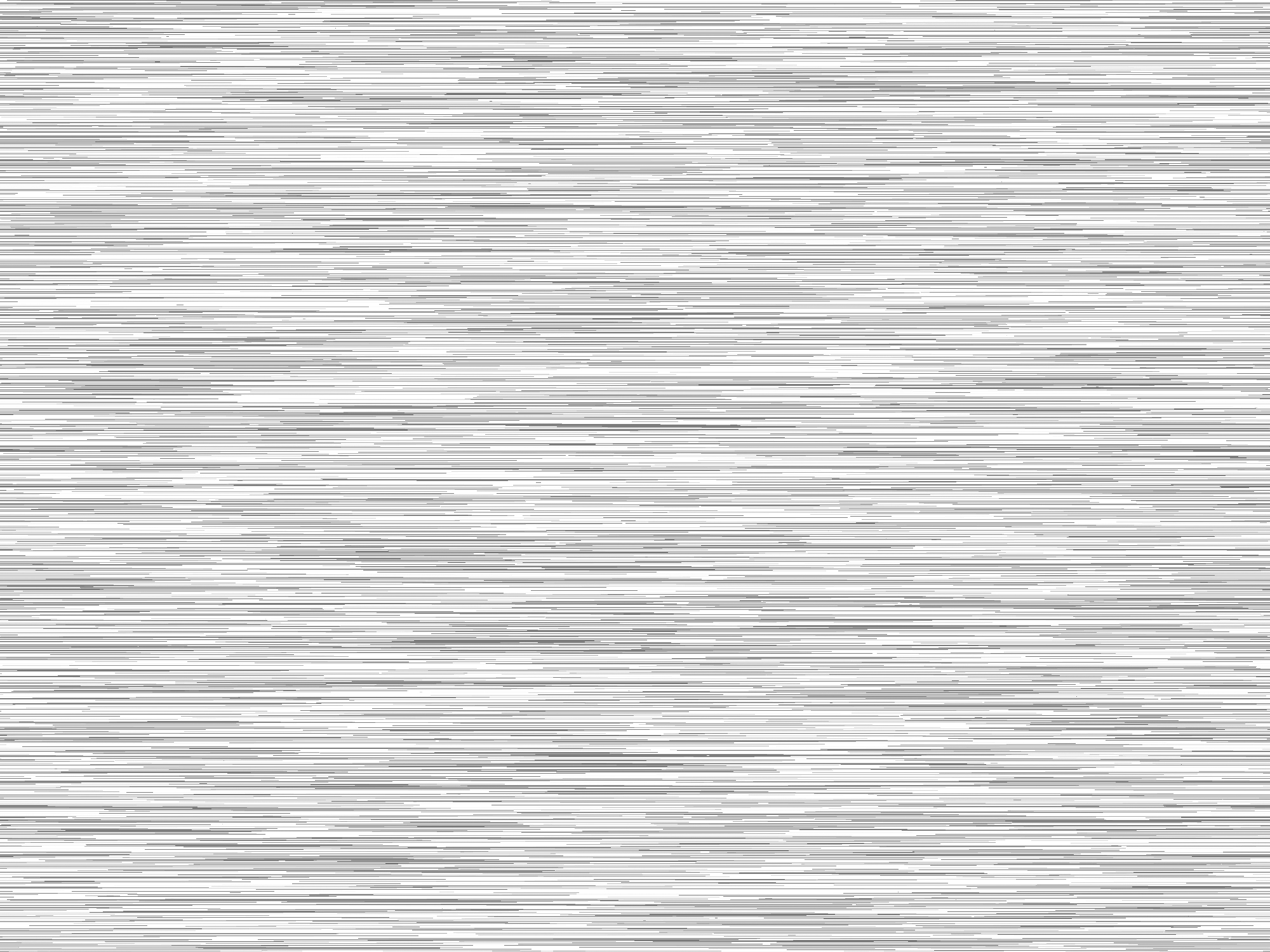

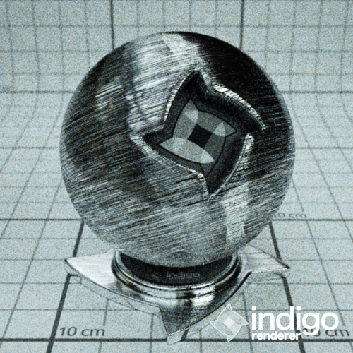

so, this time I've got new problem which (as usually) I don't know how to solve :/
not sure is there a problem with bump map or in other setting :/
I'm trying to make brushed aluminum and I don't know how to make it right. This is what I've done so far.
I was trying to do exactly as it was done in here:
http://www.indigorenderer.com/joomla/fo ... ht=brushed
I just used different map, and what ever I'll do I still have those black lines. I was trying to make it with 0.005 up to 0.01 bump but still nothing :/
HELP! :)

Post by Zom-B » Tue Jan 13, 2009 12:15 am
just use the B value for scaling the bump, A & C are more complicated to explain let them on 1, your line problem seems to come from there :)
try not to use a BumpMap, but a exponent Map for your material with a B value of about 100.
Post by CTZn » Tue Jan 13, 2009 1:03 am
Two things: as Zom-B mentioned the B (gain) value is way too strong, and bump technology is not well suited to work on aliased textures, blur it ! Actually black on white is worse than everything, that's where the issue comes from mostly. Bump needs shades to define a surface normal direction.

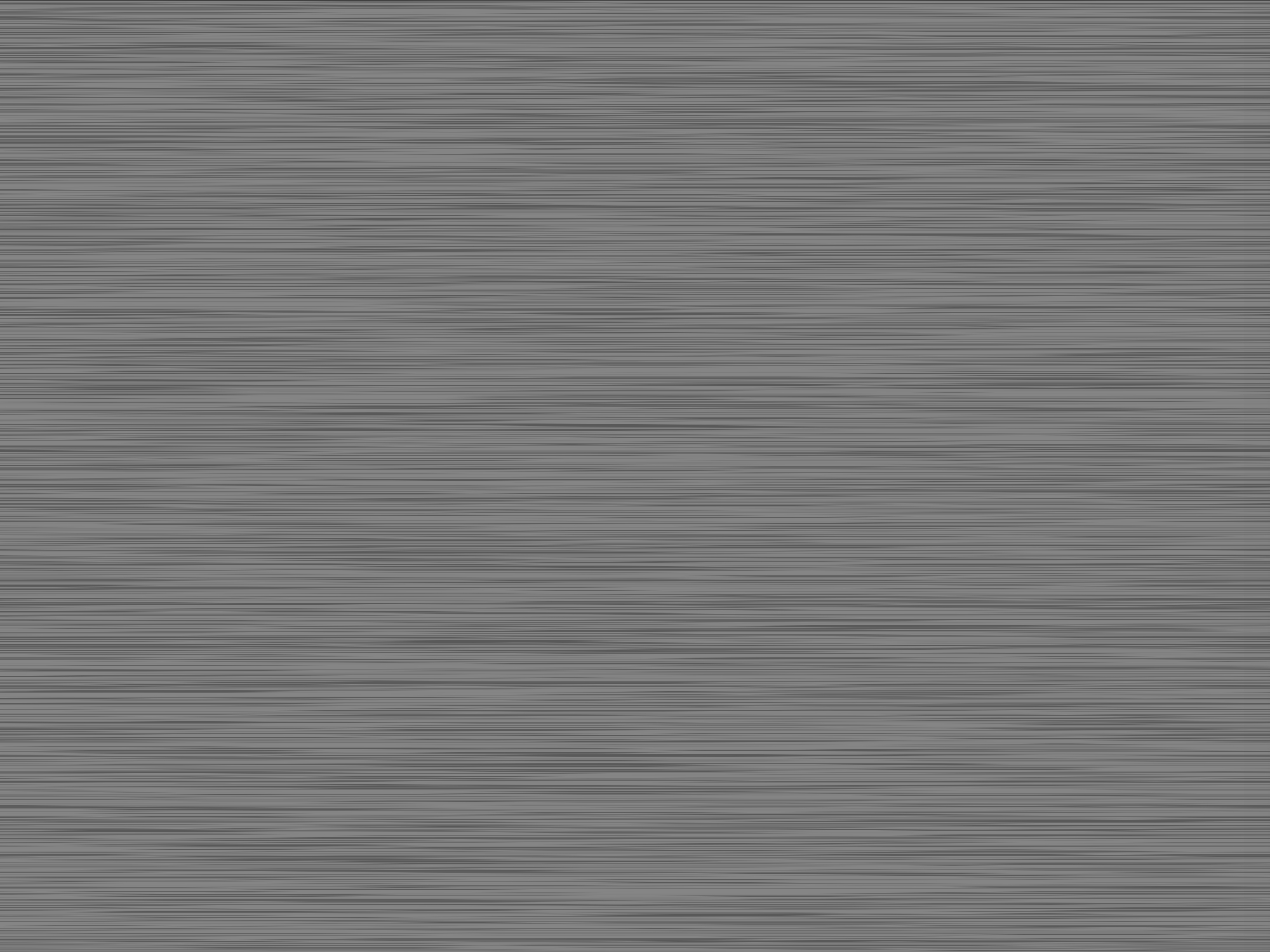

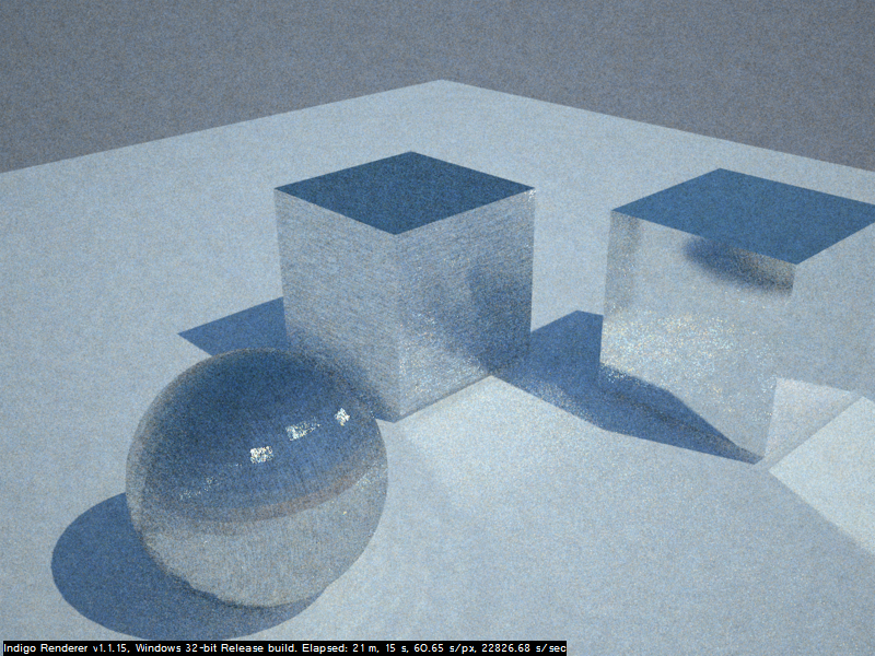

Post by ozzie » Tue Jan 13, 2009 1:04 am
I've used this same texture, but changed a little bit.
Thirst two objects from left are made just as it shown in blendigo, the last cube is just an PHONG al.nk with exponent map with B 100
I hope it will be fine :/

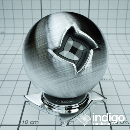

Post by Schosch » Tue Jan 13, 2009 7:39 am
def eval() real :
						fbm(dot(getTexCoords(0)*1000.0, vec2(0.0, 0.75)), 4)*0.0003
This shader stretches the fbm noise in a certain direction.
The factor after getTexCoords (1000.0) controls the general noise scale (the higher the smaller), the values of vec2 control the direction and the length of the scratches, the value after vec2 (4) sets the number of noise octaves (and thereby the amount of detail) and the factor at the end (0.0003) controls the depth of the bump effect.
I have added this to the MatDB: Brushed aluminium

Post by Schosch » Thu Jan 15, 2009 6:32 am
Interesting would be, if another bfm-layer (with different seed) somehow controls that stretch, "randomizing the stretch-distance" - if that's at all possible^^
def eval() real :
						fbm(dot(getTexCoords(0)*1000.0, vec2(0.0, clamp(noise(getTexCoords(0)), 1.0, 5.0))), 4)*0.0003
I've changed the shader code so that the scratches now have a more or less random length.
