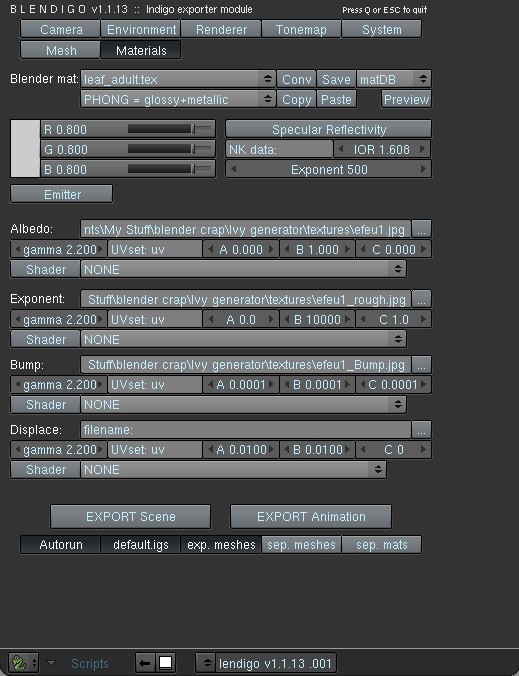

Somethings going on with the leaf material, they look semi transperent and the texture doesnt look like a leaf...just flat green. Im not sure why, but it should work.?

which material settings are you using for them? did you add a bumpmap? Or even better, did you model the whole shape? (That'd be the hardcore-variant)

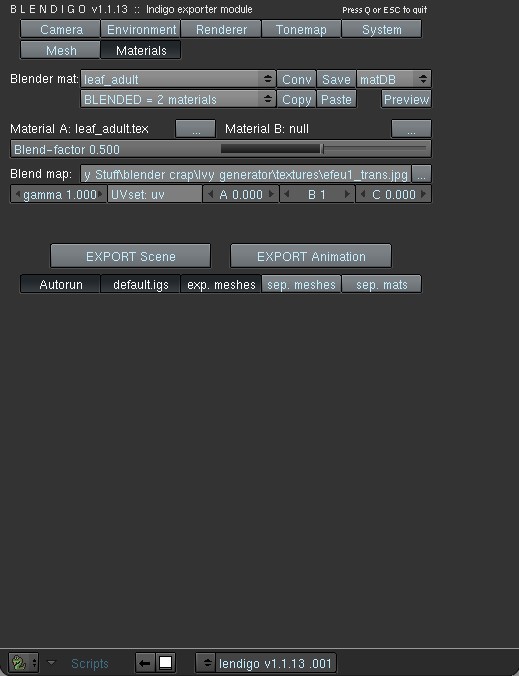

heres the material settings of the leaf. Also when i do a material preview of the leaf material half of the leaf is semi transperent, even though the blend map is completely black and white in the correct spots. Itd be nice if it were simpler to use alpha transperency where you only need one material(maybe a new material type?)

what if you would like to use alpha? Is it possible?

I think your blend factor is wrong... iirc it must be 1 for alpha-like behaviour

Post by ozzie » Sun Nov 16, 2008 12:05 am
so
1 material is (for example) glosy transparent (color texture)
2 material is glosy trnasparent (black-white - alpha chanel)
Post by Kram1032 » Sun Nov 16, 2008 12:35 am
At 2nd glance, it seems that the texture is only visible on the bottom-side of the leaves. Look at those in the shadow on the left and you'll see the texture...
try to flip all the leaves' normals, maybe? dunno...
Even better: give them a tiny volume (not like [] but like ()) and texture them on both sides....
