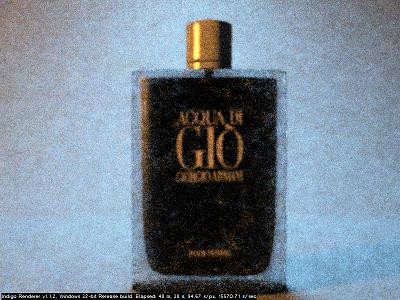

Hey guys..
I have been trying to render a Gio bottle, but i have run into a little problem..
I have 2 different renders here.. one is just a glossy transparent for the bottle, but in the second I have tried to add a little sss but it turns the inside black..? :? Any ideas to why that happens..?

Post by Phr0stByte » Thu Aug 14, 2008 12:54 am
hstokholm
The liquid inside should overlap the inside wall of the glass - you can see a good example at the end of this document: http://www.indigorenderer.com/joomla/in ... &Itemid=62
Also check your material precedence. Air is equal to one. Your liquid should have the highest precedence, followed by the glass.
Drinking glass example: glass 10, drink 11, ice 12
And, as always, check your normals.

Post by hstokholm » Thu Aug 14, 2008 1:55 am
Thanks Phr0stByte
It was actually a stupid normals problem.. The precedence was set right, but the normals on the inside of the glass was pointing outside.. stupid stupid me.. :) Will post the updated render when it has cooked a bit longer.. Things are SLOW on this little laptop..

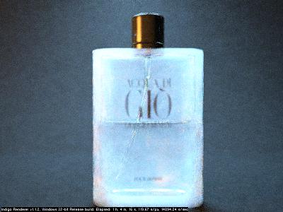

Post by hstokholm » Thu Aug 14, 2008 3:51 am
hmm are you sure..? I think this looks quite right..
Still have to work more on the materials though.. The text should be much clearer and the glass is still not quite right...
Like a jigsaw piece without a puzzle
Post by Borgleader » Thu Aug 14, 2008 3:59 am
I'm liking it :) Keep at it

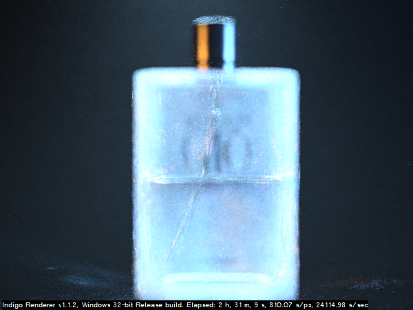

Post by hstokholm » Thu Aug 14, 2008 12:36 pm
Okay thanks.. Changed it now.. This one is out of focus but i kinda like the look of it...
Post by Borgleader » Thu Aug 14, 2008 12:47 pm
It's kinda cool, yet we can't see the text at all.

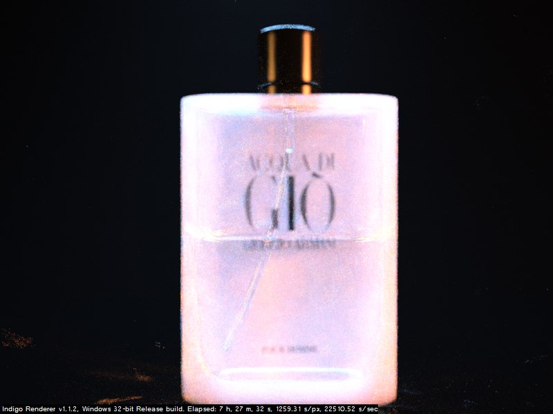

Post by hstokholm » Thu Aug 14, 2008 9:51 pm
I know I just can't seem to get it right... another try:
Post by Borgleader » Fri Aug 15, 2008 12:02 am
Well that definitely looks better. But I'm puzzled as to why the whole image still looks extremely grainy at such a high spp count. I mean at 1259 i would normally expect the image to look clearer.
