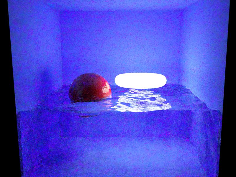

hi everyone!, the other day kikeonline asked me how to do caustics like this scene:
http://www.indigorenderer.com/joomla/in ... temId=5451
easy, i thought, but when i made the scene and rendered it, well, look what it came up (at the end of the post), it's quite lame, so, how to set up the enviroment to get that top notch caustics i see in that image from manitwo or this scene (http://www.indigorenderer.com/joomla/in ... emId=16099) by smartDen, the last one, i can see there's something like SSS, maybe?
thanks for your responsives!!! we'll apreciate the answer, kikeonline and me, hehehe! :roll:
BTW: i have tried everything, MTL, BiDir, Hybrid, and every value settings configuration among these, but nothing worked out!
no caustics...

under water caustics are quite problematic from seen outside the volume....
If you go under water, you'll see caustics ;)
Above, you need to increase your mncr value... There was a huge topic by CCJ, just about water and effects related to it.... Though, the behaviour of Indigo partly changed so I wonder how much the settings, worked out there, still are efficient....

You're getting castics underneath the water just fine - however your light source is so large that they're blurry.
To get sharp caustics, make a tiny light source.

sun light or even using an ies spot light will work better, large mesh lights are like diffuse lights, like zsouthboy said, they are there but unprerceptable, think of the type of shadows they would cast.

Yeah, think caustics as the distorted image of the light source, wich they are really. If you want lines then you have to start with a point.

Also, use simple path or MLT. No BiDir.
Post by OnoSendai » Mon Jun 09, 2008 1:24 am
bidir does nice caustics BbB :)
Post by BbB » Mon Jun 09, 2008 1:29 am
I never managed to get sunlight appear inside a water volume with BiDir, for some reason. Same problem as Bidir not showing sunlight behind windows, I thought...
Post by OnoSendai » Mon Jun 09, 2008 1:31 am
Yeah, pretty much the same problem, it's just a very tough sampling problem.

Not quite, cinema, as we stated a smaller light source was needed in order to obtain caustics like exposed in the first link.

Post by daniel_nieto » Tue Jun 10, 2008 1:39 pm
i did what you told me to do guys...
here's what i got

water = <normal_smoothing>false</normal_smoothing> with displacement ?

jajajaja i think i forgot normal smooth, well, i made this starting out with a plane, then i subdivide and fractalize it "thrice", then i just extrude the faces in Y axis and subsurfed it, but i actually forgot normal smooth... no displacement....indeed
