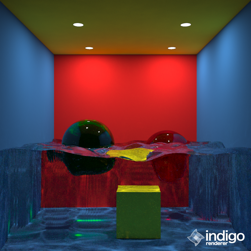

hi everyone!, the other day kikeonline asked me how to do caustics like this scene:
http://www.indigorenderer.com/joomla/in ... temId=5451
easy, i thought, but when i made the scene and rendered it, well, look what it came up (at the end of the post), it's quite lame, so, how to set up the enviroment to get that top notch caustics i see in that image from manitwo or this scene (http://www.indigorenderer.com/joomla/in ... emId=16099) by smartDen, the last one, i can see there's something like SSS, maybe?
thanks for your responsives!!! we'll apreciate the answer, kikeonline and me, hehehe! :roll:
BTW: i have tried everything, MTL, BiDir, Hybrid, and every value settings configuration among these, but nothing worked out!
no caustics...
Image From México, Daniel Nieto .·.

You're getting castics underneath the water just fine - however your light source is so large that they're blurry.
To get sharp caustics, make a tiny light source.

sun light or even using an ies spot light will work better, large mesh lights are like diffuse lights, like zsouthboy said, they are there but unprerceptable, think of the type of shadows they would cast.

Yeah, think caustics as the distorted image of the light source, wich they are really. If you want lines then you have to start with a point.

Also, use simple path or MLT. No BiDir.
Posts: 6243
Post by OnoSendai » Mon Jun 09, 2008 1:24 am
bidir does nice caustics BbB :)
Post by BbB » Mon Jun 09, 2008 1:29 am
I never managed to get sunlight appear inside a water volume with BiDir, for some reason. Same problem as Bidir not showing sunlight behind windows, I thought...

Post by daniel_nieto » Tue Jun 10, 2008 1:39 pm
i did what you told me to do guys...
here's what i got
caustix
Post by CTZn » Tue Jun 10, 2008 1:51 pm
water = <normal_smoothing>false</normal_smoothing> with displacement ?

jajajaja i think i forgot normal smooth, well, i made this starting out with a plane, then i subdivide and fractalize it "thrice", then i just extrude the faces in Y axis and subsurfed it, but i actually forgot normal smooth... no displacement....indeed
