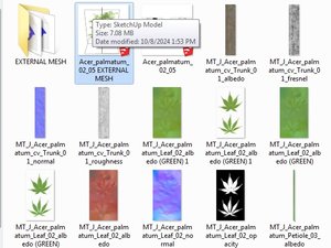

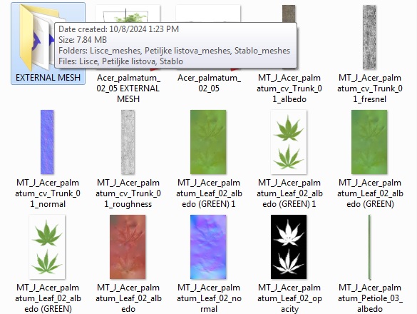

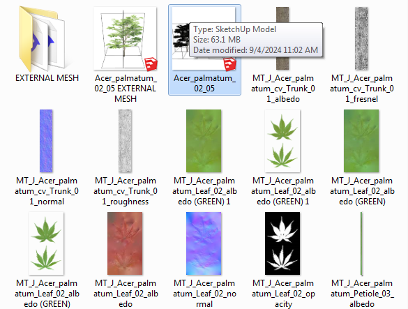

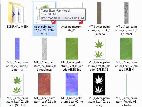

Yeah I got it, but I did a test and to be fair, using external mesh helps a lot in reducing memory usage. I don't know how it works but external mesh have multiple times less MB in files. So attached are files, images 1 and 2 show .skp file of external mesh component and folder of actual .igs meshes.
Image 3 show how heavy is actual .skp model of the tree and corresponding dummy which is ofc almost nothing, maybe dozen KBs.
So external meshes folder and .skp of external mesh component are combined about 15MB while .skp file of a tree is 63MB. When tested, indigo also starts fairly faster with external meshes than with original model and dummy.
Hope other SketchUp users find this useful

Sorry I am not checking Indigo forum so often. Actually it uses much less system RAM and GPU Vram when rendering external mesh than when using original model file/dummy.
So before I was also using transmutr to lower the file sizes of plants but in order to be remotely usable I had to lower geometry by 75% or even 95%, this of course decimated the model. Than I created dummy for so much simplified model and used it in scenes. Even then I couldn't import more than like 5-10 bigger plants.
Now I barely reduce file size or at least to extent where it doesn't remove petals and leafs, I create external mesh and just add as much as I like.
So for everyone using SketchUp, forget dummies for plants, use external meshes.

Hi Alamy, please sorry for not getting back to you earlier but I visit indigo forum rarely!

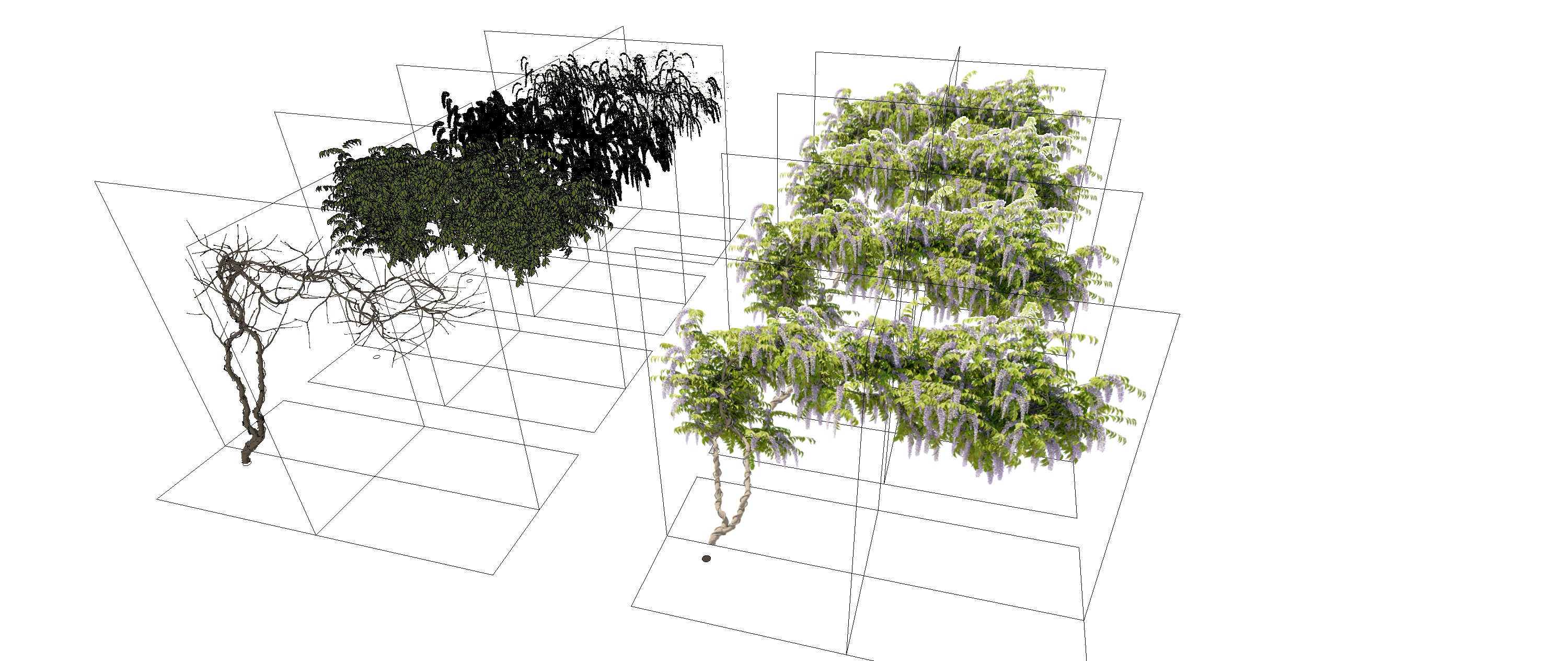

So I did struggle to figure it all out but it truly payed off. So for example, I am showing it on this quite heavy model of Wisteria model.
1) use Transmutr to lower the polygons of model to extent where it does not affect the visuals of a model.
2) open the newly created .skp file of a model (reduced by 50% in this case) and create a frame around it, slightly bigger than its original frame and add a small mesh (I used small circle in the base of a trunk).
3) create a dummy like component next to it (I used rendered image of the plant for easier usage later)
4) dissect original model into the groups per material, so for example all leafs are one group, trunk is another, flowers is another etc.
5) add the frame and small mesh from step 2 into all of these dummy like groups and set the origin of axes at same point as you did for original groups
6) copy the dummy like component in front of each group (for easier setting up) and apply the material of corresponding group to small mesh (from step 2) of corresponding dummy.
7) render the each group separately by "Render selected entities" option and once started, save the scene in desire folder (I create specific folder for each plant model) as IGS file.
9) Set up like this all the dummy like groups, move them to overlap each other, group them and copy them into separate skp file.
There, you got set up EXTERNAL mesh for that specific plant/model.
IMPORTANT REMINDERS!
1) Each of the dummies need to have same material in it like corresponding original group.
2) Sub groups musn't be present into original groups (for example, trunk group have only trunk model with no additional groups in it)
3) Axis ORIGINS and therefor size of the original groups and dummy like groups must be the same(hence the created frame on the begining).
It looks as complex operation but once you do it for 2-3 models, you'll get fast with it and it won't take longer than 20 min for plant models including setting up materials.

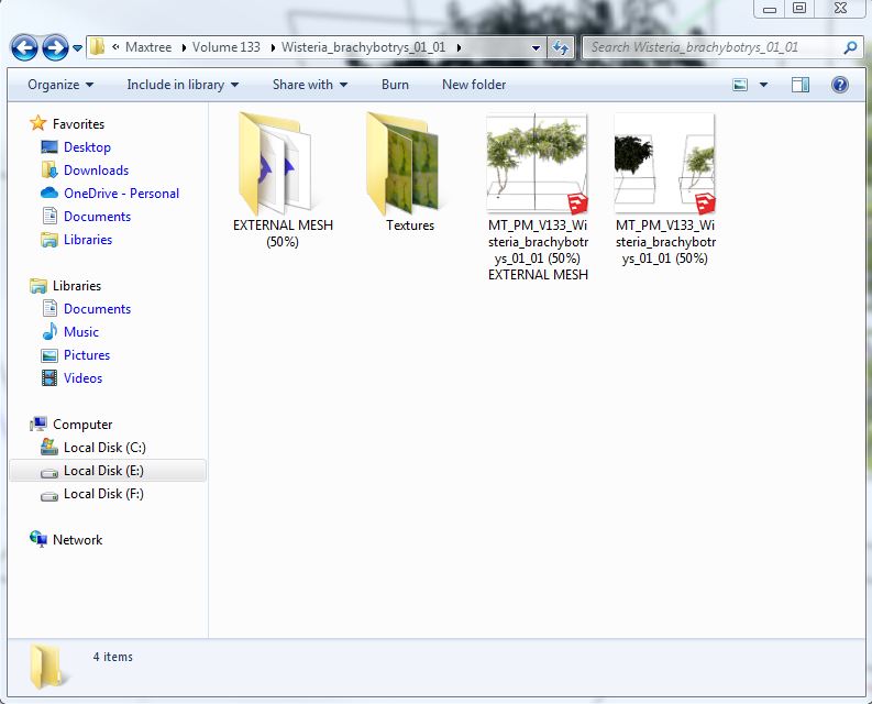

Attached are some images of mentioned wisteria model, organization of folders and usage in one of my latest renders. Original file have 377MB, and external mesh file have 17.8MB, while folder with IGS files have 49MB.
If you have any further questions, please let me know and I will try to help, when I come to forum again.
Good luck!
