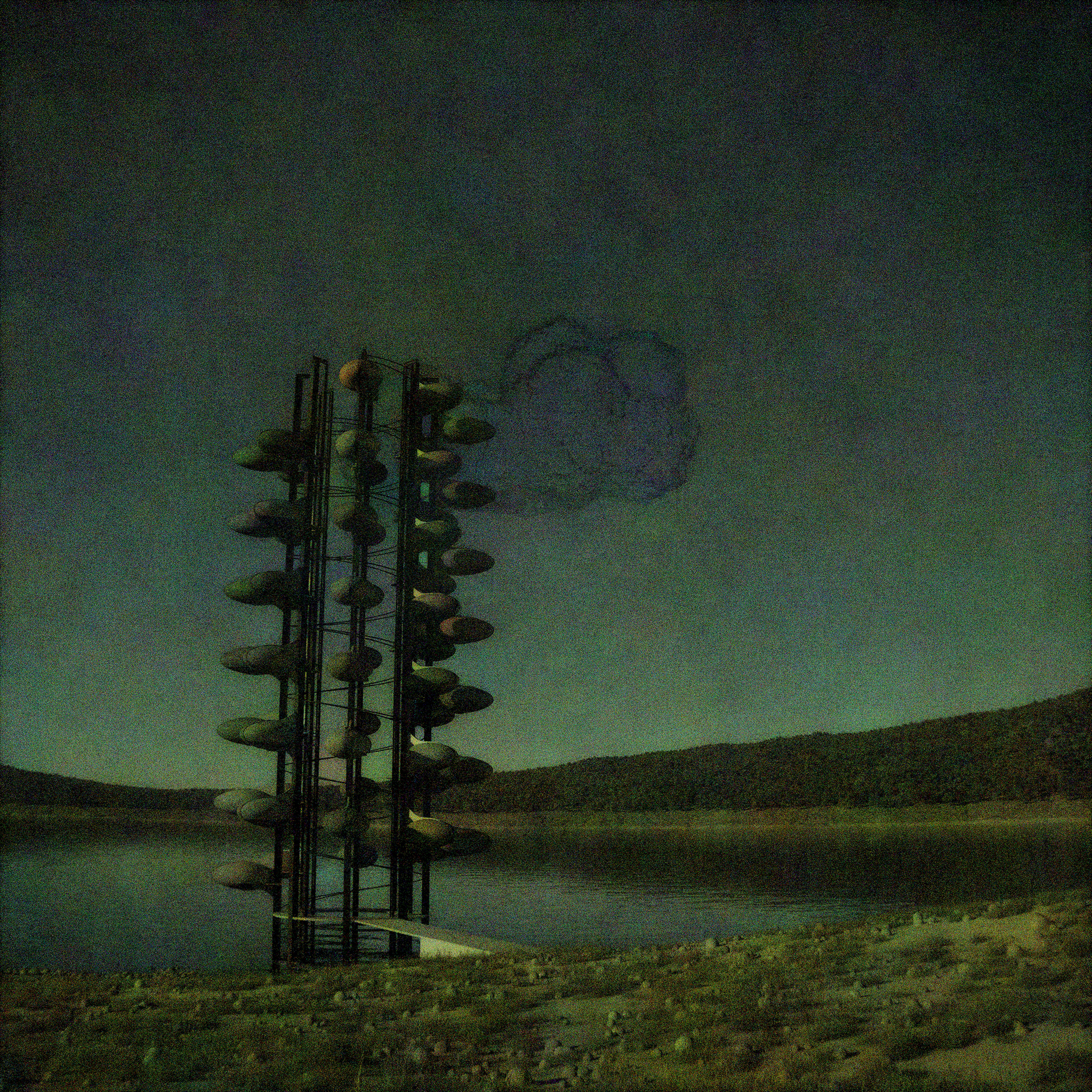

10 hours.
There are some problems with singular clouds (dark borders).
Here you can see what happens with an IOR 1.0, 0 absorption and 0 scattering.
For a null material seems OK. Is a bug. Now I understand why the light is sometimes modify with a cloudsbox...
Solved, a normal(phong) tag gives problem with specular materials of IOR = 1.0... Remove normals from mesh and shading normals in indigo.
Partially solved for this take, but seems not easy to work...
Is fast and clean. Uniform phase function in this one.

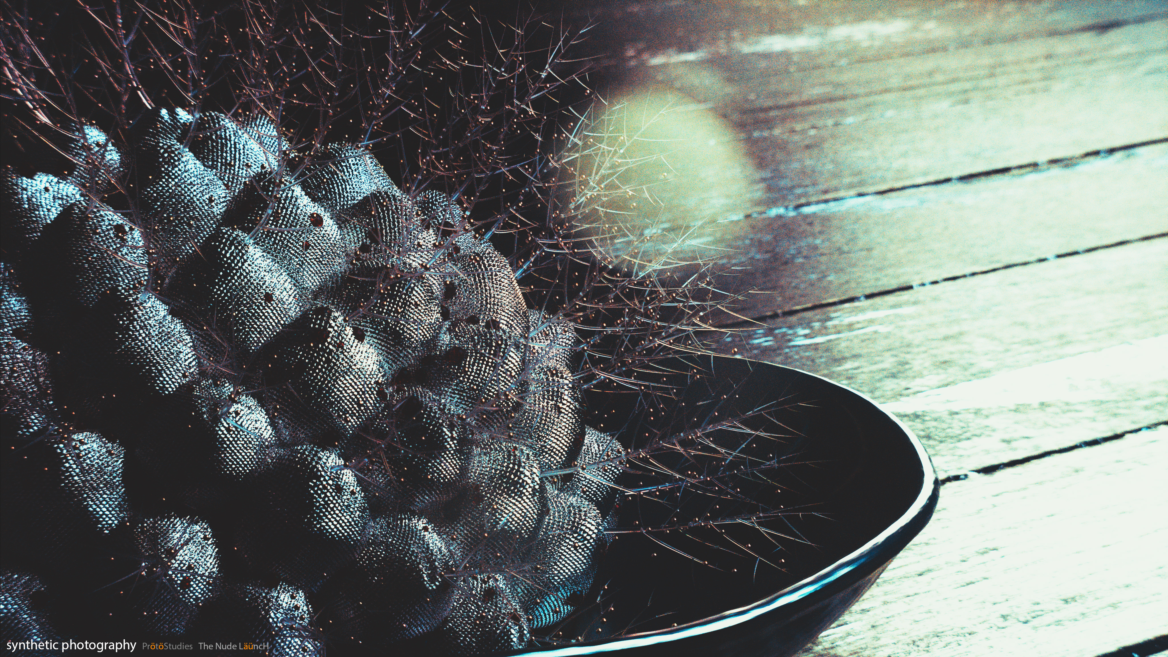

Post by yonosoy » Mon Feb 26, 2024 10:39 am
Pse, pse...
I lost the position and setup of the lights...
30 hours.
