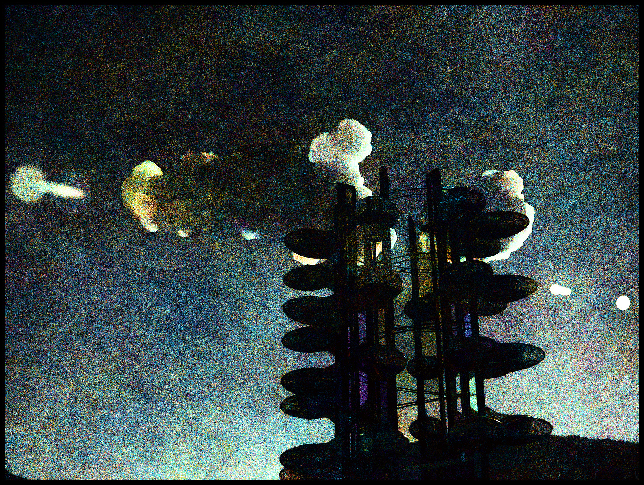

Re: synthetic photography

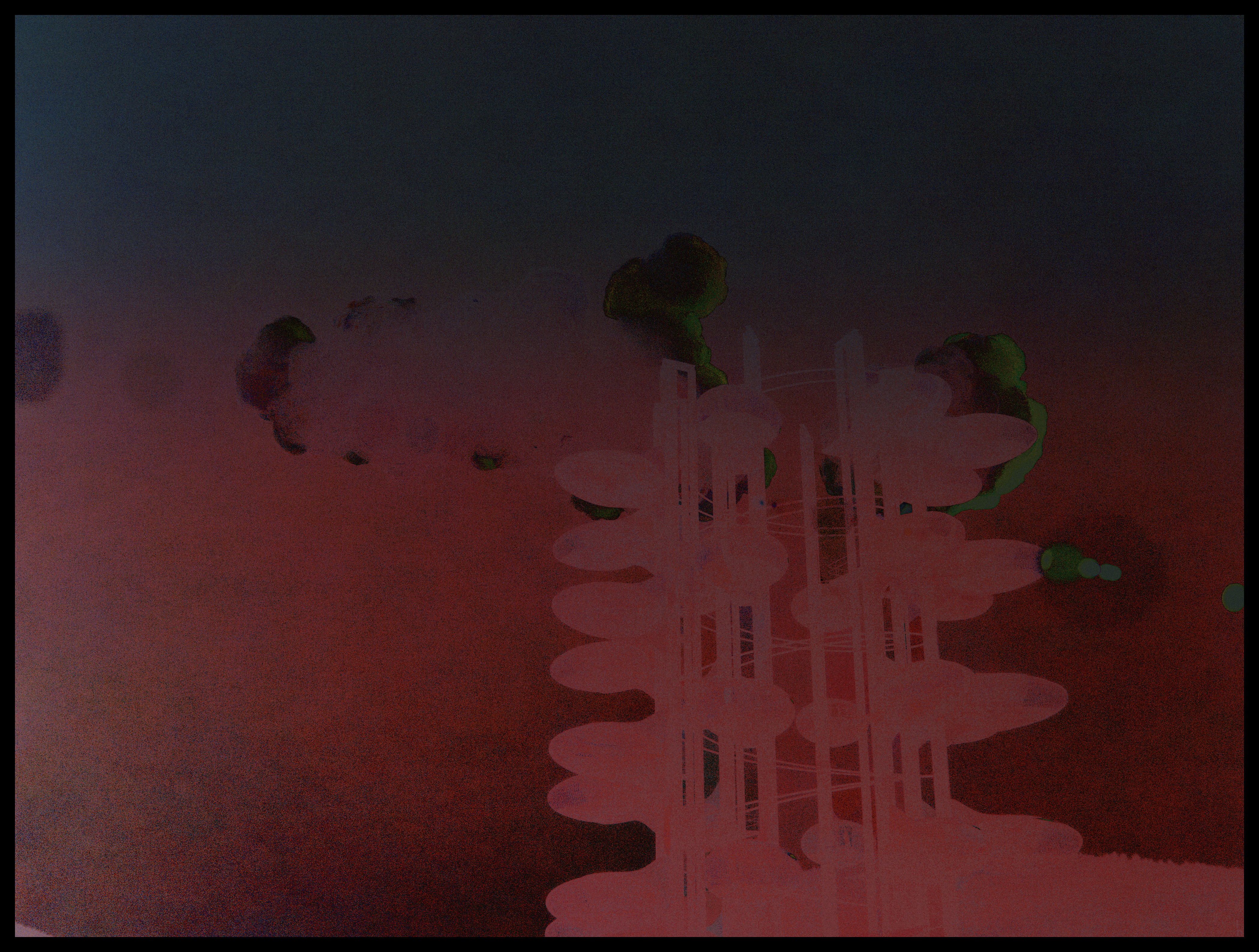

10 hours.
There are some problems with singular clouds (dark borders).
Here you can see what happens with an IOR 1.0, 0 absorption and 0 scattering.
For a null material seems OK. Is a bug. Now I understand why the light is sometimes modify with a cloudsbox...
Solved, a normal(phong) tag gives problem with specular materials of IOR = 1.0... Remove normals from mesh and shading normals in indigo. Partially solved for this take, but seems not easy to work...
Is fast and clean. Uniform phase function in this one.

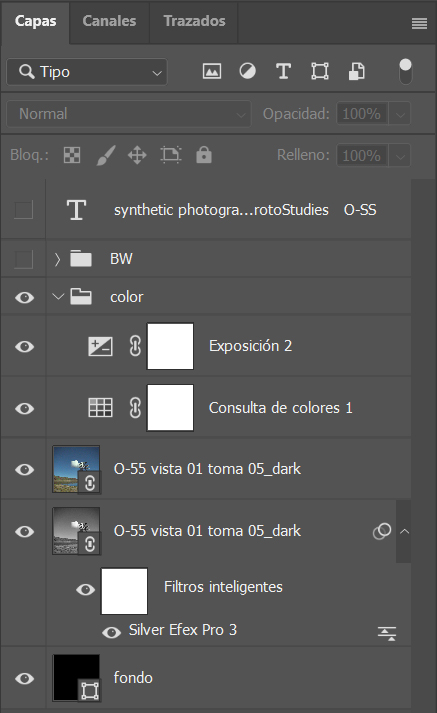

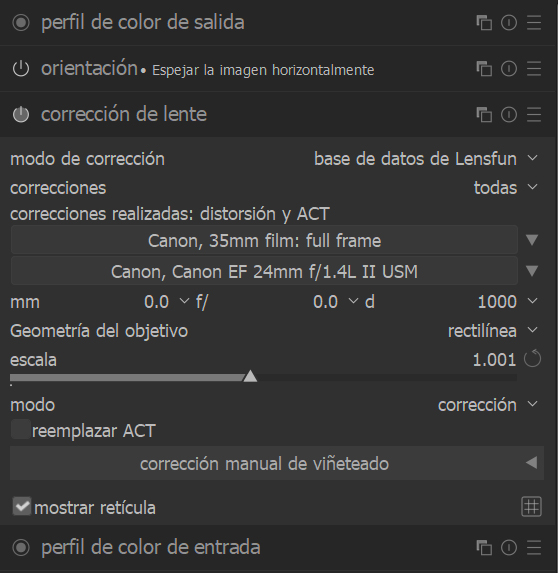

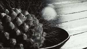

At last I´m learning to develop the linear tonemapped EXR...
1 Correction of distortion in Darktable. Profile: Canon full frame 35 mm camera (?), objective Canon EF 24 mm II USM.
Horizontal flip.
Output in png 16 bit (I can´t find another format that export the tones correctly). 2 Process in photoshop in 16 bit color mode.
Two instances of the darktable output like smart objects.
Bottom, Silver Efex filter.
Up, the instance with the layer mix in color mode.
The Lut (50 % opacity). Is an AGFA film.
Finally (and very important), a displacement of +0.01 in the exposure.

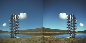

I can´t hate vignetting, is a serial element of the simulation.
Camera with double diaphragm that accentuate the effect...

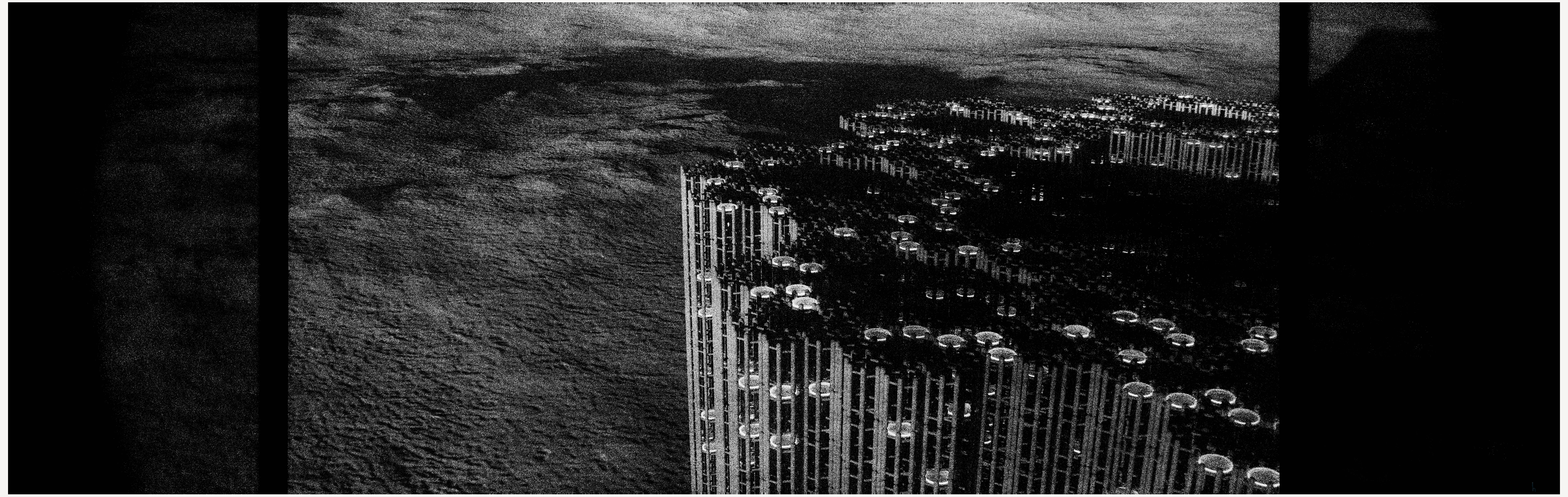

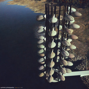

Second view over O-SS, seems that the difficulty to change the perspective is not so high...
Some scatters more. Must rectify some things for a more organic look...

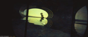

Sometimes, aperture is present...
In this case, in a half of hour process, seems to "homogenized with the incoming light to the image"...
Is a non ortogonal ortographic view of a photographic perspective... Yes, aperture diffraction present but a little weak.
Look at the back light...

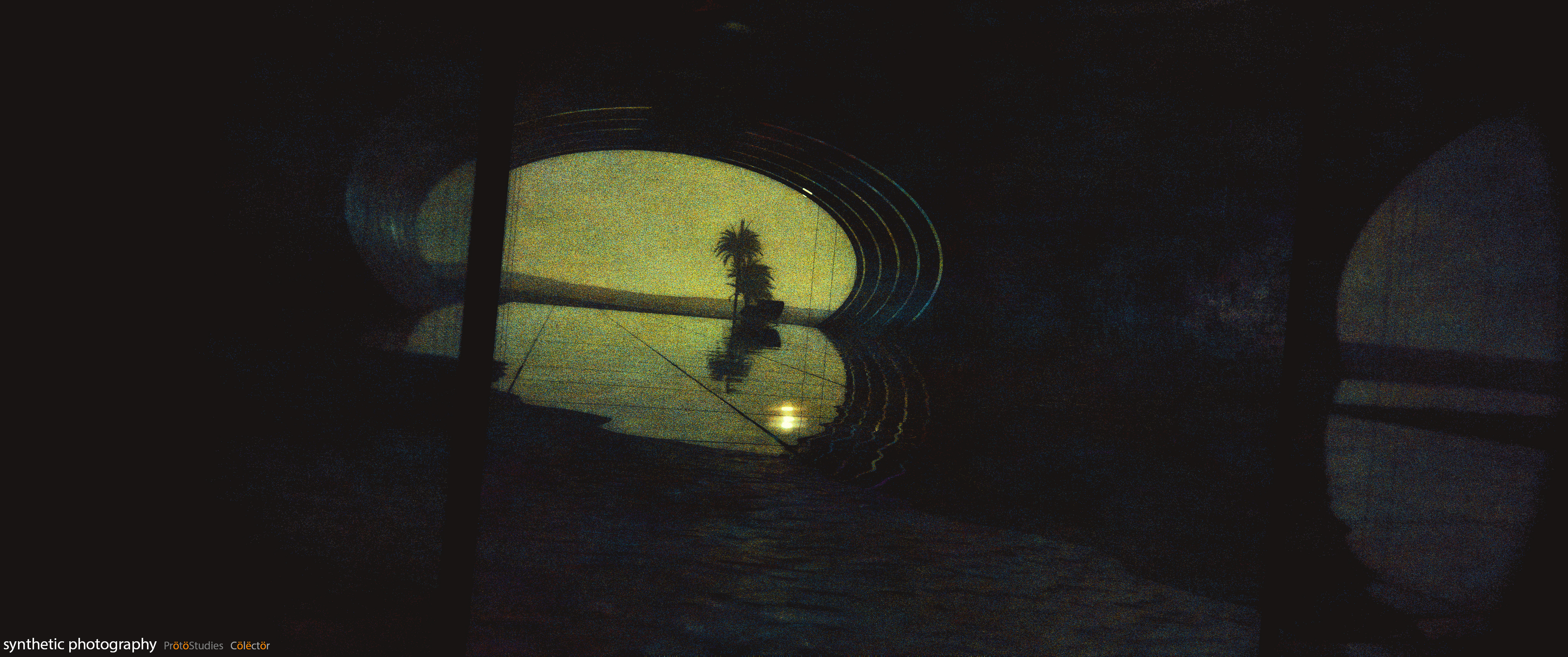

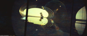

A bit "buggy".
Seems that the best practice with metropolis and optics is to leave the standadrd parameters of the algorithm. Is fundamental a value of o.4 in the large mutation probability parameter. Is a lot noisy, but is the only way to acquire good lens flares.
Look at this disaster. Lens flares from a reflection of the sun... But is imposible at the moment to acquire the rays of the aperture. Very strange... I must investigate deeper the models. 12 hours.
