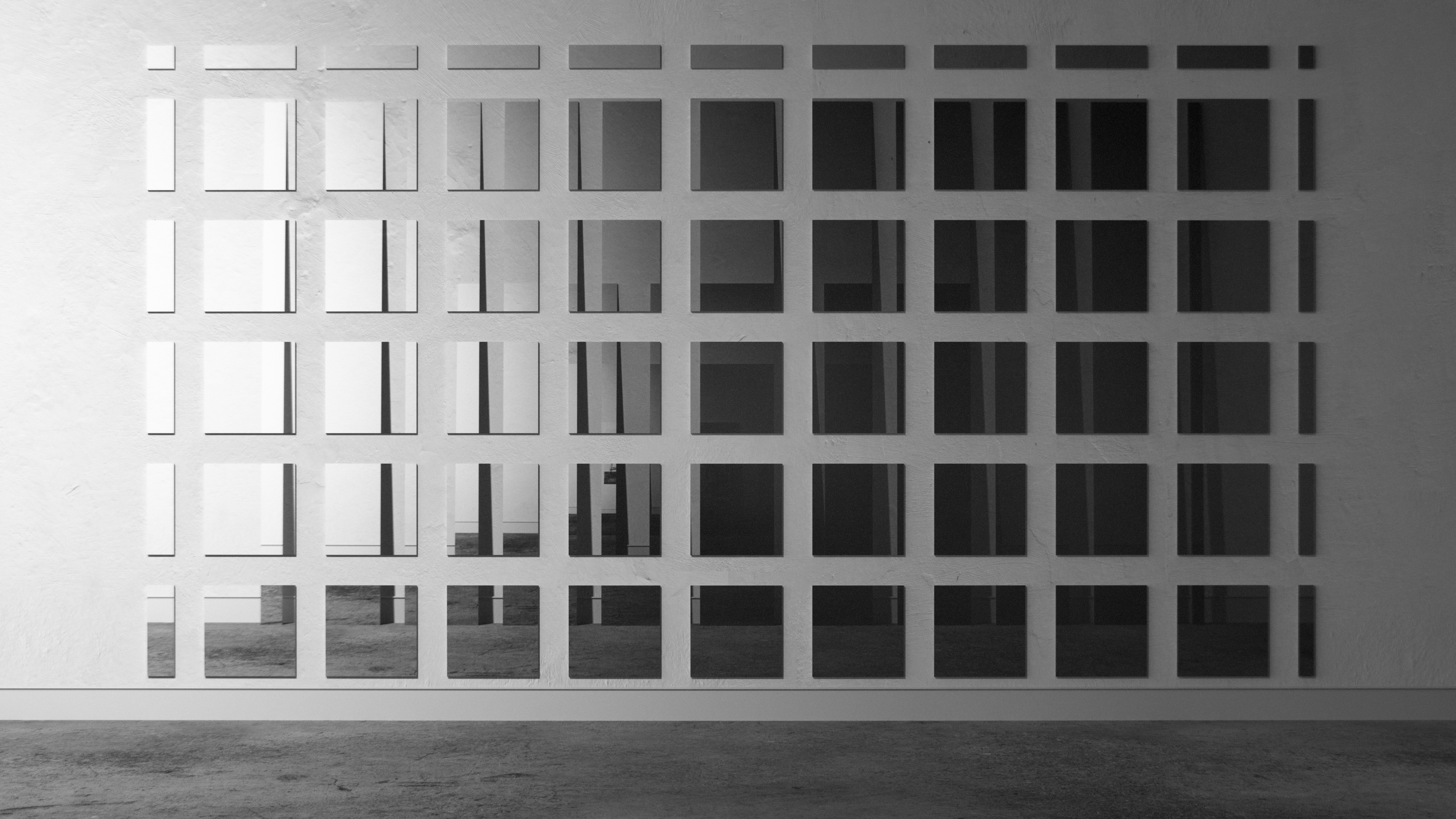

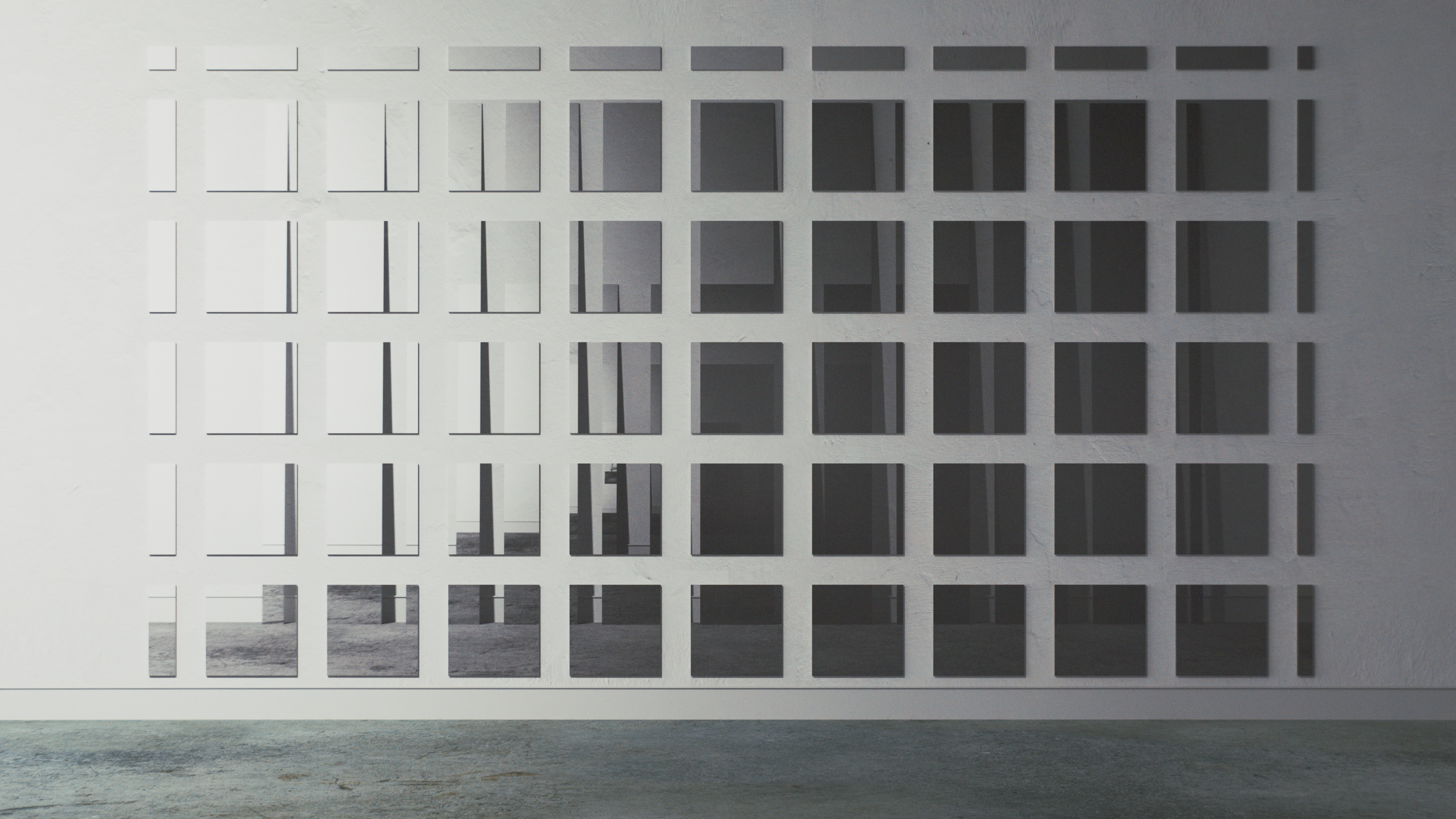

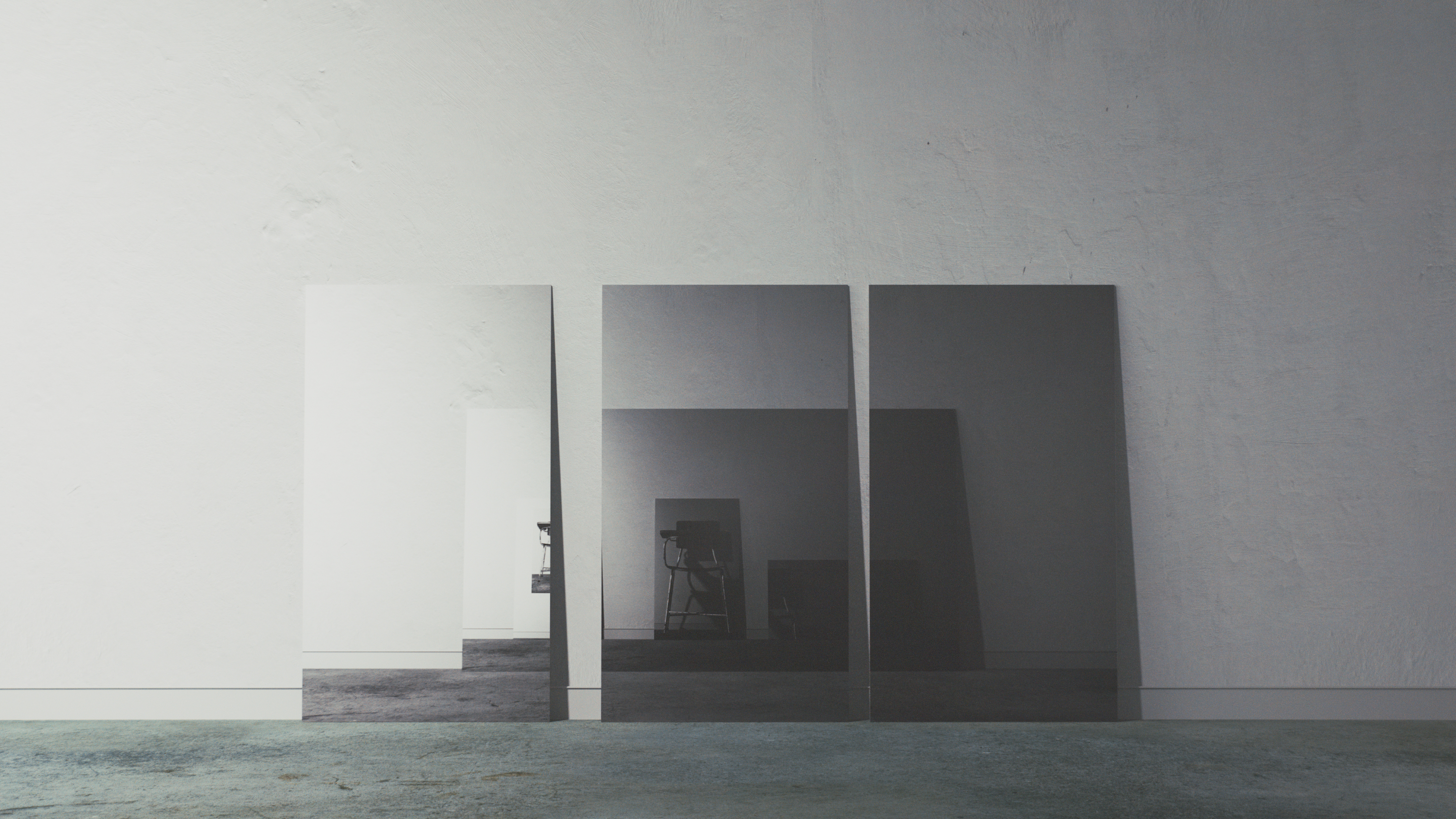

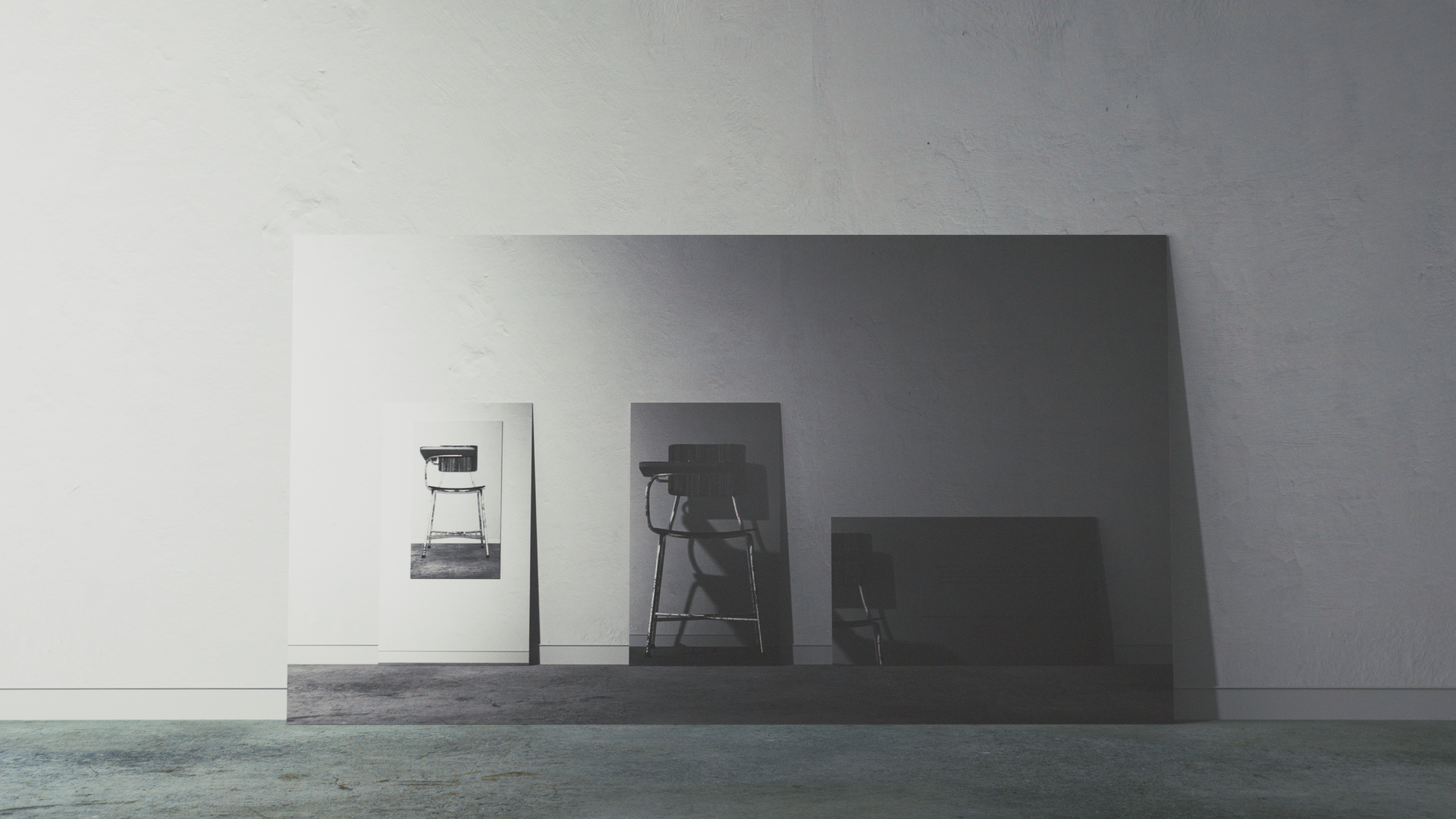

Re: Protoestudios
And the last.
Near 300 hours in total. Is only a game about art...
From Kosuth to Mondrian in a recreation and deconstruction of a chair...
Re: Protoestudios
PrötöStudies (chäïr).

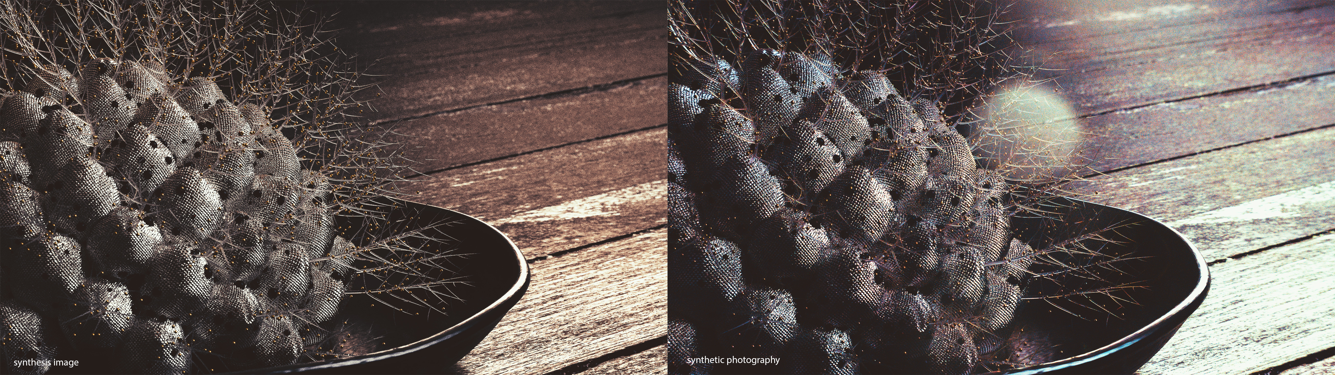

Re: Protoestudios
Sigma 56mm, F-stop 16, 8K, 43 hours, 1500 spp.
Aperture difraction of the silver seeds present.
I´m not agree with the human blood material, reflexions in the specular material are too weak and SSS is too dense (or the real tabulated absorption of the hemogobline is out of range...).
The displacement of the plate is wrong, want to change it for code that don´t need UV´s.
I feel that I could do it better with the table, actually is a displaced plane floating in an enclosed room... (this one is the "fault", fast investigation + a bit of lazy).
I want to define more precisely the soft boxes for ilumination.
Finally, I want to test some variations of composition and the Canon objective.
The text in the image... I know, but I like it.
Maybe I will make another shoot.

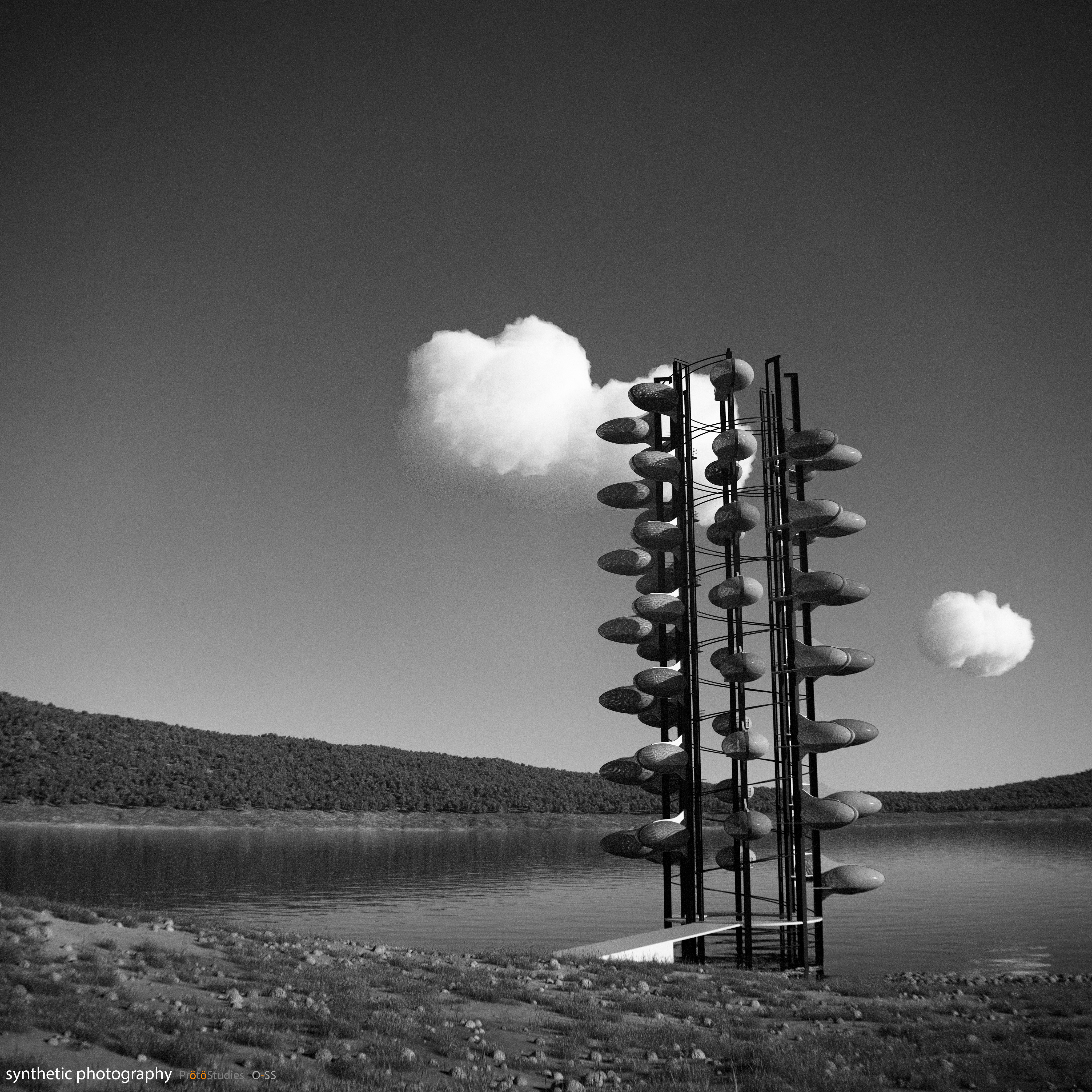

Re: Protoestudios

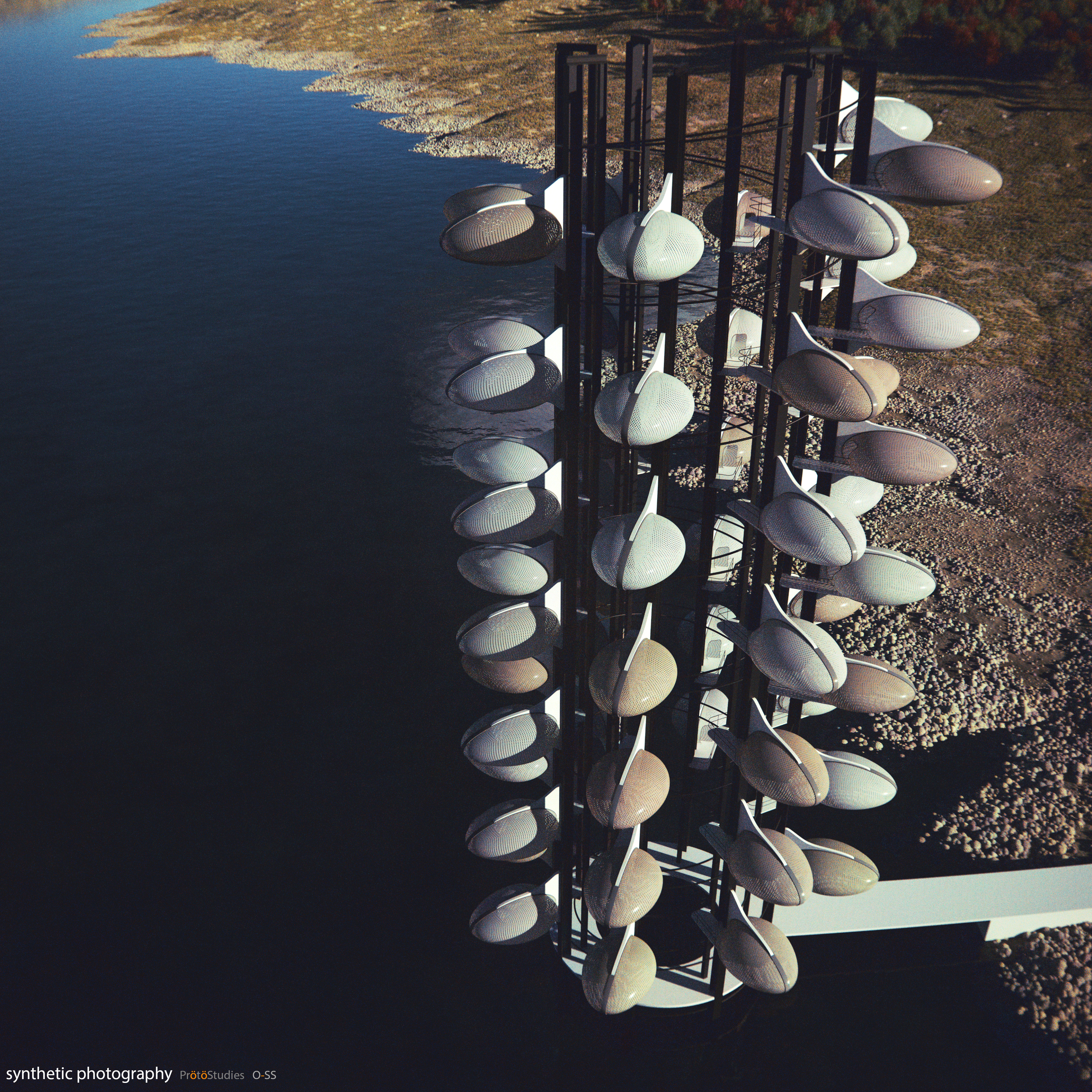

These are the ilumination possibilities for clouds, atmosphere and mie cumulus that I talk about. No noise. SS 4. 6K.
Protostudies O-SS, View one.
Two accidental shutdowns of power in the PC.
20 hours.
30 hours.
Probably I will go deeper more over.
In version 4.6.0 and upper, the light direction of the sun is modify by the cloudbox, a little bug.
Downsized to 25%. Same promotion and development.
20 hours.
30 hours.

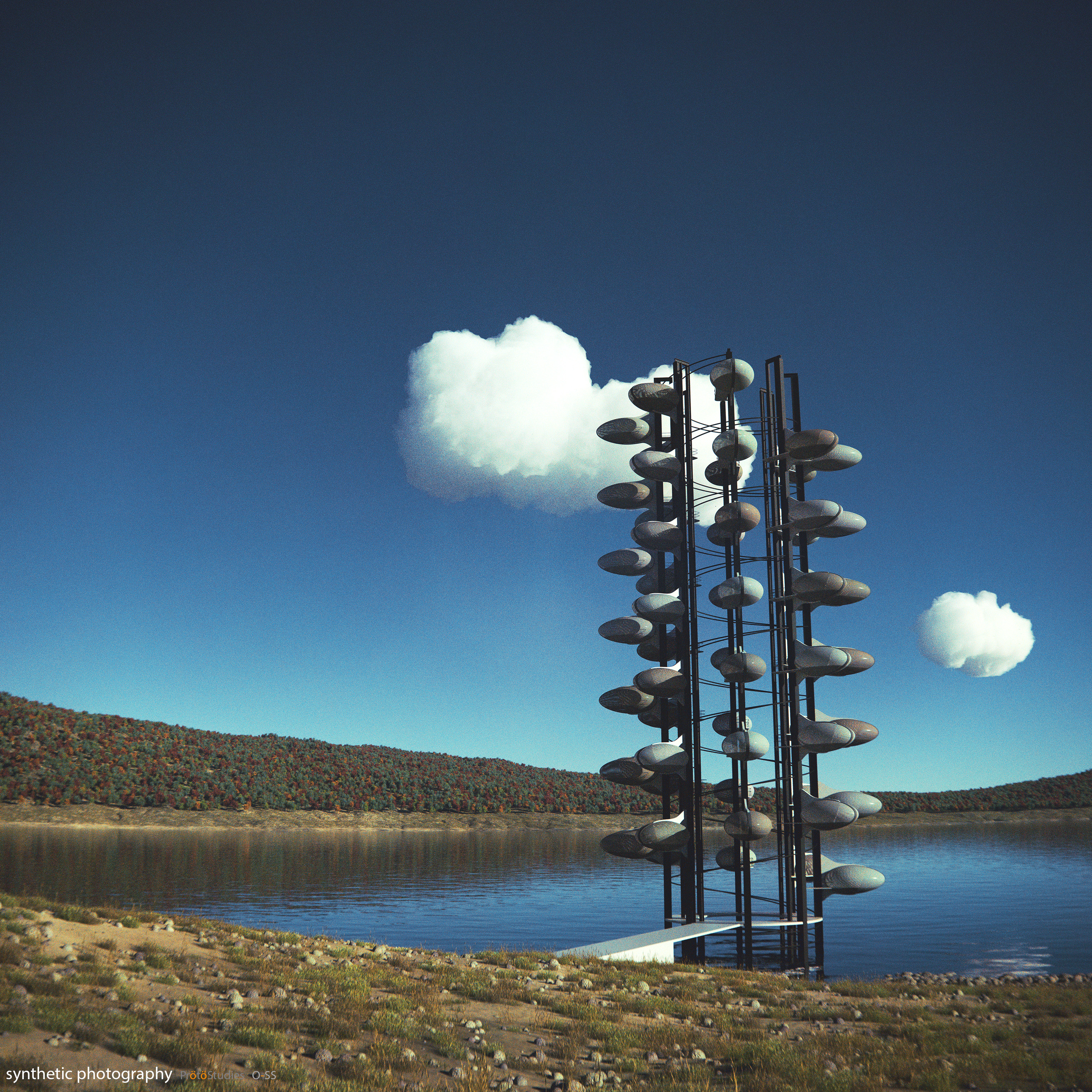

Re: Protoestudios
A study with singular clouds...
Near to launch the final serie.
In this case there are only the textures of the vegetation, and could be substitute for plane colors for this perspective.
Is a so little lie that I allow it. The fundamental thing is that there is no an "environment map" and there is no a "thin lens perspective camera" ruling the scene. This is a giant step for a synthesis...
Are you agree?
Are you agree?

Final render. Will fix more things in the nexts shoots...
Seems that if atmosphere has precedence 1 the bug is less present.

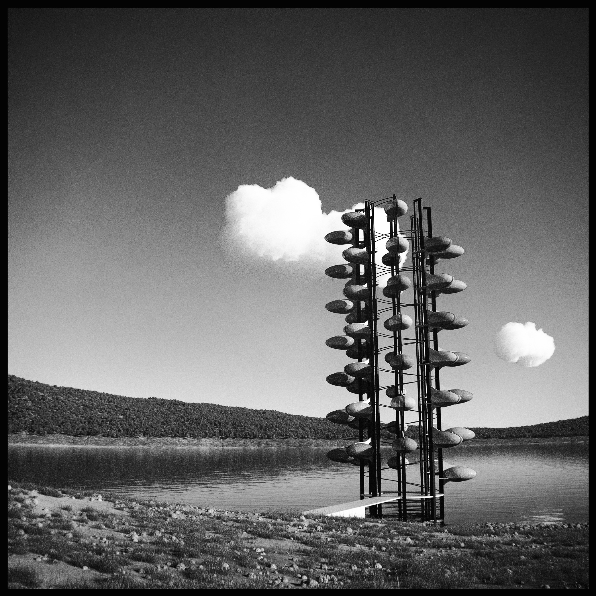

Black and white development SIlver Efex, Kodak Panatomic X.
Color development of the image reintegrated to darktable, except the final refinement of exposure (displacement) and text in photoshop.
The grain is perfect, no presence of any kind of noise.
In love...
View 1. .
View 2.
28 hours.
