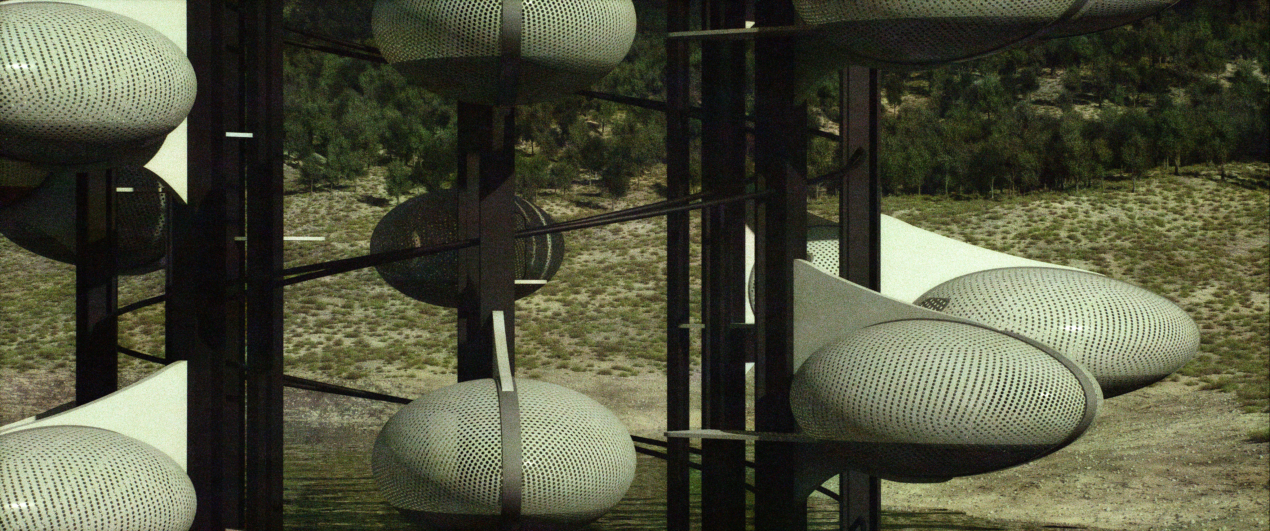

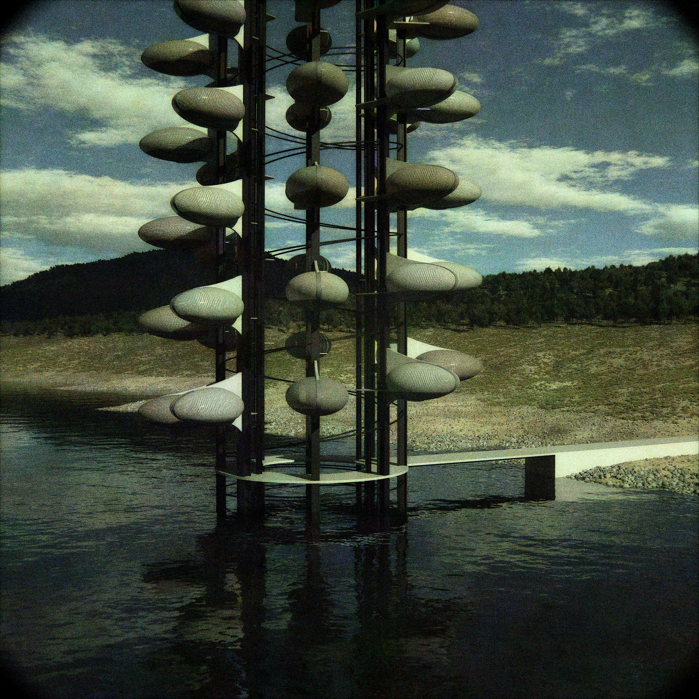

Re: synthetic photography
Protoestudios (O-55).
Work in progress. I will try to care the finished artwork thread.
Working deeper with houdini. I´m translating the proyect from cinema to houdini in order to get a "finished" one.
Later we see anothers correlative proyects like C-72, or S-33...
Sigma 56 mm mounted in a canon EF-M.
APS-C canon (22.1 mm wide), format panavision vertical.
8K resized to 4K.
1 hour.
A lot of things to do after render a complete study.

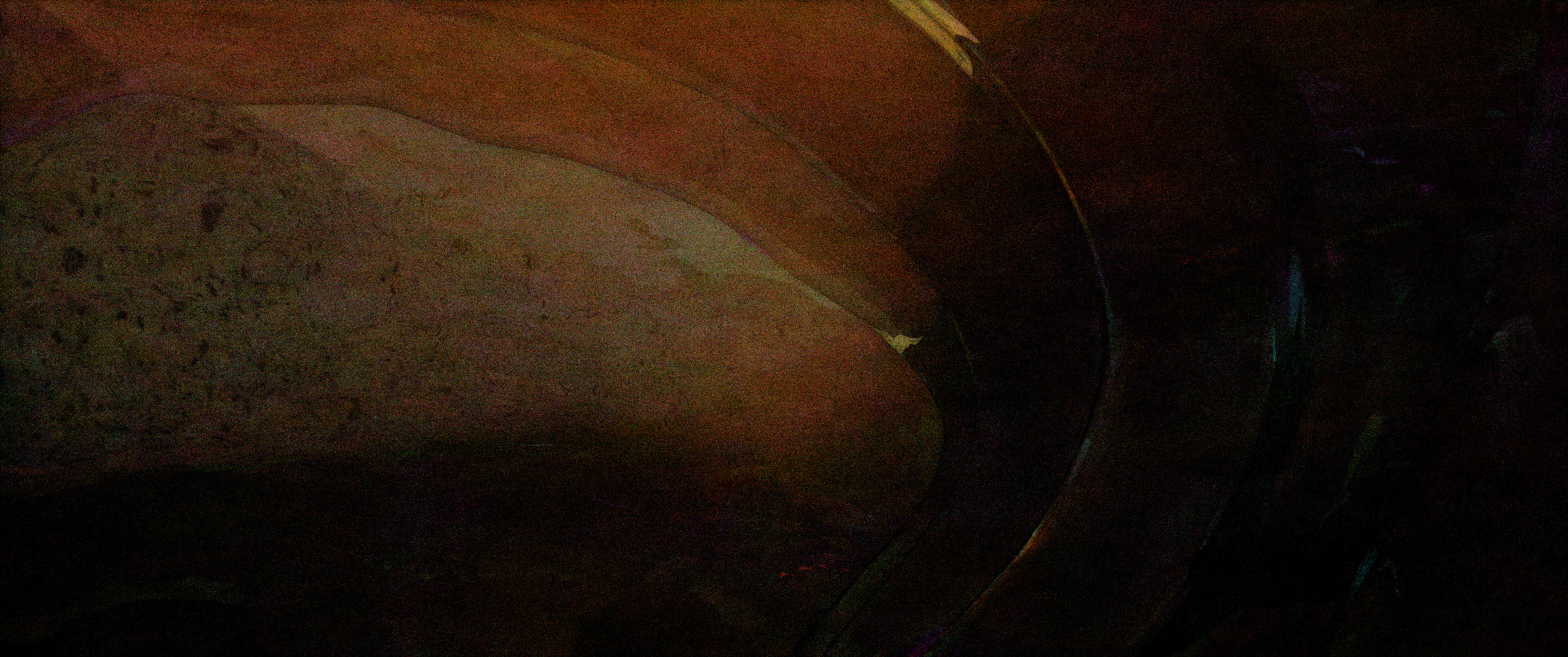

20 minutes, 16 spp.
1:15 hours, 64 spp.
Amazed...
Amazed...

Flange focal distance rectify from 18 mm to 22 mm.
https://es.abcdef.wiki/wiki/Flange_focal_distance
About a correspondent 62 mm focal length.
Crown glas CaF2. Flint glass N-SF10.
https://www.edmundoptics.com/knowledge- ... cal-glass/
Unknown camera...
But correct.
Unknown camera...
But correct.

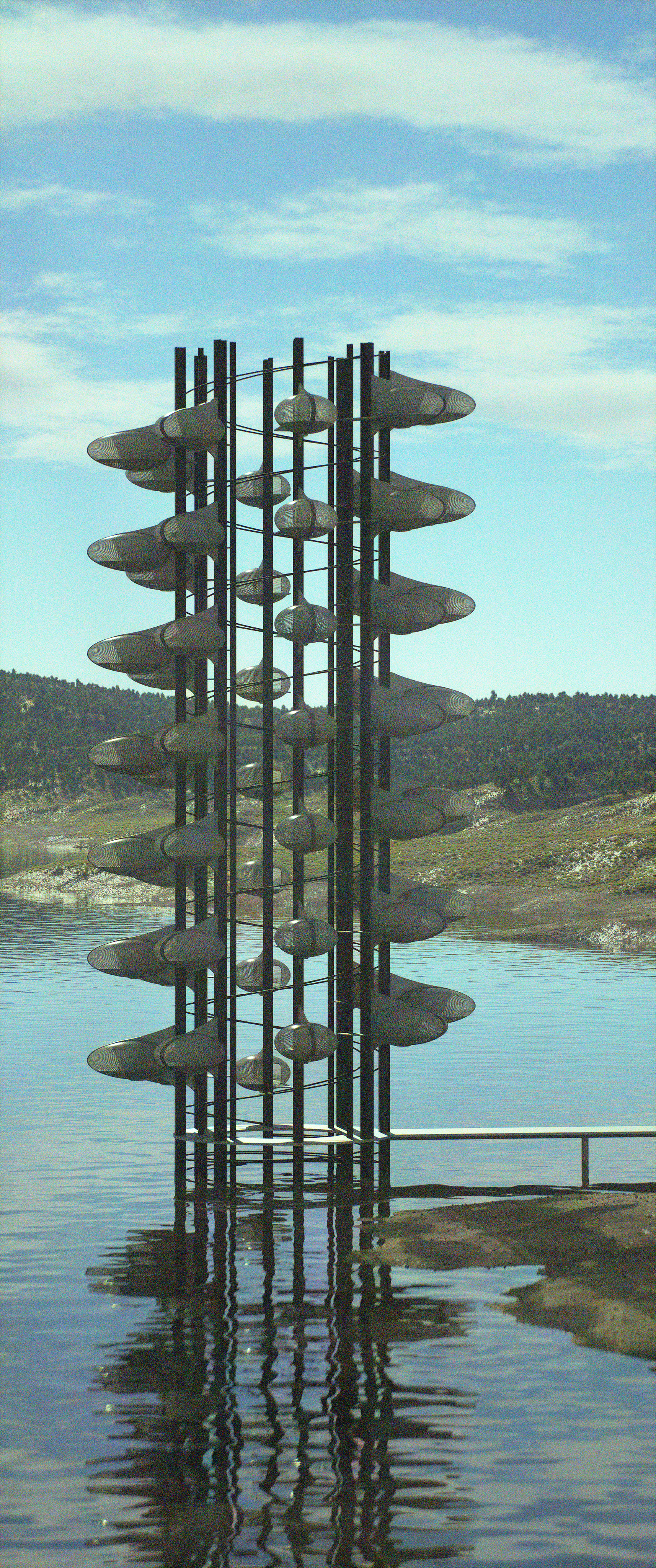

Atmospheric simulation.
Landscape of 10 km x 10 km (partially instanced).
Clouds box of 80 km x 80 km x 1 km (not a problem with mie cumulus).
A decent artistycal-arquitectural proyect.
Synthetic photography, ...
A materialized dream for me!

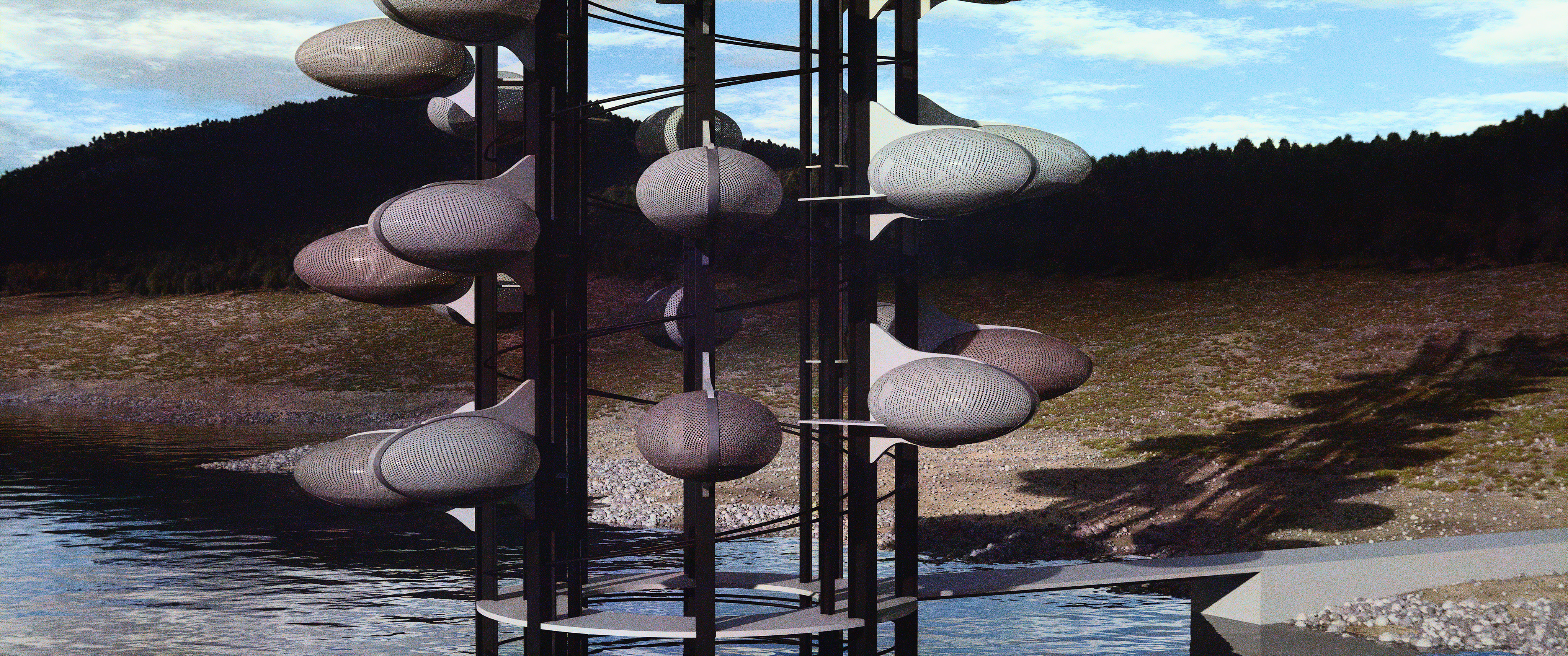

Sigma, 7:20 hours, 410 spp. Is in a perfect point of convergence in a 100% zoom. Canon, 5:00 hours, 230 spp. Focus plane stabilyzed. Will see the point of convergence of this objective.

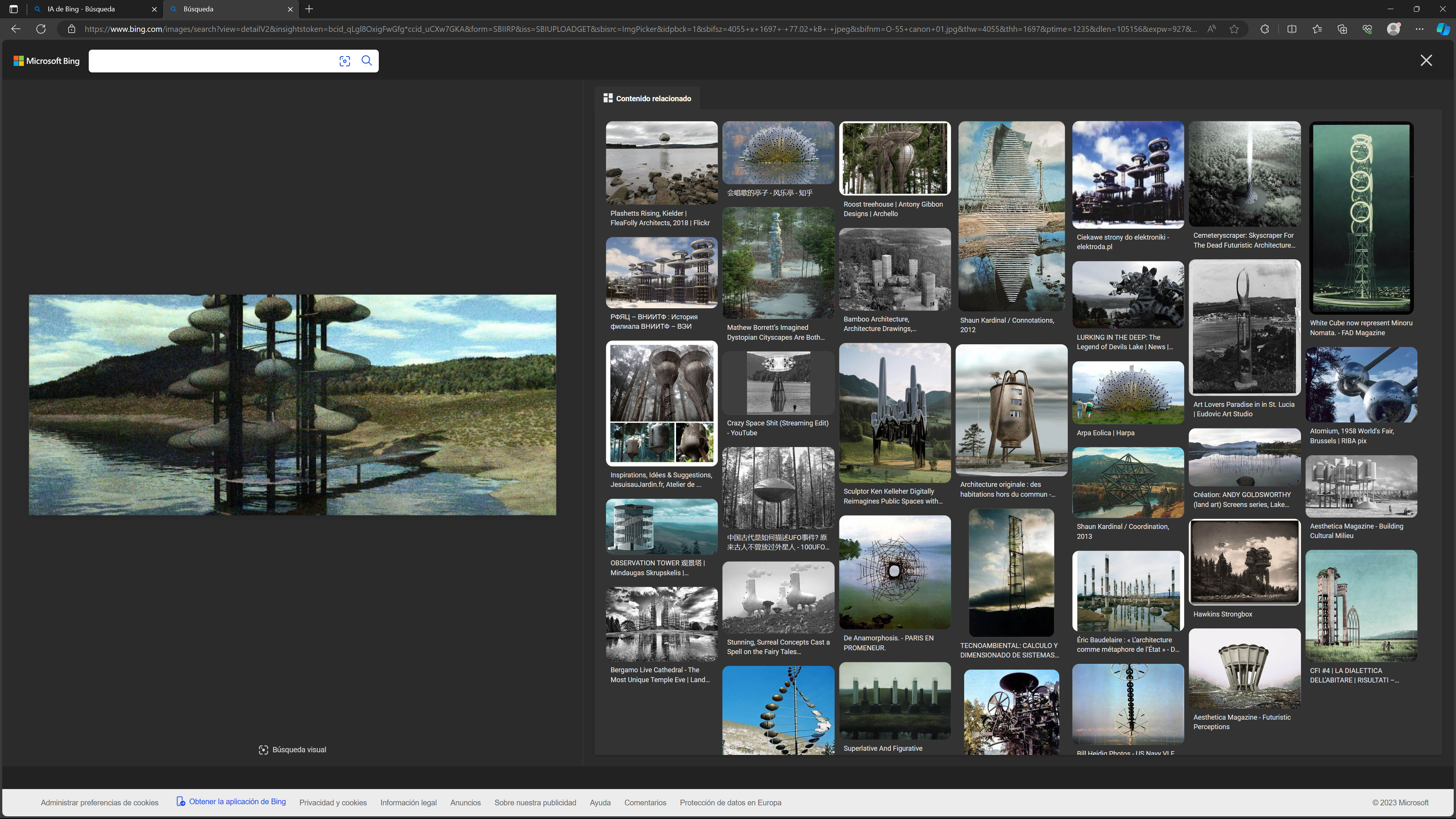

An image search gives sculpture- arquitecture. A bit out of point.

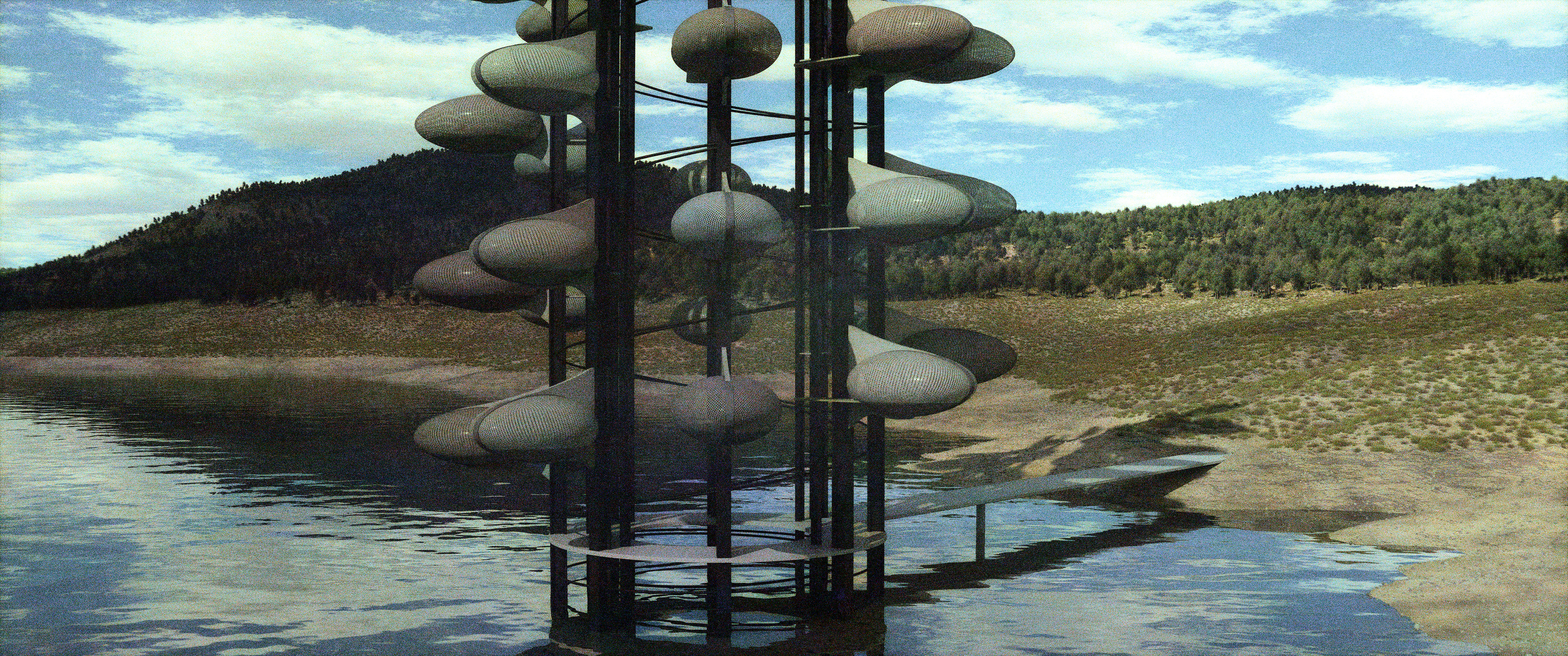

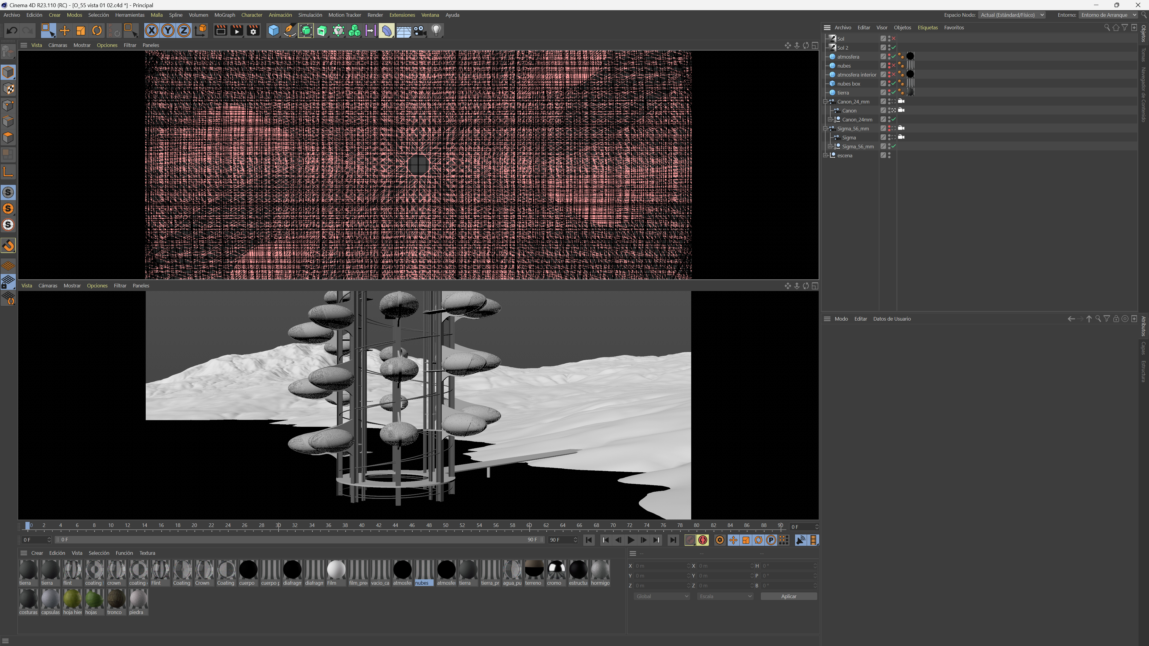

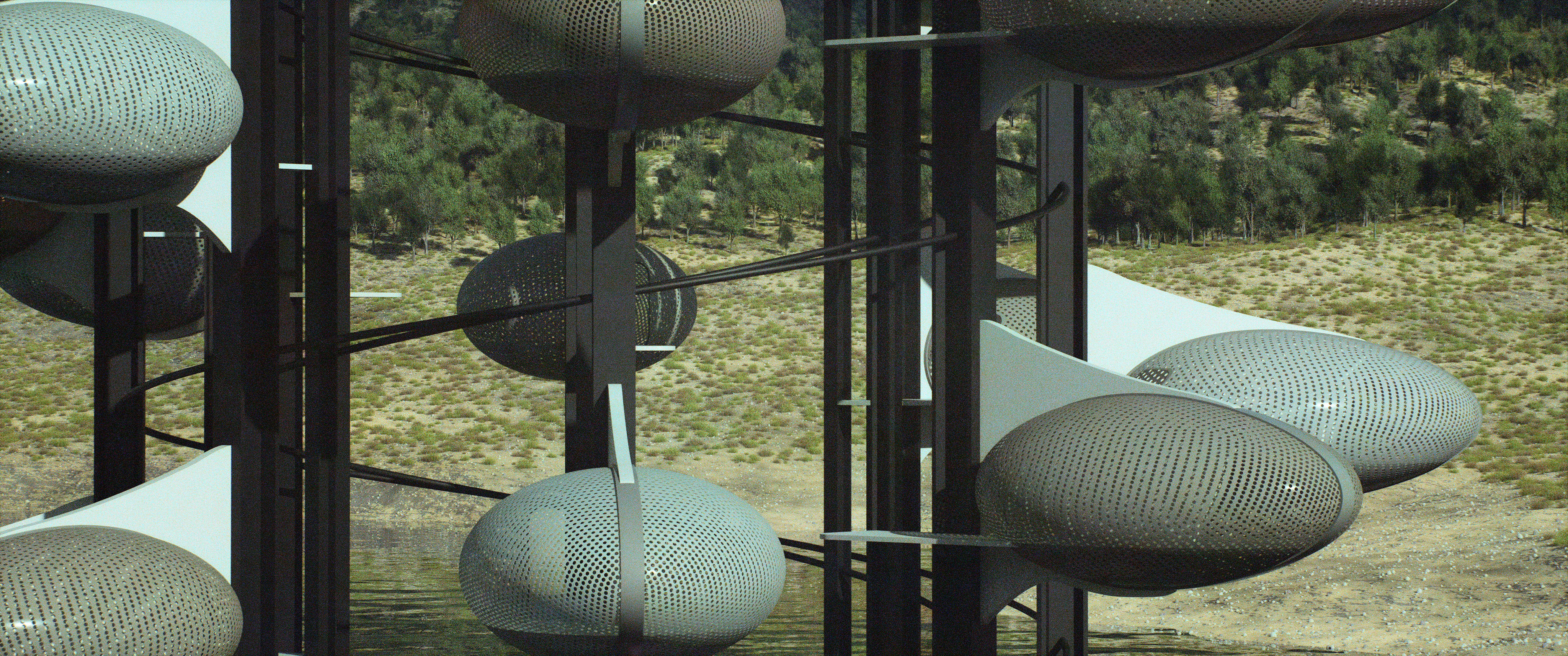

Some progess.
77.7 spp. 32 spp, 8k x 8K, 2 hours. 45 spp, 6K x 6K, 1:30 hours. Finished with analog nik collection in 16 bit. Landscape begins to be something, more variation of ecosystem...

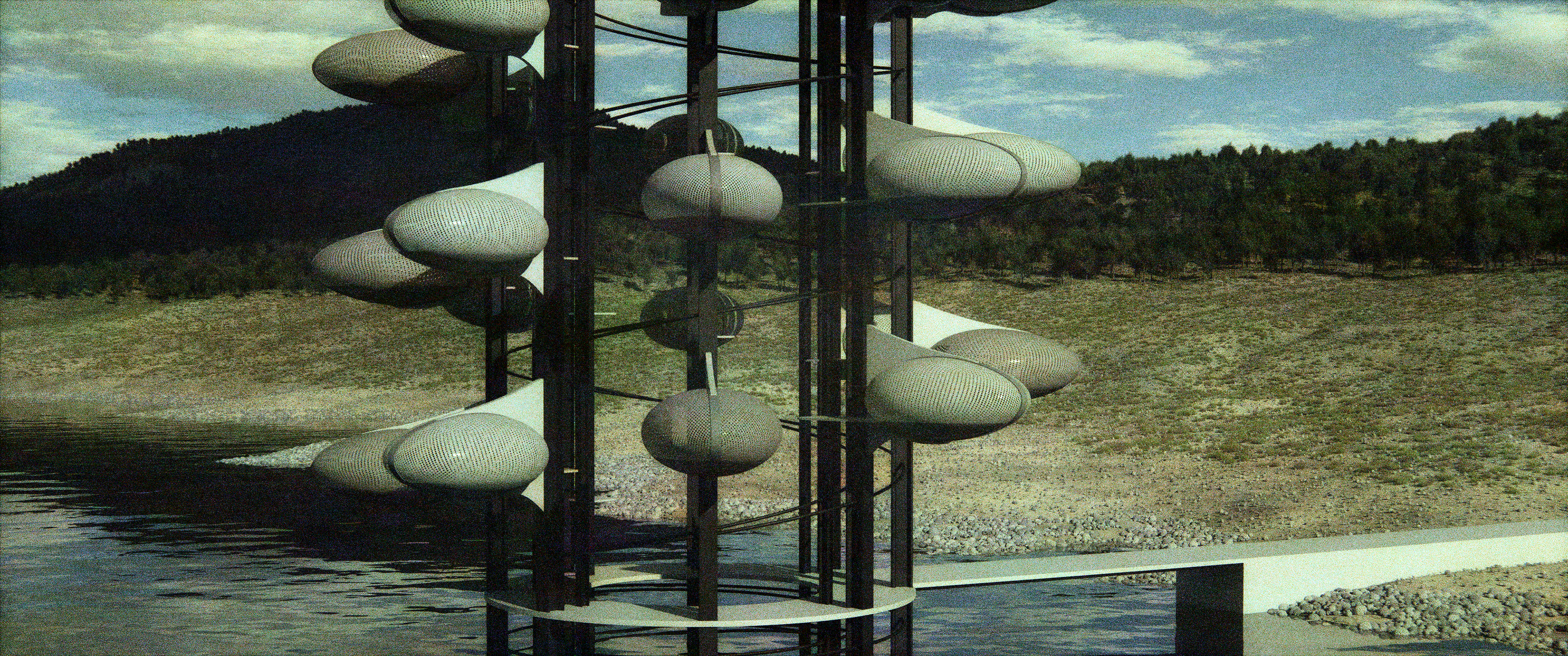

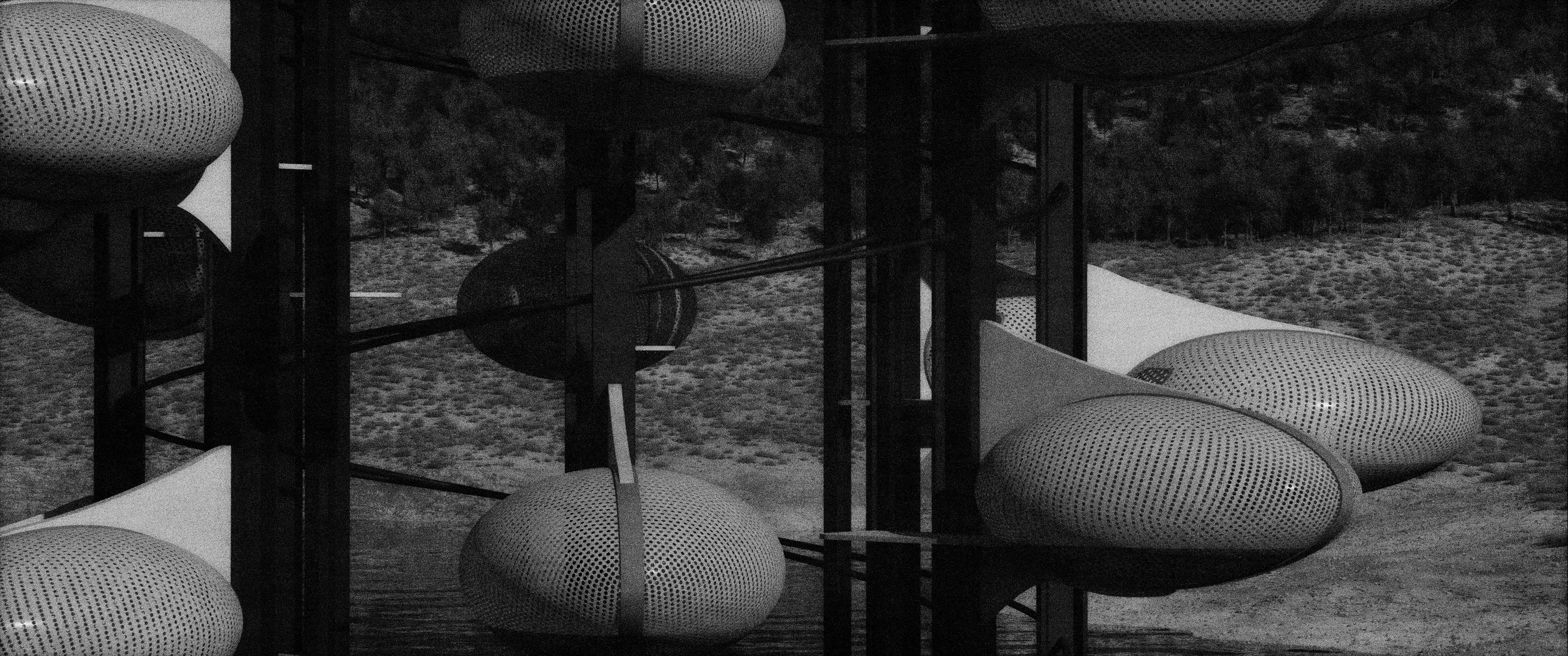

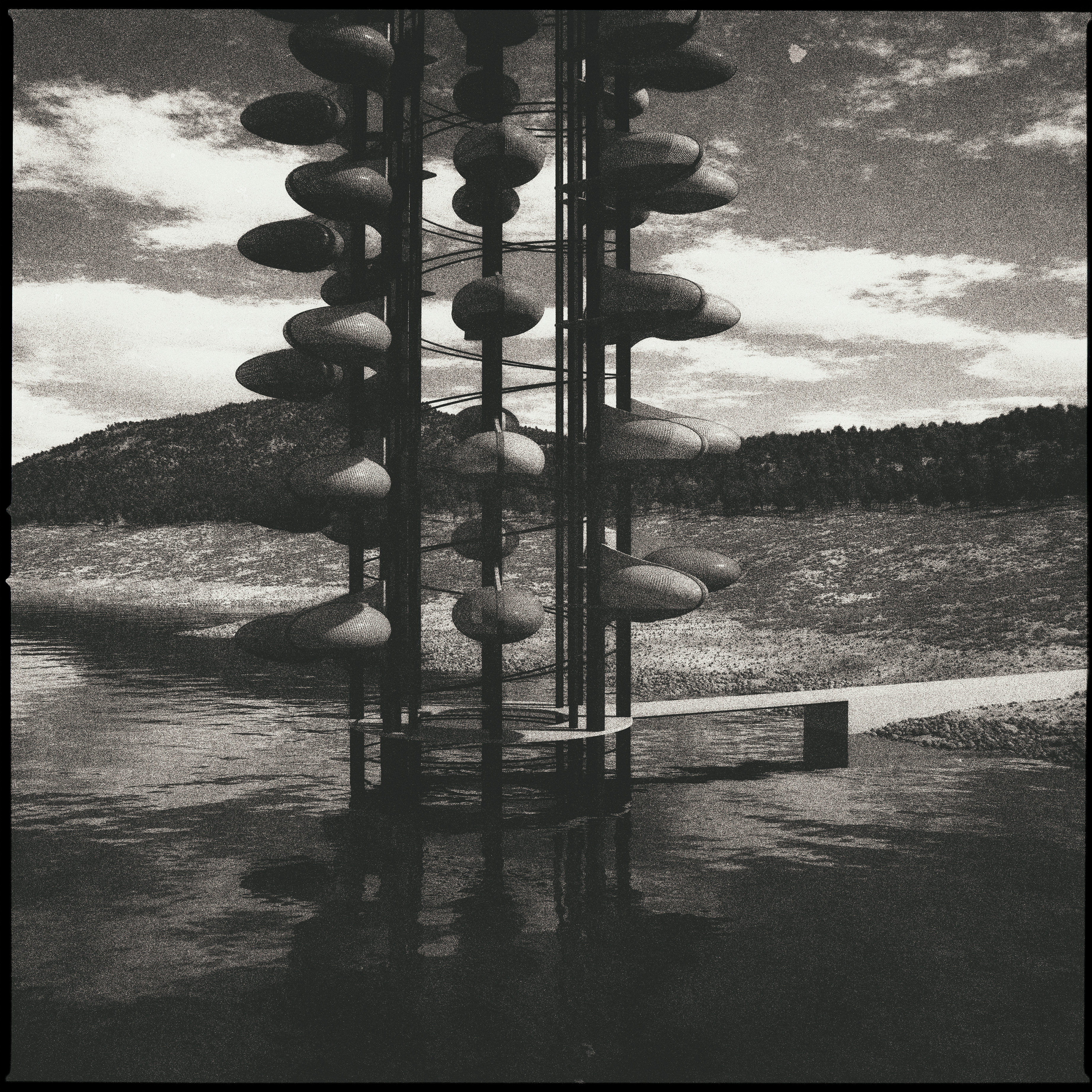

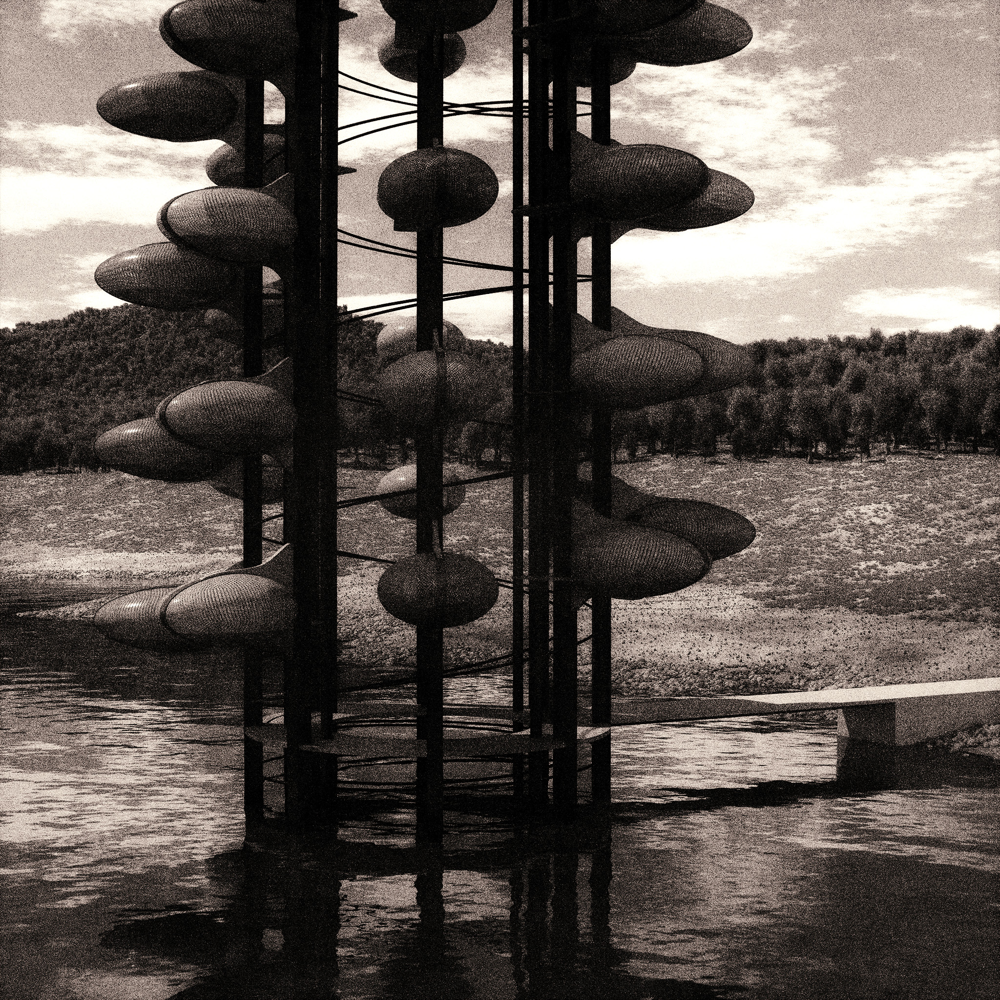

I will finish this part of landscape with a variety of species and give a couple of finished renders (the proyect O-55 is in a half stage, but is OK. To test some materials now).
I prefer the b/w image.
Canon 24 mm mounted in an EF canon.
Flange focal distance 43.5 mm instead of 44 mm (is because the deffect in the thirteen lense).
Crown glass CaF2, flint glass N-BaK1.
14 h, 630 spp, 8K downsized to 4K.
Film APS-C Canon (22.1 mm wide), format panavision.
Film cropped to 17 mm. Testing some things like lighting and materials... minor progesses... 1:30 hours, downsized to 2K.

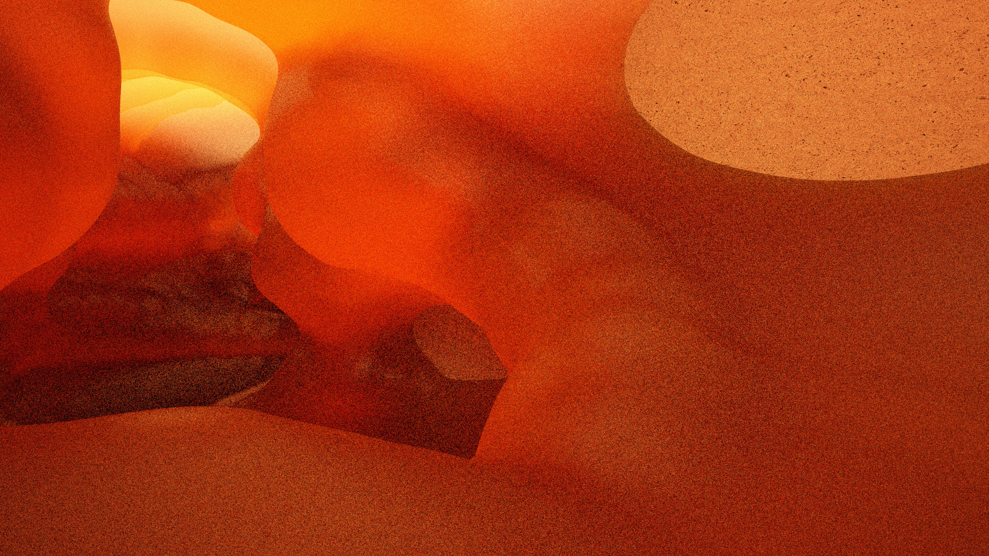

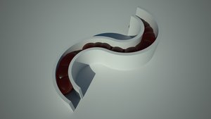

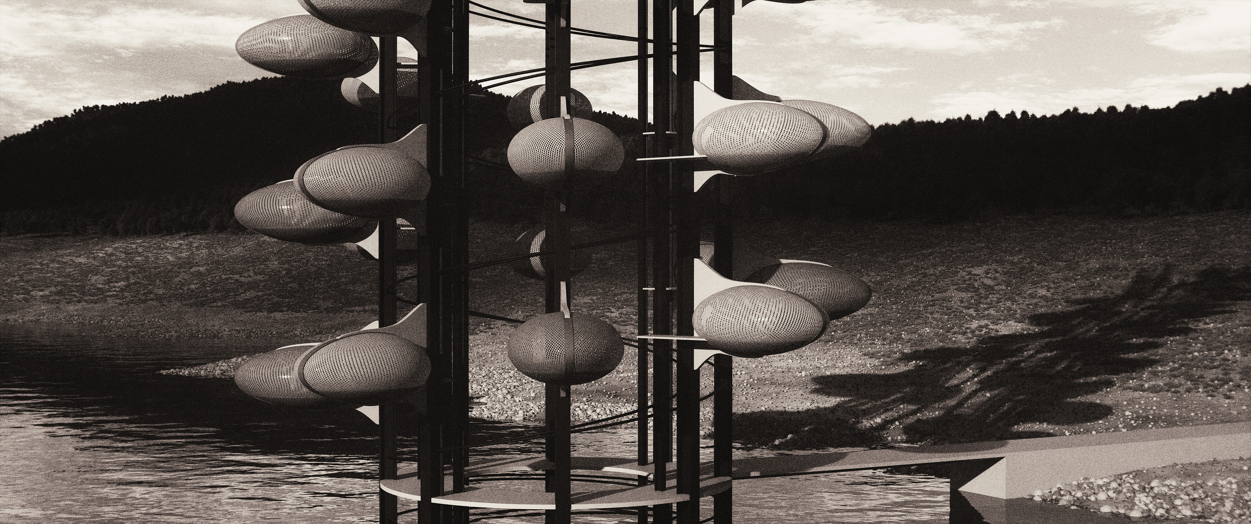

Sketching a new proyect.
The third is a 10 minutes photography.
