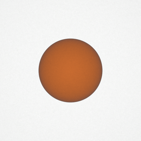

Phong material having a IOR of 1 shows a darkening on the edges, it seems Energy Loss Compensation isn't applied (correctly).
Its maybe not serious, because why using a Phong mat with IOR = 1 and not a Diffuse mat, but maybe this Bug has some deeper roots...
Phont with IOR = 1, Exponent = 1000

Post by Vanessa07 » Wed Jan 16, 2008 12:37 am
I thinck phong material with IOR=1 doesn't exist in reality :roll:

Post by OnoSendai » Wed Jan 16, 2008 12:58 am
Yup, don't set the IOR to 1, it has to be above 1.

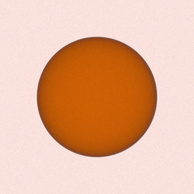

Post by Zom-B » Wed Jan 16, 2008 1:08 am
I'm just testing further and it seems, an IOR of higher than 1 results also in this "Black Outline Issue", the higher the IOR the less its visible! IOR of 1.01 locks same as 1.00!
I Attached an pic with IOR = 1.1, Exponent = 1000
Post by Zom-B » Wed Jan 16, 2008 2:14 am
Hmmm... I rendered the same uniform lightened scene by the same colored diffuse material.
The Diffuse material shows some darkening to the "edges" of the sphere (lol, I hope you understand what I mean).
Shouldn't be an uniform lightened diffuse material in an vacuum be totally uniform colored???
can this be an Reinhard issue...?
diffuse material, uniform lightened.

Post by OnoSendai » Wed Jan 16, 2008 2:27 am
You may be seeing vignetting, use a longer lens.
Post by Zom-B » Wed Jan 16, 2008 9:10 am
OnoSendai wrote:You may be seeing vignetting, use a longer lens.
Yes Ono, you are totally right, Vignetting was the bad boy here...
But returning to the Phong & low IOR problem, I can confirm, that there seems to be an issue with low IOR's like 1.025 in the attached image (Indigo 1.0.5).
