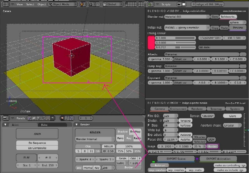

ok in general talk to ono in chat it was mentioned smartden may like an idea for making render region for the official blendigo.
I offer an idea I used making use of blenders border tool - unfortunately I could not see a way to use the shift b rectangle to draw a region for the script to read directly but conversely you can set up the script so that it will draw the border via slider changes to the cameras window realtime for visualising the output - which is all you need really
see pic attach
its not very clear here but I have sliders for left , right , top , bottom position
possibly that works for him too 8)
