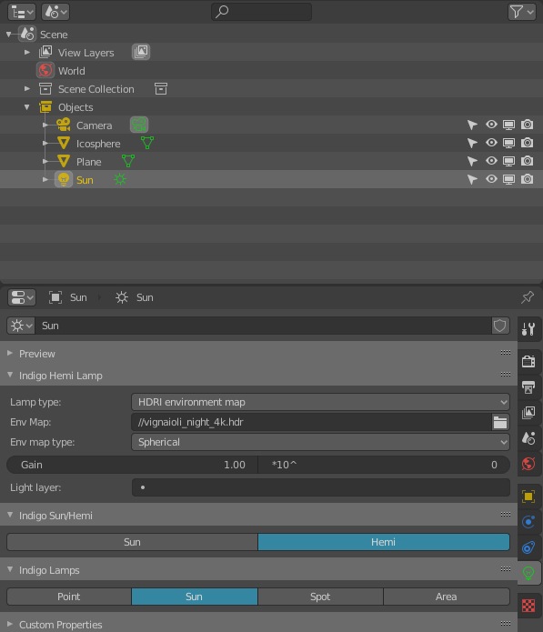

I don't know if this is the correct way to do it, but it gets the job done...
1. Add a Light > Sun
2. set Properties:
> Indigo Hemi Lamp
- Lamp Type: Bacground Color/HDRI environment map
- Env Map: //pathto...
- Env map type: Spherical/Spherical Environment
- Gain
- Light layer
> Indigo Sun/Hemi (select Hemi)
3. Render (f12)

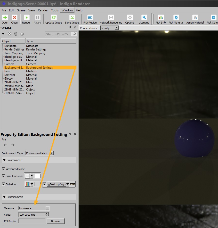

Now, the thing is that every time Indigo Render starts, it shows pitch black. I think that's just because Emission Scale is missing in Blender and gets exported as None. So to get light emitting from the HDRI all you need to do is to set that under Background Settings > Environment > Emission Scale and for Measure choose anything but None.
And that should do it.

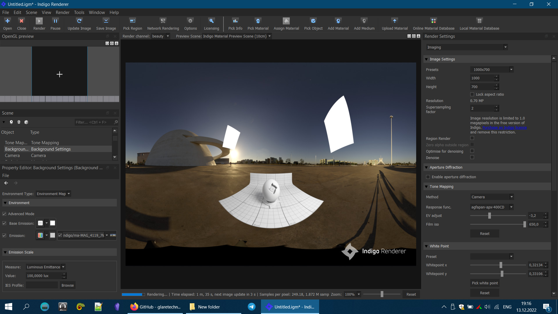

Hi all
Blendigo 4.3.4 [ add Sun > Hemi > HDRI ] + [ add Sun > Sun ] (HDRI+Sun) after exporting scene to Indigo ...
indigo:
Background Settings > Environment > Base Emission > Tabulated
need to make indigo default: (for animation)
Background Settings > Environment > Base Emission > Uniform
trying to write code to file [ C:\Program Files\Indigo Renderer\inifile.xml ] ... didn't help
Base Emission > Tabulated in most HDRIs distorts the color into greenish tints, with the exception of rare HDRIs in which you need to set the white point
x 0,321341
y 0,331065
but most HDRIs render color correctly with Uniform mode and white point E
is it possible somehow to bypass manual editing of indigo over 300 scene frames?
I noticed that if in Blendigo 4.3.4... add Sun > Hemi > Background Color > Uniform after export it works, and for some unknown reason it needs to be replaced in the table after selecting HDRI+Sun combination
indigo:

Re: How do I set an Environment Map in Blendigo 4.3.0
@Zalevskiy how do you do this in Indigo? When I export a scene with an HDRI environment to Indigo 4.6.0 and then pause the render and change the base emission to Tabulated, Indigo crashes immediately!
Could you create a screen recording of the process?
I am looking to see if this can be changed in the exporter code, but cannot make promises. At the moment I cannot get past Indigo crashing
Interestingly, I was now trying to reproduce the greenishness of HDRI Tabulated, and as it turned out, this bug only appears in the standard material scene. After I recorded a video of the Blendigo export process, there is no greenishness.
It probably has to do with the scale of the scene. I accidentally noticed a lot of errors in version 4.6.4 due to two standard Plane light sources. If you turn them off and remove the lux values = everything works relatively 'stable'.
