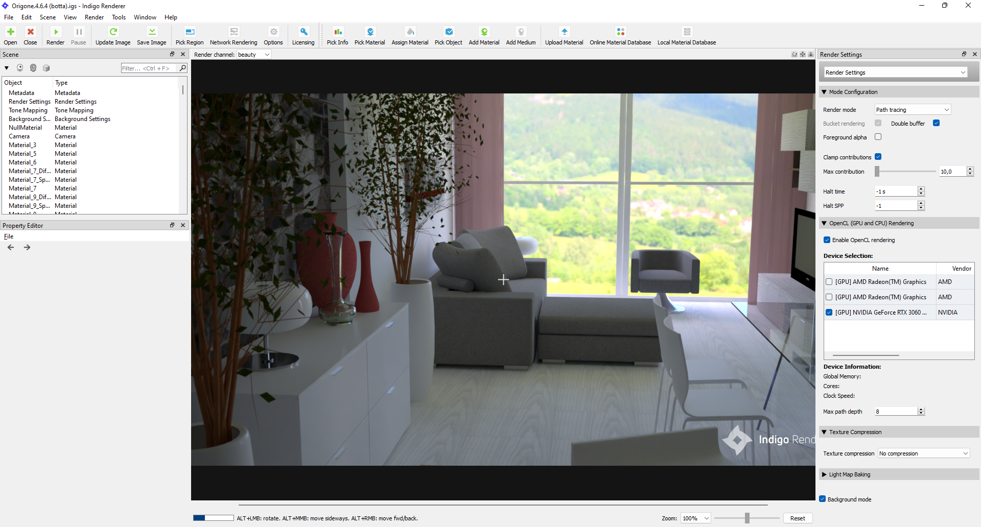

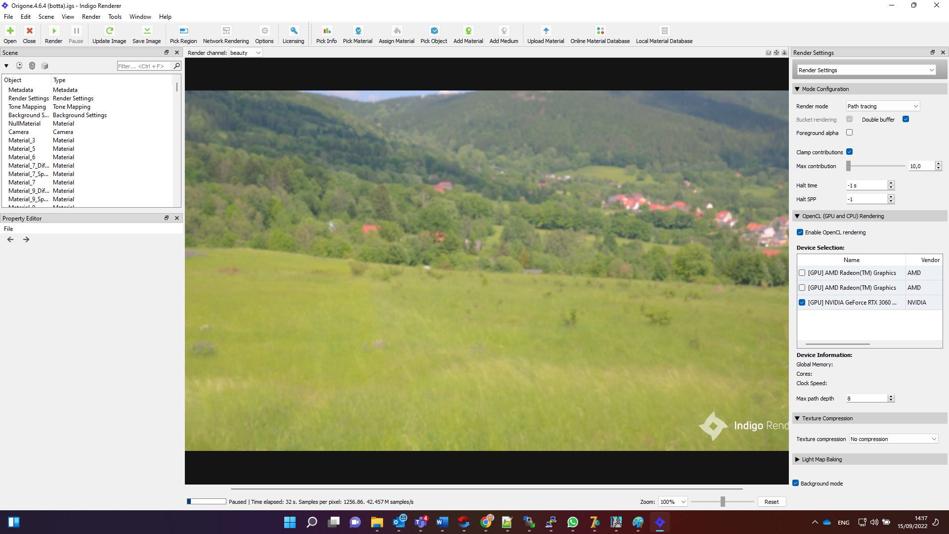

Found BUG in version 4.6.4 (not present in version 4.6.0) only in OpenCL mode
The background overwrites all (see attachments)
Not present in 4.6.4 (BiDir mode) or 4.6.0 (BiDir or OpenCL)
Looking at the number of samples/sec in the two cases, it's as if it doesn't render anything except the background....
A. Delle
A. Delle

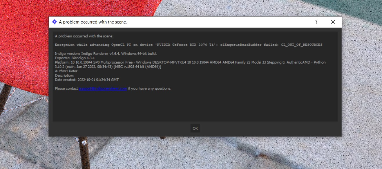

The same Project (Indigo 4.6.4) sometimes causes "Out of resource" error on my videocard (NVIDIA GeForce RTX 3060 Laptop GPU).
Error: Exception while advancing OpenCL PT on device 'NVIDIA GeForce RTX 3060 Laptop GPU': clEnqueueReadBuffer failed: CL_OUT_OF_RESOURCES
Indigo 4.6.0 renders correctly
( you can download the IGS project from here >>> https://we.tl/t-h9dPVcsJ3C )

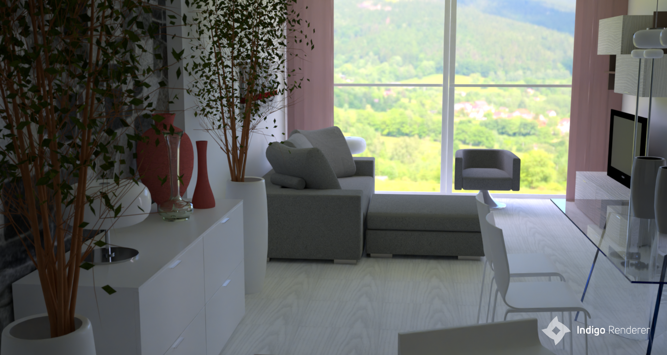

Not sure its the exporter or Indigo, but something seems horribly broken when GPU rendering on my system:
Another older scene renders fine, yet another one after the first "flash" of an image, it only renders the environment HDRI.
Re: Indigo Renderer 4.6.4 Release
Thanks for this update, I'm glad Indigo is alive. Please keep that way, subscription based if needed.
Yeah have found + fixed this bug, will make new build soon.Headroom wrote: ↑Sat Oct 01, 2022 1:28 pmNot sure its the exporter or Indigo, but something seems horribly broken when GPU rendering on my system:

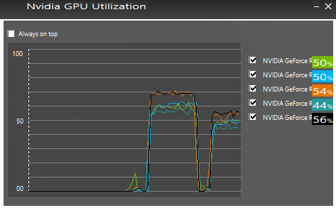

hi, very strange behaviour: the same scene, the same rig (5x 2070/2060s) but:
- cindigo 4.4.13 - 660 samples / sec
- indigo standalone 4.6.4 (and 4.6.0 too) - 550 samples / sec (exported from cinema 4d thru cindigo 4.4.13)
nvidia driver 517.48
gpu utilization of cindigo (left) and standalone (right), the same scene:
p.s. but it has the same samples/sec with single primary GPU - cindigo and standalone (2 gpus or more - different)
