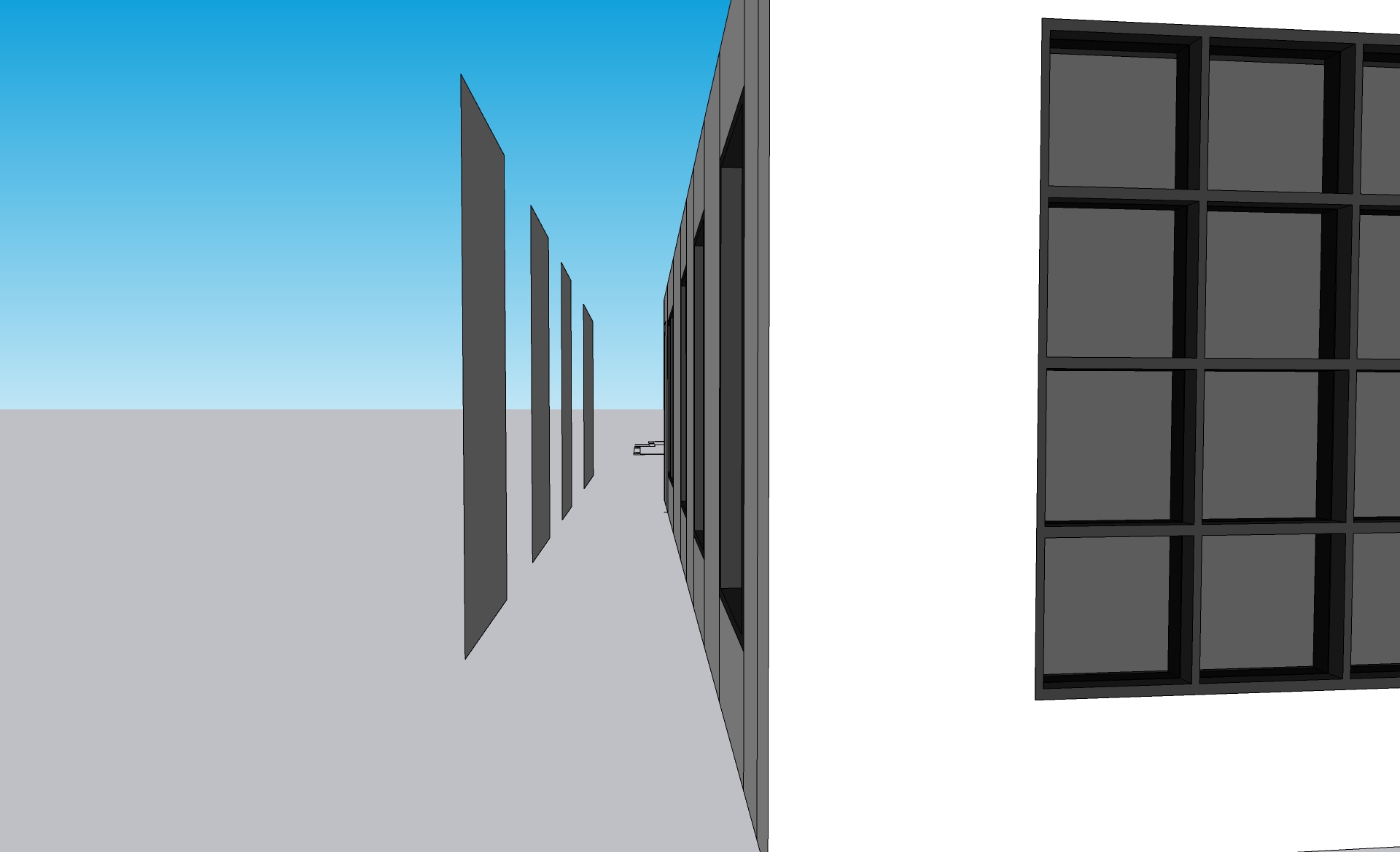

Alamy
Posts: 107
Re: Pavoda Rendering Thread
Post by Alamy » Tue Aug 02, 2022 9:25 am
pavoda wrote:
Tue Aug 02, 2022 5:36 am
use material type "null material" it is transparent.
I put the rectangles outside the windows and a little bit away from it to which I applied the null material, Is this the correct way?
pavoda
Posts: 188
Post by pavoda » Tue Aug 02, 2022 7:31 pm
I m putting lights indoor close to glass. But you can try this...I think effiency is bit lower
