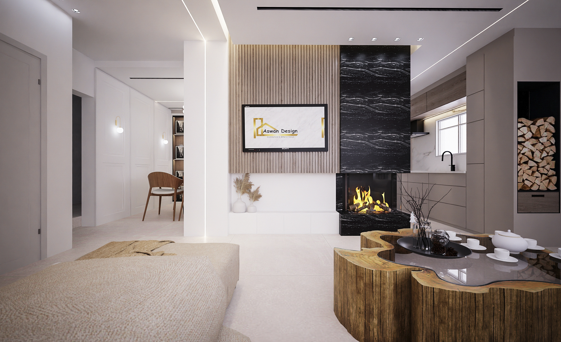

Post by Alamy » Sat Jul 30, 2022 12:16 pm
Finally, I managed to achieve a good Aperture diffraction in my latest work :) :)

Actually, It's a little bit tricky, after many trials I feel that I understand how this little boy works, in tonemapping I choose a camera option, under the camera, I use agfapan apx-100CD, and under the camera tab there is an option called advanced aperture and glare, just keep it unchecked as you will activate after you finish your render and before hitting the denoise button, in aperture shape in SketchUp keep the circular shape as you will change this option later after you finish your render, when the render is finished the first step is to go to your camera setting then change the circular to generated, num of blades in this scenario was 4 but I will post another test with 6 blades and I think hexagon looks more realistic, in blade offset I use 0.3 as I tried less than this number and all trials were a blurry image, curvature radius I use 5 but you can try going down to 1 and see what you like as per your taste, in the angle section I use 45 which is 0.785 in the indigo tab, you can type 45 degrees in the in skindigo but in indigo renderer I couldn't put by degrees, then I understand that 45 equal to 0.785 approximately after that under aperture diffraction you need to enable aperture diffraction and last thing you need to hit denoise and wait little bit to see clear image as with diffraction the denoising time is more, I'm using GPU here, You are right it's too cold as I'm using the D50 in white balance, the client need specific tone in the wood which I couldn't achieve in the warm mood.

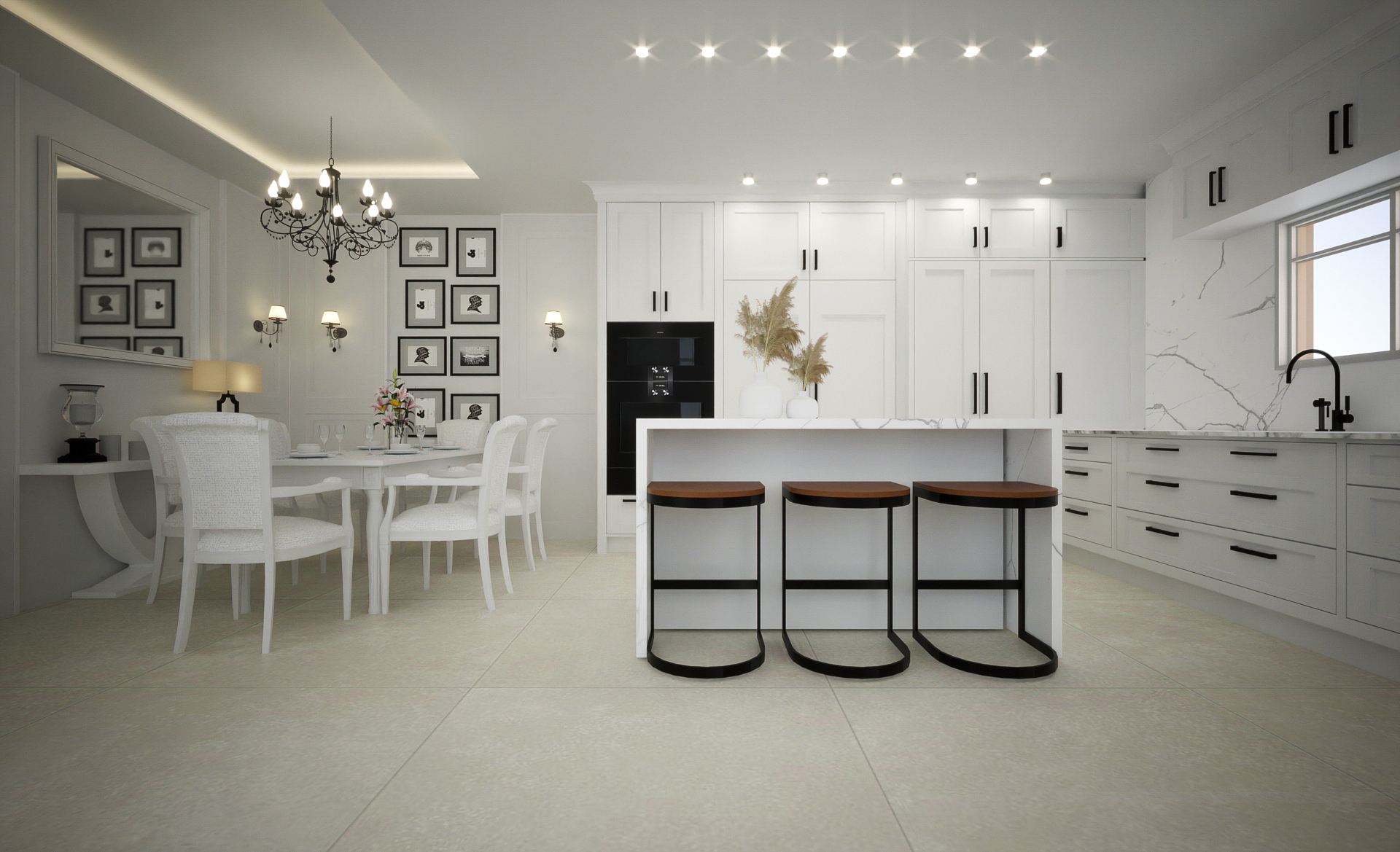

Another shot but with 6 blades this time

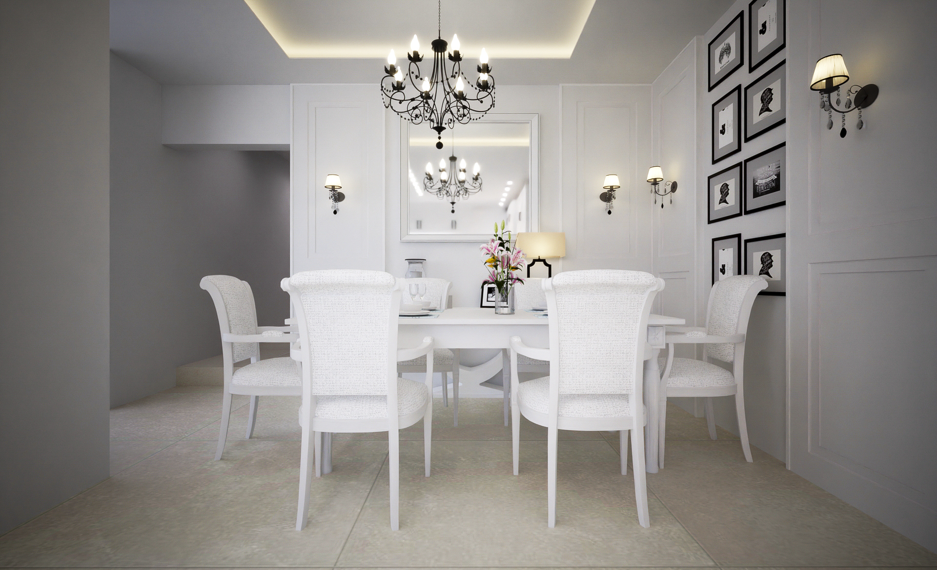

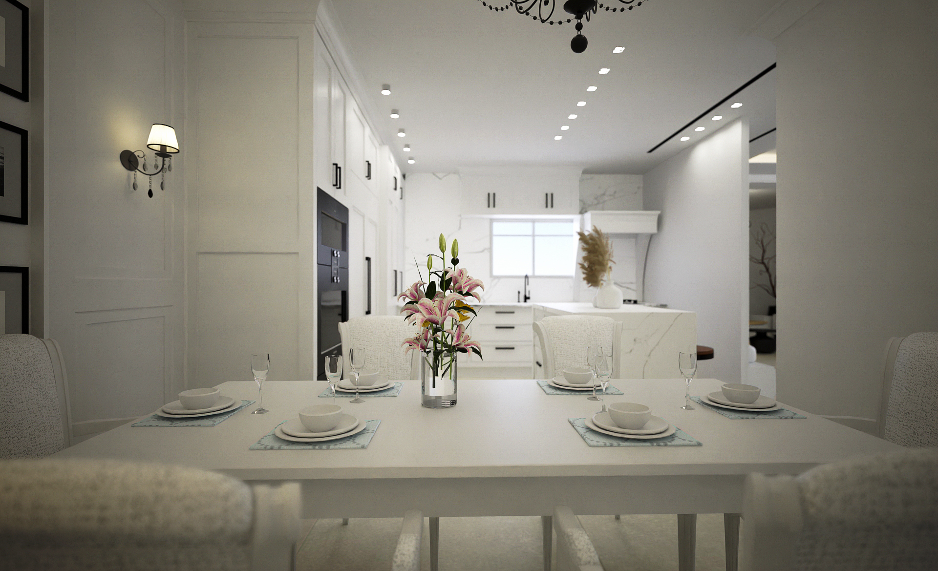

Post by Alamy » Sun Jul 31, 2022 11:21 am
And these are other shots from the same project

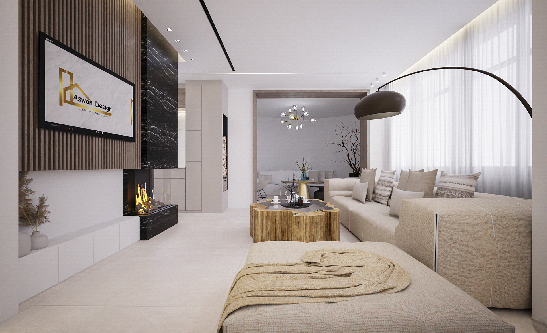

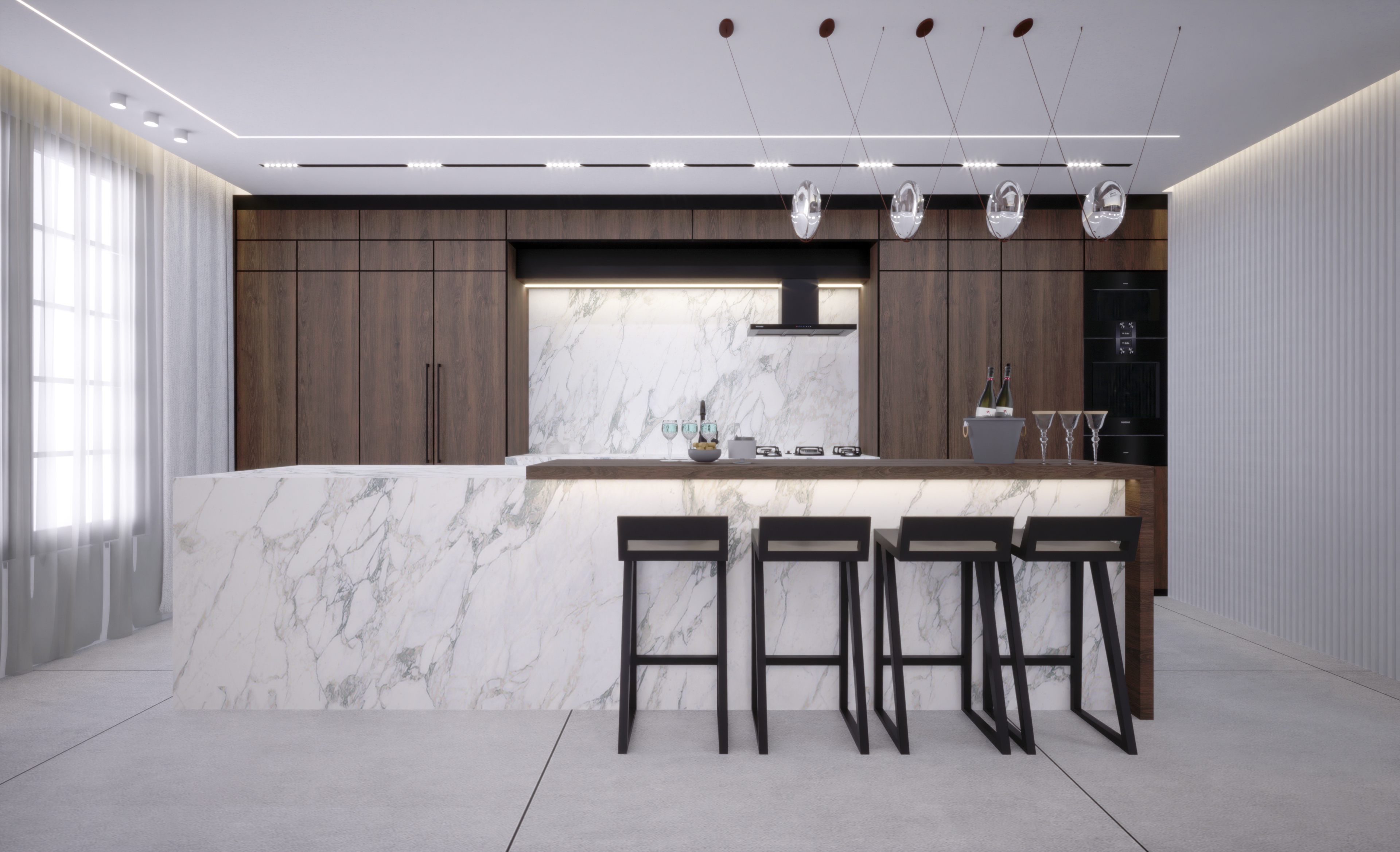

Post by Alamy » Fri Aug 05, 2022 9:57 am
New Interior ... Comments are welcome
