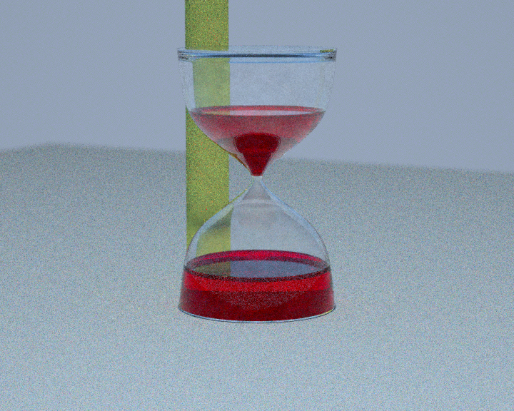

Yay!
You solved it, Dave!!
Thanks a bunch, and Merry Christmas to you too.
I'm just going to let it render overnight... Here is the beginning of the render...
Ari ;o)
Ari ;o)
- Attachments
- At (long) last!
- RenderOK.png (985.7 KiB) Viewed 4222 times
Even if it's solved: I think, there are still confusions.
First of all, Yes, you checked bth MTL and Hybrid. PT is, when you uncheck both
As soon as Hybrid is selected, MTL gets ignored, though. So you don't use MTL but Hybrid.
And regarding the precedence: You should never set precedence to 1, as Indigo's Air holds that number.
But your hourglass isn't a solid glass thing, but has thin glass walls. That means, you should set it's precedence to a higher value than the liquid has.
The liquid only needs higher precedence, if the glass is a big solid block, which entirely would remove the liquid. That was required, once, with a very extreme example of usability of precedence: A Galilean Thermometer.
Last thing: There's still a bug remaining in your mesh: you should add an edgesplit modifier, so that the normal smoothing errors get fixed
ReinaDelSur
- Posts: 16
- Joined: Mon Dec 24, 2007 6:37 pm
Hey Kram,
I'm not sure I understand what I have to do with the precedence setting. In the render you see, precedence was set at 2 for glass and 100 for the liquid. What I think I understood is that I shouldn't distance the liquid's precedence from the glass's so much. So I've launched another with precedence for glass remaining 2, and precedence for the liquid being 3.
As to PT, Metropolis, Hybrid and the like, what do you think would be best for what I'm rendering? I've read somewhere (most likely in a tut or in the manual) that eventually they all converge toward the same "perfect" render, so does it really matter? Could you maybe point me to some place where they quickly go over the different options and their results? (or tell me quickly about it?)
I've added a couple of EdgeSplit modifiers, after marking some edges as Sharp. I didn't even know those existed, so thanks for the heads-up.
Still, something seems strangely off in that picture. The lighting, I guess, definitely, but I also think there's a problem with both meniscuses (if that word ever had a plural...) They're way too big compared to the hourglass itself, so they just show too much against the glass body.
Anything else that you think I'd have to fix?
Thanks for your help.
Ari ;o)
P.S.: Here's the second version rendering, with difference precedences and edge correction.
Ari ;o)
- Attachments
- Version 2
- Hourglass + liquid V2 rendering.png (840.68 KiB) Viewed 4175 times
Regarding the precedence system. You have it back to front. It has nothing to do with how far one precedence is from the other. It's whichever is higher gets rendered. In your case, where the glass and the liquid cross over, the glass should have higher precedence so that it gets rendered. So you should set the liquid to less than the glass. Air has a precedence of 1. Everything else should be higher than air. So, set your liquid to 2, and your glass to 3. That should also sort out the meniscus problem.
regarding PT MTL or Hybrid: Everyone has his own philosophy, in that case...
You have an outdoor situation. Many would choose PT...
You have a complex Light situation with the glass and the liquid.. Here, Many would choose MTL...
Hybrid is a bit different... It is supposed to combine NTL and PT in their advantages. But it seems to be slower...
I dunno. Many choose it, not matter which sort of scene...
You need to test it for your own.
For now, use it, as is. When ever you like, you can test it
