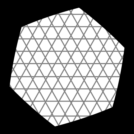

Nice work, Ono! I was a bit confused about obstacle maps at first. Maybe you could post the obstacle map that you used to produce the second glare pattern. 'diffraction_test.igs' does not produce the same glare pattern that you have shown in your first post. I suppose this is due to the lack of obstacle map.
Post by OnoSendai » Tue Dec 04, 2007 4:04 am
Well this is the combination of aperture + obstacle.
It's the regular nature of the obstacle grid that gives the distinctive glare pattern.
