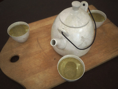

this thread has been dorment for a while now, thought id just spike it up again with a request, does anyone have any settings for porcelain. making a porcelain tea set.
thanks
mat
drBouvierLeduc
Posts: 412
Location: france

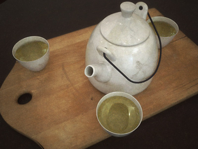

Post by drBouvierLeduc » Sun Aug 05, 2007 3:14 am
something like this maybe ?
phong material
exponent 60000
ior 1.8
phong material
exponent 60000
ior 1.8
matsta
Posts: 730
Location: 127.0.0.1
Post by matsta » Sun Aug 05, 2007 3:32 am
hmm very nice... its weird i think the look im going for is more along the lines of bone china but that mat is very nice. thanks alot drBouvier.

Post by CoolColJ » Sun Aug 05, 2007 2:47 pm
exponent 60000...? Here I was thinking 10000 was the limit ... ! :shock: :lol:
