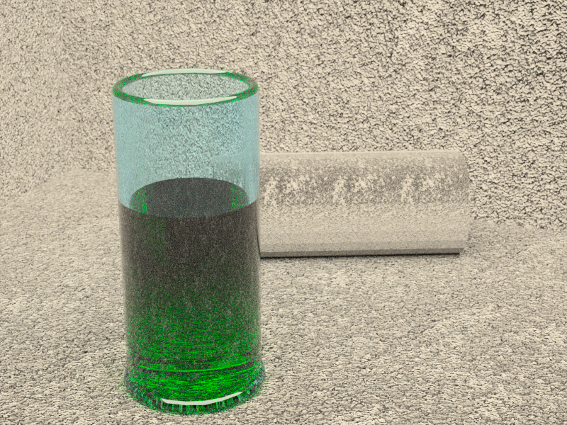

Just did this test, and I think I found the issue with the black artifacts.
In sketchup, when you apply a translucent material, it is a single plane, and that is what I have been doing. but as a test, I made this glass, double sided, and much much better results.
this is one hour of rendering. :D
Post by Kram1032 » Thu Apr 05, 2007 7:47 am
Somewhat funny:
Noone expects, that physical correctness needs 3Dmaterials...
I my self used doublesided stuff from beginning ;)
singlesided stuff wont work...
as you found out yourself ;)
