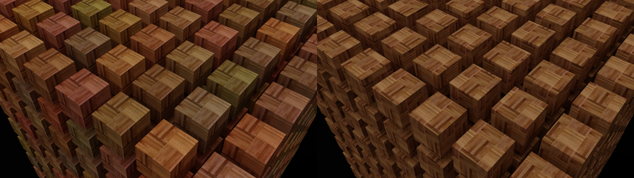

Thanks. that's quite a neat shader, although not exactly what I had in mind.
In the left that's your shader, on the right what I was aiming at... each has it's uv position randomly changed, which could be quite nice with stairs for example.
