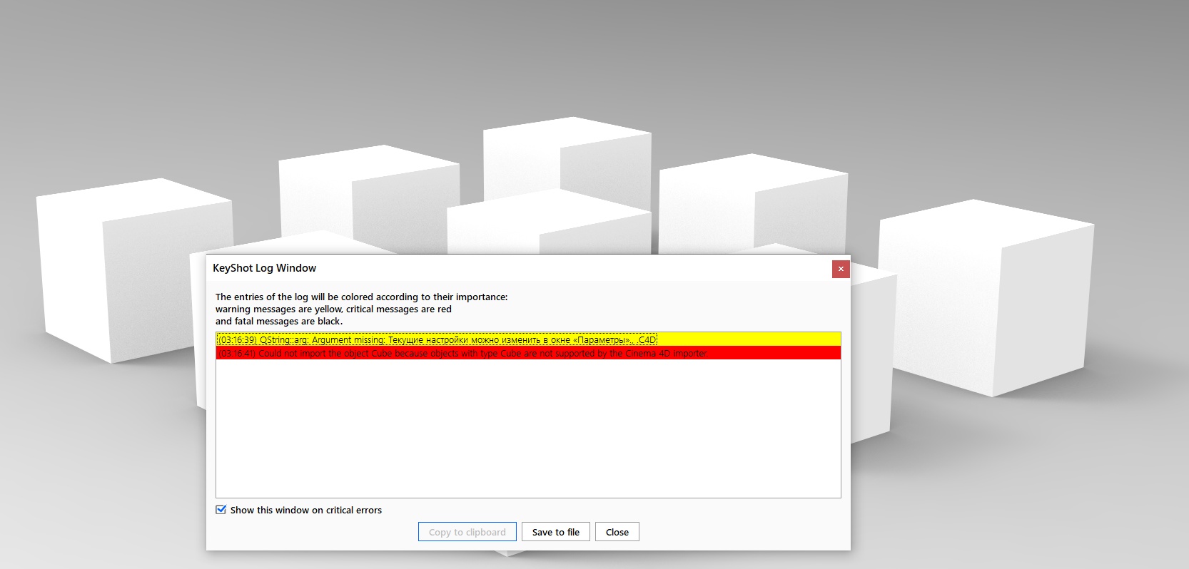

you will get much more fun if you'll just try to render c4d's cloner instances, deformers, matrix objects or bones-animated objects with keyshot (9.3.14)...
p.s. keyshot is an alpha (no even beta) state app now that guys sell like something real working.
c4d:
ksht:
very nice app!
ahh... and c4d scene has no plane under that cubes for that pretty keyshot's shadows on it;) very fun.
