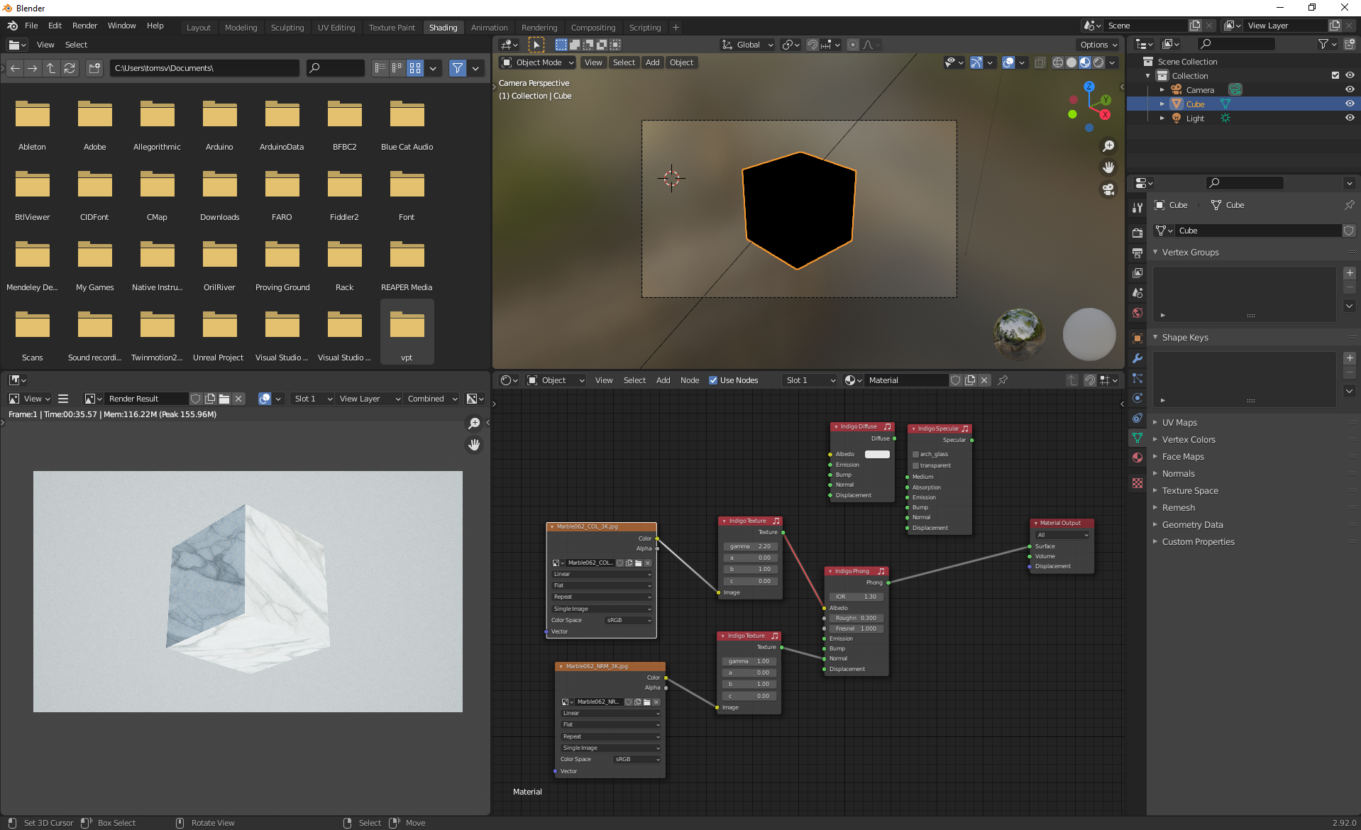

Hi @MZ and @fused,
A while back I played around with integrating the Indigo SDK with Blender through Ctypes with some pretty neat results. I know that the licensing issues prevent that from being an official add-on - which is a shame, because that would be the way to get a very tight integration into viewports, etc. - but one thing that might be useful from it is a way to compose materials in the node editor. I notice that in Blender 2.9x the focus is almost completely on using nodes for materials, so even the texture panel is not used anymore, which makes it a bit counterintuitive to apply textures and such.
If it sounds useful, I can upload the code for the node-based system? It basically lets you use the shader node system for making Indigo materials and export them, so maybe a good addition to the current Blendigo...
- Posts: 1828
Re: Blendigo 4.3.0 - Blender 2.8
This is what the nodes look like currently. The nice thing is that you could have Indigo nodes side-by-side with normal Blender / Cycles nodes, to make it easier to switch back and forth, or share image textures.
