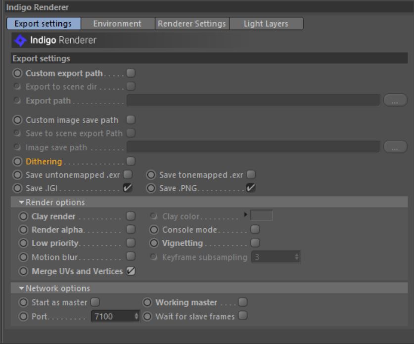

I try to create an animation - just a camera through the interior.
I am surprised that C4D exports the whole scene for each frame again and again.. also each shader bakes into the texture repeatedly. It takes a lot of time and hundreds/thousands copies of same data are made unnecessarily.
How can I optimize this process?

Enable "Skip writing existing meshes".

thanks, sorry but where can i find it?
It's under export settings ( at least in Blender :? ).

Post by pavoda » Mon Sep 10, 2018 6:57 am
looks like it is not in C4D :(

the C4D exporter does check if a object is used in the whole animation without relevant changes and then exports it only once and does reference to this one mesh through the whole animation.
I bet the baking of shaders is what takes the most time for your export!

I tested it on a large scene without materials. One frame lasted about 10 sec, 50 frames 30 sec. It's really what you say. Thanks
I watch the shaders.
