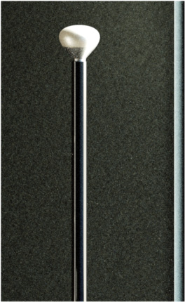

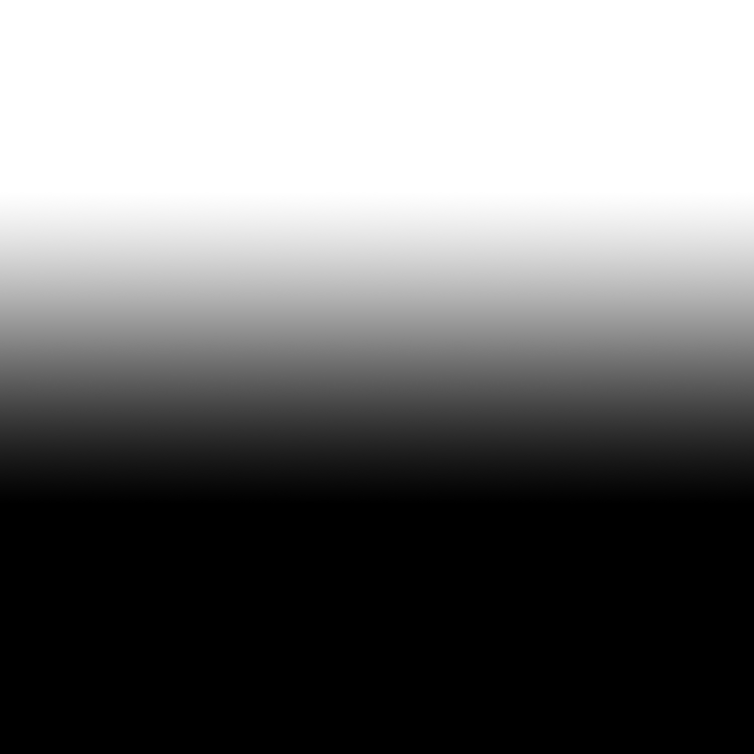

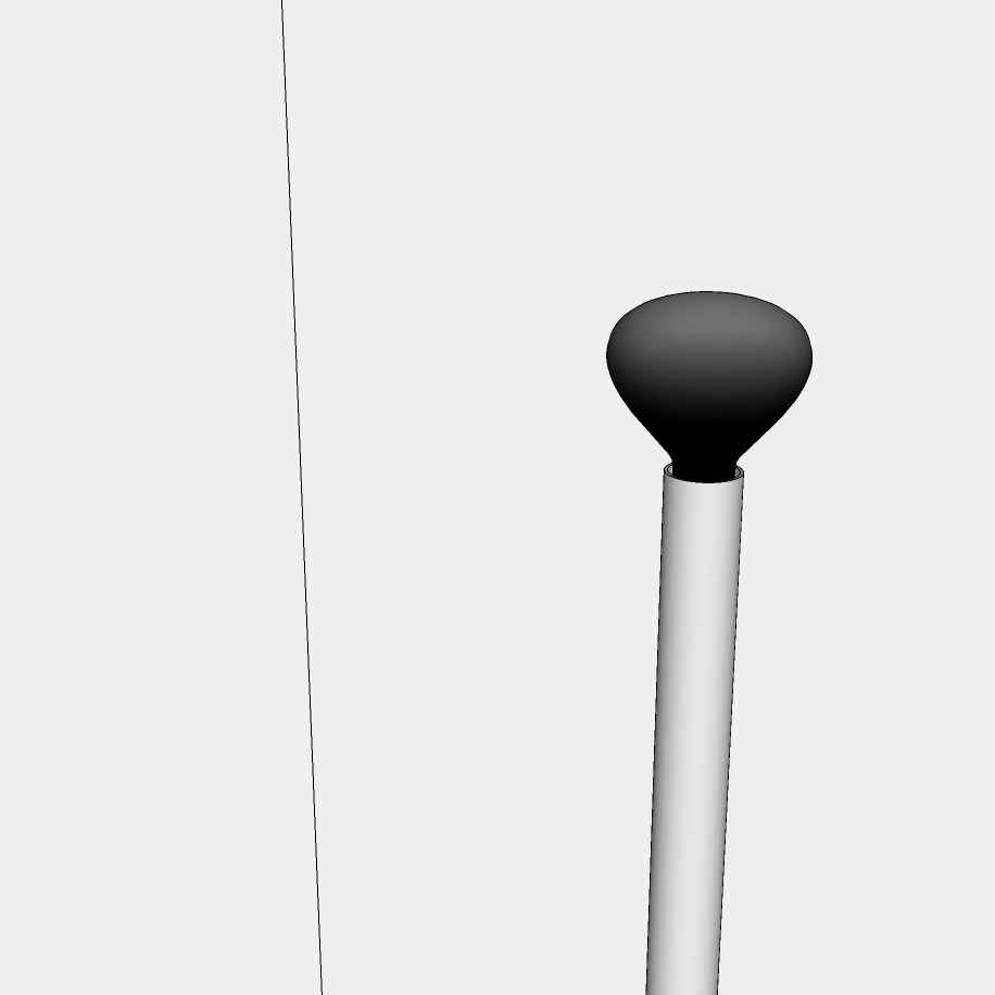

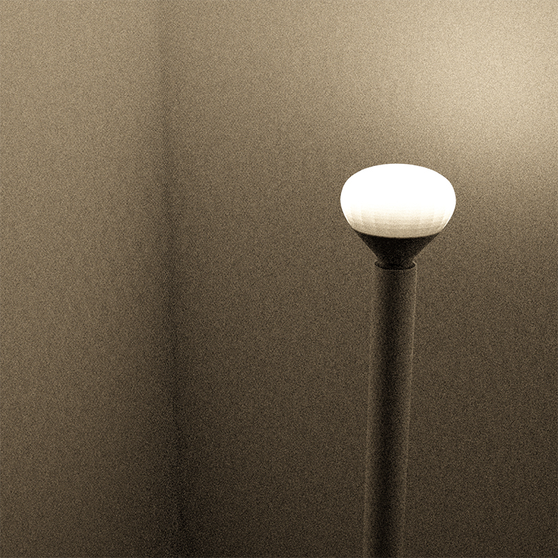

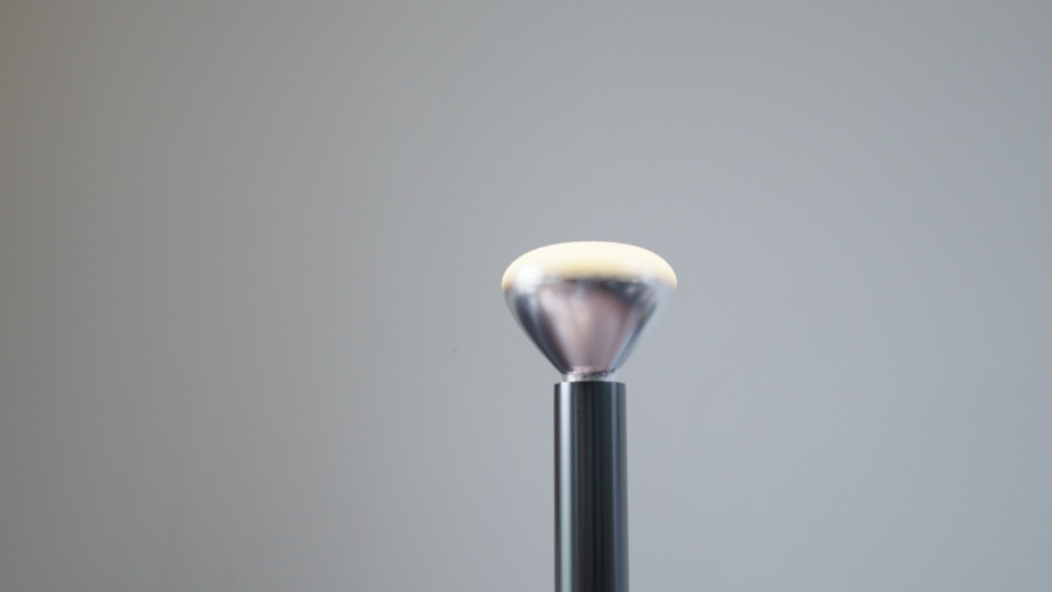

Today I'm here asking a question about materials: I'm trying to reproduce the attached material, which is often used in Foscarini Lamps such as the "Parentesi" and the "Luminator", both by Castiglioni.

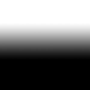

I set up a blend mat with the attached map. The black part takes a simple metallic material; the white part is linked to an emissive material.
BTW, when I try to render, the result is somewhat uncontrollable, and waaay distant from the result I'd like!
Can you help me out?
Thanks a lot!!
Thanks a lot!!

Seems to work fine here, I did it exactly the way you described it with your map. Maybe your emission is way to strong? Also, make sure that the gradient only happens around the middle of the bulb, and that the bottom has 100% black texture values. Check that you're using the right UV channel maybe?

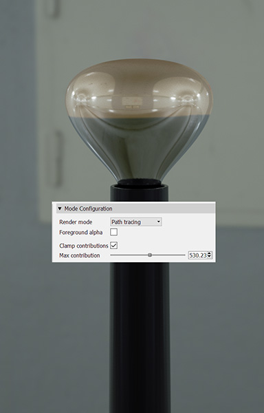

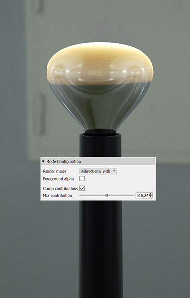

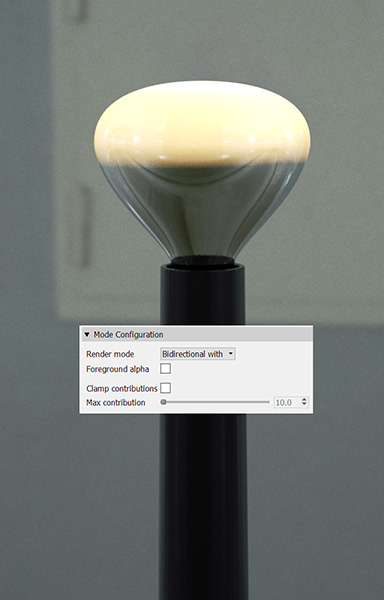

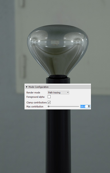

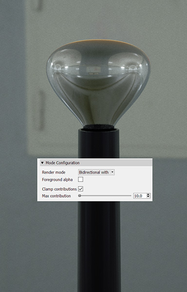

What do you mean by "uncontrollable", could you describe it a little bit more? I'm using Cindigo, and had no problems whatsoever.

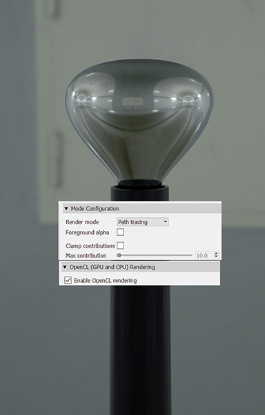

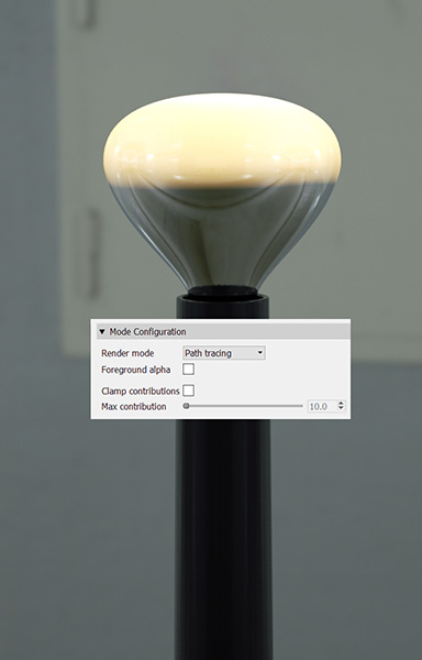

So, after testing it out for a while, I can confirm that "clamp contributions" messes up the effect we are trying to achieve here. Below is the link to testing pics, they are all renders baked under 1 minute.
https://mega.nz/#!NQogGCxa!-eyOpQjy7Kaj ... Xmup6yHxQc
Conclusion:
Not using "contributions" totally recommended.
If using "contributions" Path tracing mode is hit the hardest. BiDir recommended.
Since I'm an MTL animal, I would def. use this mode, and if I need to use CC, would def. use higher values, around the middle of the slider, or towards the end.
Well, had to eliminate it, just to be sure, sorry.
Conclusion:
Re: Foscarini lamp material
TheSquirrell, you've been of great help.
I'm attaching all of your tests as a reference, because they can be of direct use to enyone in this forum

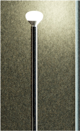

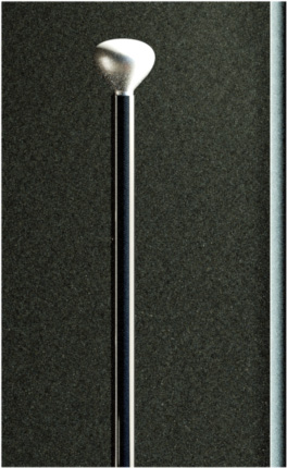

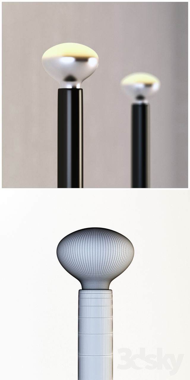

And then my two tests
My problem is that IN ANY CASE I don't get the smooth blend between metal and emissive material, but instead a very neat border, which is not real at all...
