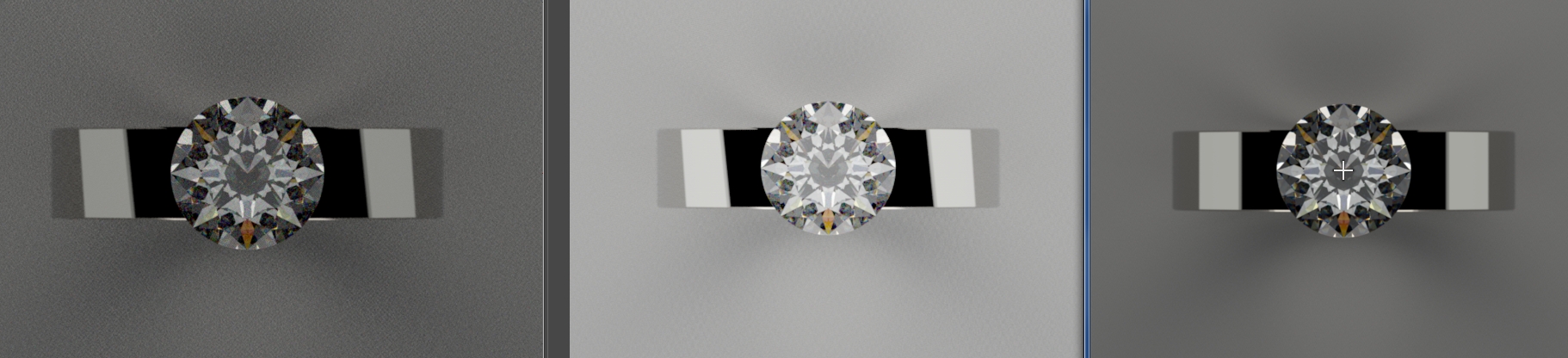

Have a look at the different renderings:
The frame on the left is rendered in editor, the middle one in Cinema's (R18) picture viewer and the right one within Indigo 4.0.54.
It's not only the different lighting.
Have a look at the reflections in the metal part. The right one alone is as it should be.
But it's still strange.

Re: Difference between internal and external rendering
Ok ..well other than the project missing the "PRO GRADIENT TEXTURE"
I did not get any big difference like you. On R18 Studio x Indigo (see pics)
But i did find something strange. Lights seem to be bent in Indigo? (see markings)
@Heliodor not sure what the problem might be.
Let's wait for the devs. To check. I can't reproduce it on my end.
I Edited the content of this message as I was saying something wrong before:
I had a look at the scene also.
The shift in lightness is obviously a gamma shift. of + 2.2
It seems like you converted the scene from a C4D Scene to a Indigo Scene. So I set the renderer from Indigo back to C4D and deleted the multi pass output. This can also be a source for errors and in the beginning I thought so. But it turned out to be not causing the issue.
For your scene it seems to work if you either set the Color Profile of C4D to linear or turn the Linear Workflow off altogether in the scene settings.
Seems like the gamma settings are somehow broken.
Tried to add it into a completely new scene, same result. ???????
