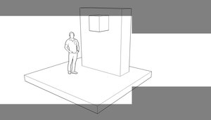

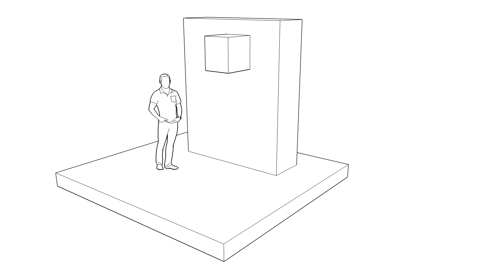

Essentially I want to export a 2D graphic of my line work to underlay the colour render in Photoshop, but everytime I export, regardless of settings I get grey bars all over the image.
These are the same grey bars that appear when you set your image size in Indigo render settings to denote the extent of your render. For some reason they appear to be going a bit mad on export. I've tried with 'fresh' Sketchup files, old files, I've tried varying combinations of resolution and output sizes and the issue only happens once you set up a view in Indigo.

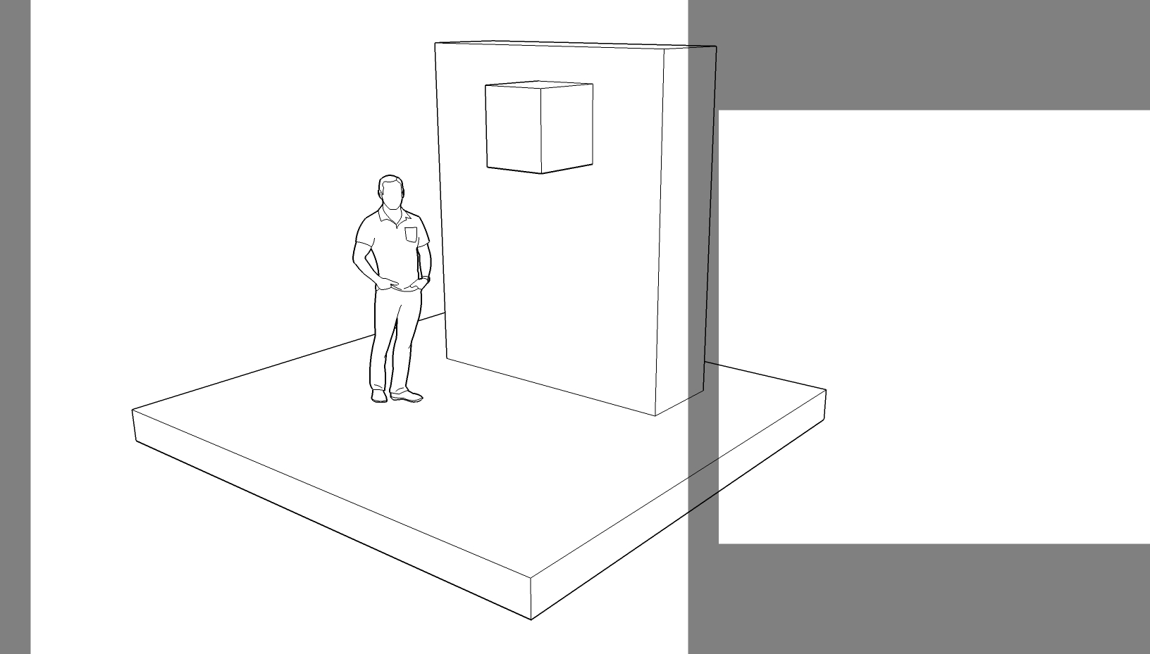

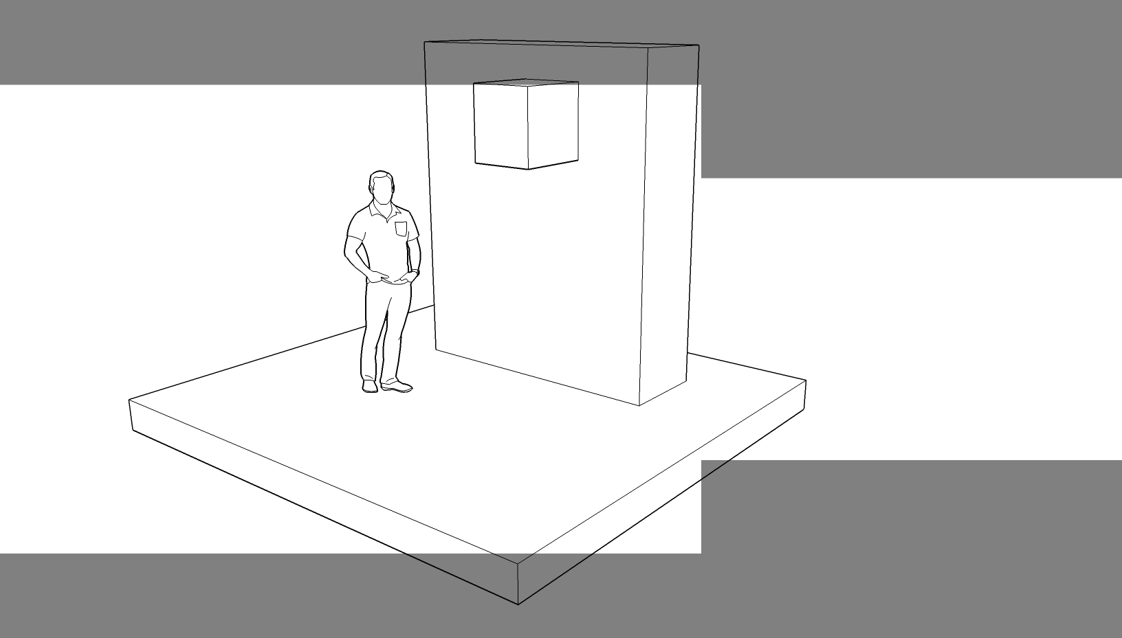

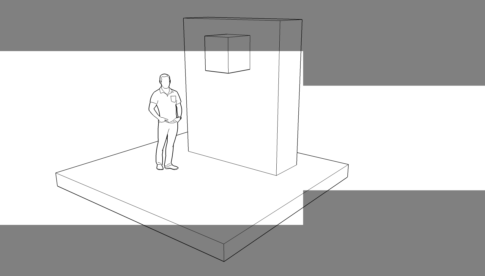

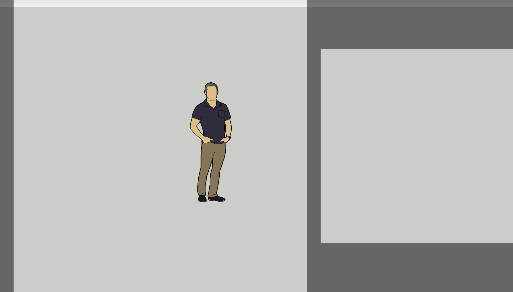

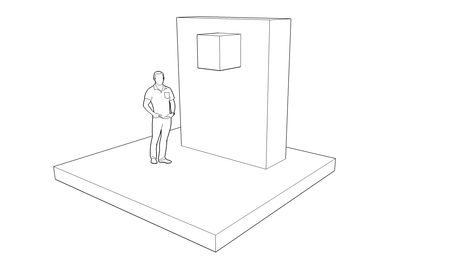

So here is a fresh file, nothing Indigo has been set up: If I export a 2D graphic from this, it all works as intended: Now, if I go to the Indigo render settings and set an output size and click apply, the grey bars appear denoting the size of the render. Which is fine and it all renders fine: The issue comes when you try to export a 2D graphic from this set up view - the grey bars have all gone a bit crazy: Changing the size of the outout in the Indigo render settings changes the behaviour of the grey lines on the 2D export, they go through varying degrees of crazy: And so on. Here is what it looks like on my working file where I have the export resolution settings set higher: I'm at a loss, hopefully someone can assist. I'm using Sketchup Pro 2017, Indigo v3.8.37, SKIndigo v3.8.35 - I think those are the latest versions?

Ok, the .skp extension is not allowed as an upload so I've put a OneDrive link below to the file. In theory though, anyone could test this by opening sketchup, setting the output and trying to export a 2D graphic - it took about 30 seconds to produce the image below, so if anyone was able to have a quick test and see if they can replicate the issue that would be appreciated.
https://1drv.ms/f/s!AkQBfbkFuV2U6nmD1lZU8kUsdTd9
It would be interesting to see if anyone else has the issue - the scene attached is literally a base sketchup scene you get upon start up. All I've done is set the output for the render to 2000x2000 in Render Settings which results in this error when exporting a 2D graphic (sketchup export settings all left as default):

Yep, same problem here. Seems to be an Indigo issue, it only happens after setting the size in the Indigo output.
I'm also using Sketchup 2017 pro.
As a workaround: Open a new Sketchupfile, import you model and export a 2d Image. Somewhere there is also a plugin for exporting your Scenes from Sketchup...

Hi Boss! Sorry for having seen this a little late maybe.
I got the same annoying issue, and I found to be sort of a Indigo camera issue.
You can avoid that by getting rid of the camera distortion SkIndigo causes when loaded. You know that SketchUp provides an "advanced camera" toolbar: try to open a new file and click on the "erase camera settings" button. You will see that Sketchup viewport goes crazy and stretches everything like hell. If you take a look at the zoom factor you will see a strange number: just reset it to a decent value (40-50) and save the file. Ok, from now on this file will be free from errors
Obviously Indigo willl render fine as always, but SketchUp will export correct images.

Hi Pibuz! Thanks for the response - sounds interesting, but in Sketchup I don't appear to have an 'erase camera settings' button. If I follow Tools > Advanced Camera Tools then the only options are to create, reset or select camera type? Unless I'm looking in the wrong place. The Indigo camera settings don't appear to have this either (SKIndigo 3.8.35).Pibuz wrote:Hi Boss! Sorry for having seen this a little late maybe.

it's the one on the extreme right!

you live and learn.. thx for this hint, never realized this button before.

Ah, ok thanks. I didn't have the toolbar out, I was just looking in the menus.
Nice one, I will try this. Thanks Pibuz!
