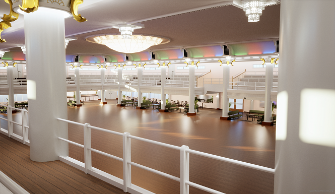

I would appreciate your feedback on this draft. For a high-res version click here: https://www.dropbox.com/s/qyy3n8qhqarlc ... 1.png?dl=0
The final images and full back-story will be published here in due course. As a quick intro, this a historical recreation of a famous dance hall built in the early 1940s and demolished a few decades ago. Obviously, I want to make the renderings as photo-realistic as possible and although I’m fairly happy with the current version I still think that it has “cartoonish” feel. Something about the colour saturation, I’m not sure what. I’d appreciate your thoughts on how to “up” the level of realism.

Well - you have an absolutely huge wooden floor that looks way too uniform to me. Then those coloured lights are extremely colourful. Those are the two things that stand out to me initially.
Re: Thoughts?
Thanks Oscar - the floor is a tough nut, I've tried to replicate the original as closely as possible which was made from 1-inch eucalyptus boards laid in the same pattern as in the picture. It was a huge floor. But I'll dial back the colour saturation a bit, and also tone down the fluro colours.

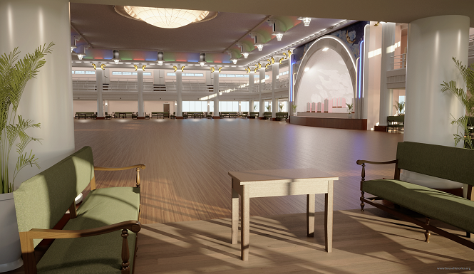

Re: Thoughts?
Are you using exponent/fresnel scale maps for the floor?
Re: Thoughts?
Nope - but I probably should, to introduce some texture. I'll get the manual out..

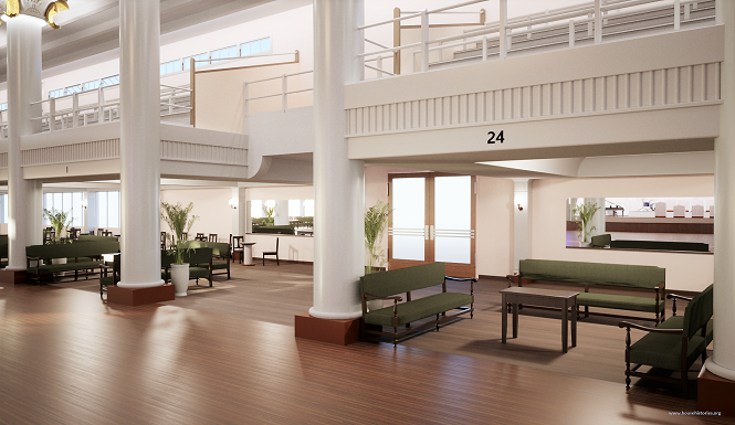

All done and published on my history research site. The Cloudland Ballroom was central to Brisbane's (Australia) social scene for many decades, and a unique building. Constructed in 1940 it was the largest and most opulent ballroom in Australia, and probably one of the largest in the world at the time.
I'm semi-pleased with the renders, due to some time pressures felt compelled to publish what I had. They probably need X2 the resolution and SPP, better and more consistent tone mapping. But - people are going nuts over them here in Queensland with lots of media attention and 1,700ish shares on Facebook.
