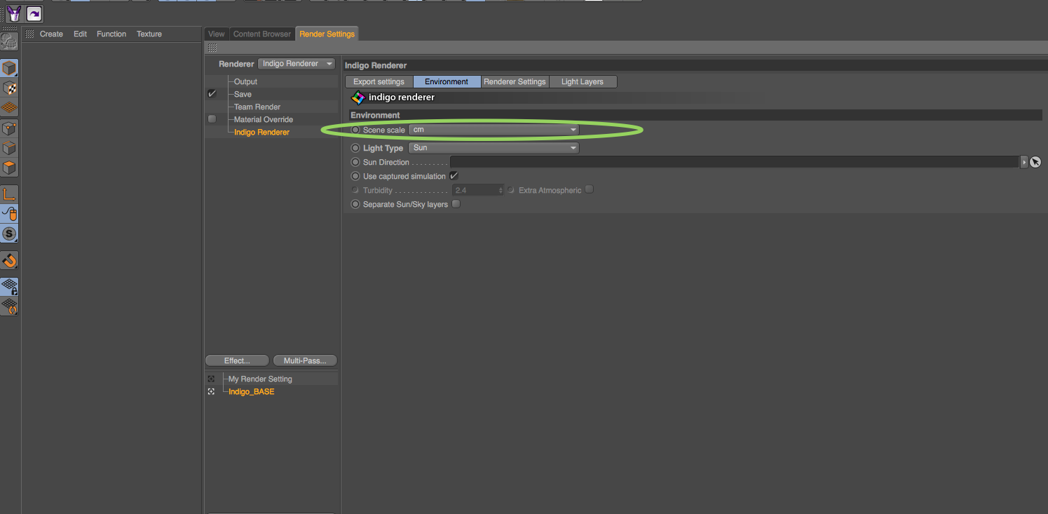

Hi
After selecting, cm, as suggested in the previous post I have activated the project Scale option from the Edit menu, then 0.5 Target stairs twice. At this point the confirmation screen Cinema me the reduction of scale. The bottom square indicates the size of the set (21.459 cm, 14.625 cm, 33.863 cm).
The gem after reduction an average size of 4x3x2 cm. They are acceptable values for medium/low carat gems. Then launching Indigo interface "scenes info" we "Scene span" 0.45 m, 0.34 m, 0.34 m. then 45 cm, 34 cm, 34 cm.

Re: Gemstones
By default this is set in cm are no changes to the settings made for previously.

Re: Gemstones
If these are the same as I found in archive3d they are off by a 10x factor. so it's a matter of set the scale to 0.1 in C4D.
