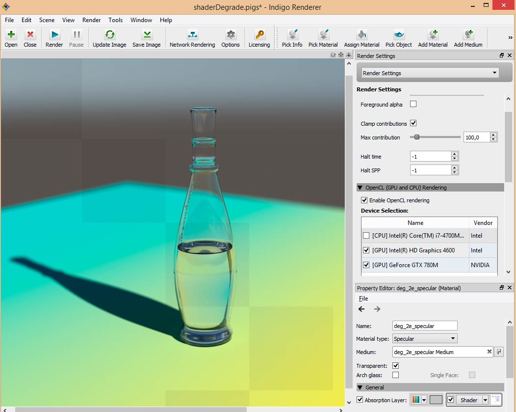

when activating Clamp contributions, in GPU mode using 2 units, some squares are present in the picture (randomly)
if only one gpu is on it's ok
if clamp is off and 2 gpus are on it's ok

Did you try 1 unit with two GPUs ? Maybe they scale together ? I'm asking in the dark.

je suis pas sûr de ce que tu demandes, là... regarde la copie d'écran ci-dessus, il y a 2 contrôleurs gpu distincts, si j'active les 2 avec le clamp ça fais le damier, un seul gpu actif avec clamp c'est bon, que ce soit l'un ou l'autre gpu
1 unit = one GPU in my mind
I have two units inside this machine, if both are running and clamp is activated, i got check pattern, sometimes after 2/3 mins that dissapear but sometimes not

The GPU renderer uses tile rendering internally, and it seems there might be a problem with the brightness of the tiles when multi-GPU-rendering + clamping.

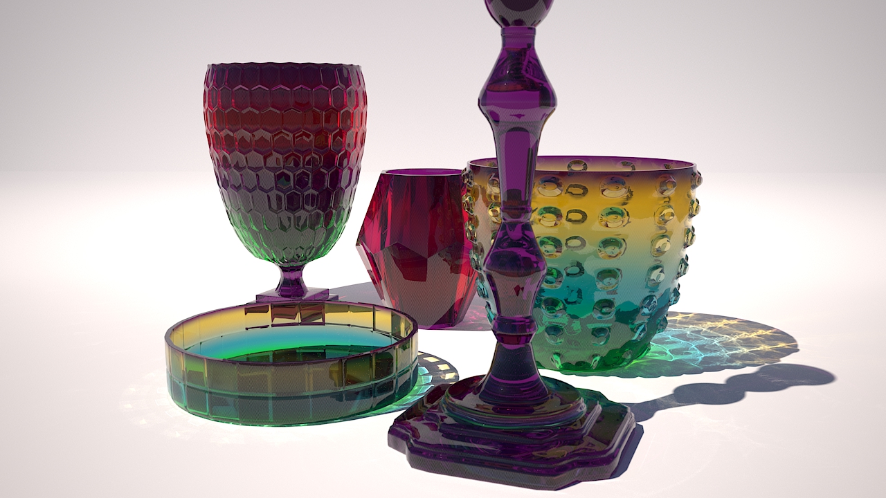

This scene is particularly suitable to test the novelty "Clamp Contributions".
Transparencies, reflections, refractions, colored shadows, glass material, and caustics. Sunlight hours pm. 14.30 yesterday the local meridian. Clamp contributions, active, Max contribution = 100.
Well fireflies are not there!

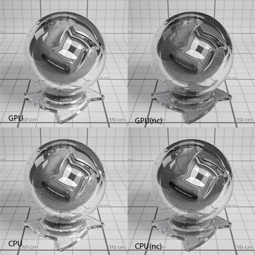

Could we have the "math" under clamp contribution?

Jay-ko wrote:Could we have the "math" under clamp contribution?
My goal is to understand how far is an unbiased image with that parameter.
Create a specular material and set the desired value, compare it with the default, you'll see that the higlights will be dimmer. I don't know if that answers your question, but the practical effect is that it will 'wash' away the light reflections.
PS- having made the test I see that it does a bit more than dim the high lights, the specular itself gets darker.
mix
GPU>CPU>CPU(nc)>GPU(nc)
CPU>CPU(nc)

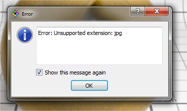

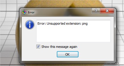

I found a new feature from my side :p, afer a resume:
Then I opened the same igi file with 3.8.23 and I can save png and jpg without surprises.
