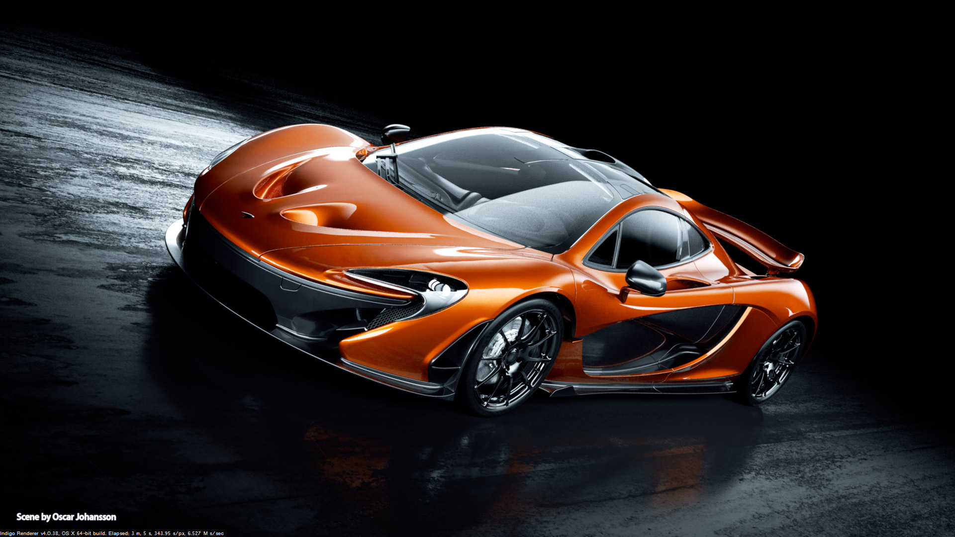

Much improved from the first Beta build!!
CPU Rendering seems faster (LOT) then before.
GPU render (correct me if i'm wrong) feel and behaves MUCH smoother! Specially on startup!
Feels like data stream is much more optimized and more efficient then before.
AND Indigo (App itself) is remaining pretty responsive during GPU rendering, which is a huge plus!
-Clamp contributions : LIKE A DREAM!
And the many more improvements i didn't even get too.
All in all very solid build!!
@Ono my two FirePro's are sending you and the Glare team hugs and kisses they feel much cooler now. :D
Check out the test scenes and render times below from Oscar and Arthur.
3min= 1.914M/sec
3min = 6.527M/sec
