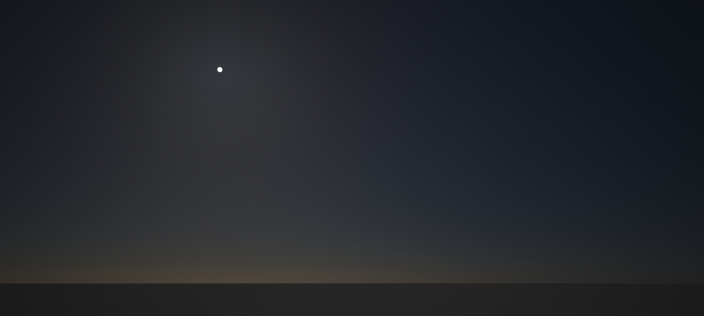

I was out for the day so I letted run a rendering for about 7hours with the clouds box going at -50meters under the bottom; the clouds start at 300m, the box is 7700x7700m and ends at 800m hight. I dont have an "amazing" processor ( i5 661 at 3.33 GHz ) but I don't see any god rays; or the render must run much more longer, or this cloud material does not create god rays..? I looked at real photos of god rays and I believe that the sun position is correct.
This has no haze options, it's the one with options for top, bottom, softclouds, gaps, caracteristic scale, offset, layers, complexity, noisescaleratio, noise strenght, stretching, absorption.

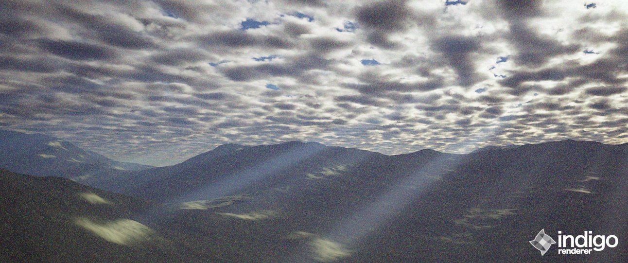

5500 Samples/p in 15h. Filtered and resized from 1920 to 1440.
Mie_cumulus phase function is extremely peak and extremely fascinating...

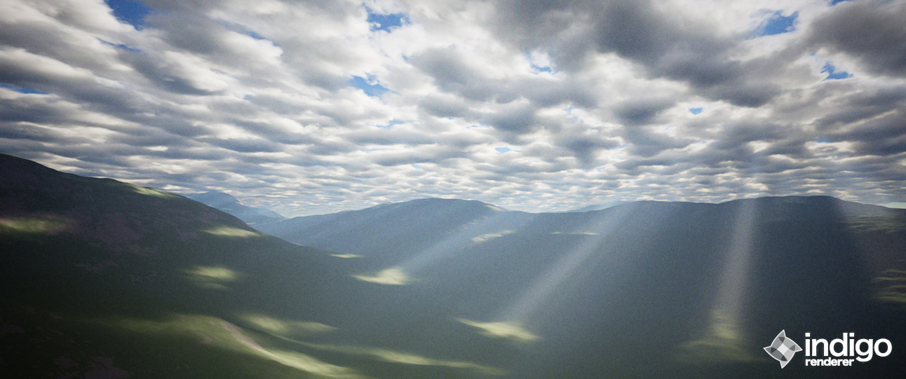

Yesterday I launched an example but don´t know why it stop at 8 hours. In the future I post a less exhaustive example. The first sign of godrays appears for me when I elevate the cloud system over 10000 meters and occlused perfectly the scene with the clouds!

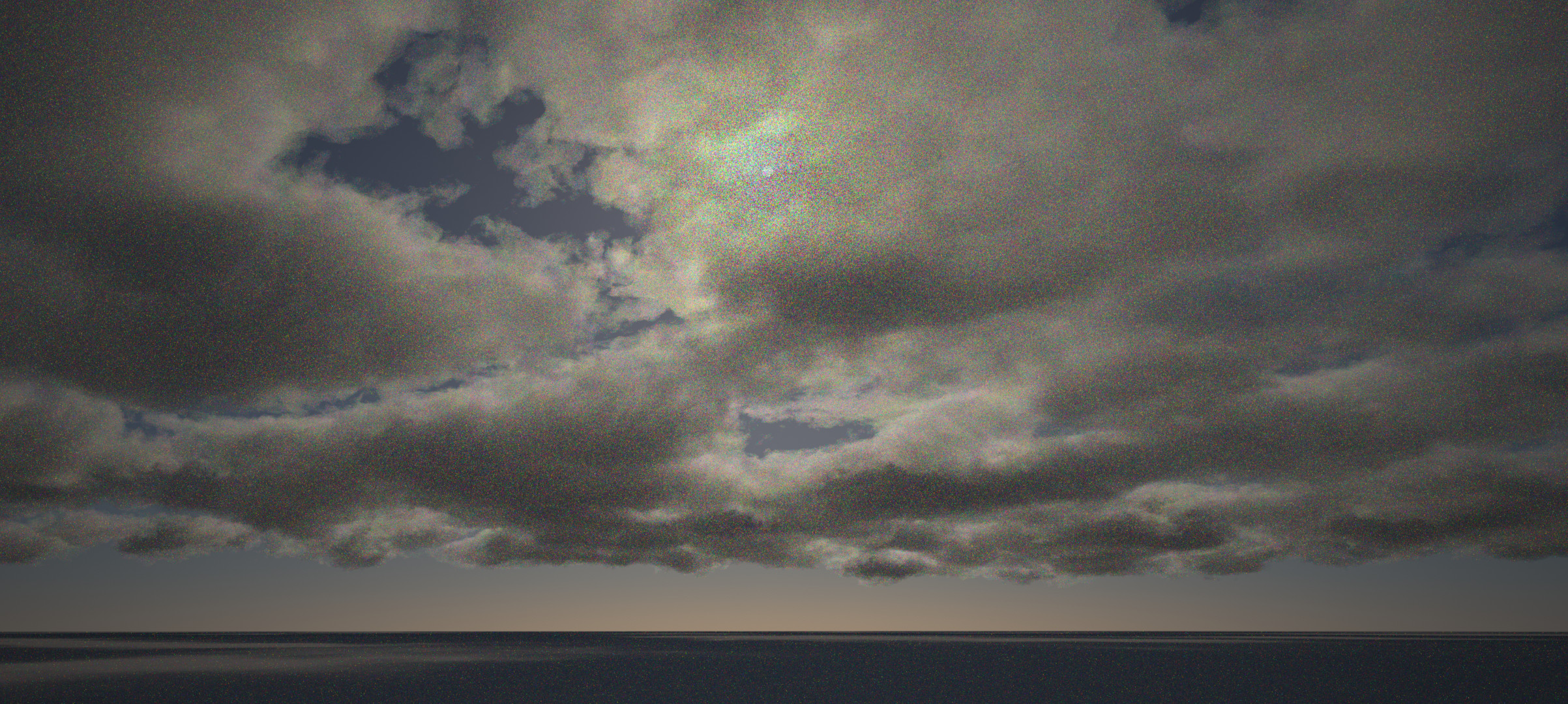

Still don´t know exactly, this is the second test; I share in the case that helps.

With uniform phase function.
15h, 6200 spp (circular aperture shape is substantially slower than a generated one, I don´t test the quality of the samples).
Clouds at 8000 m of altitude.
I was searching godrays almost a year without results...

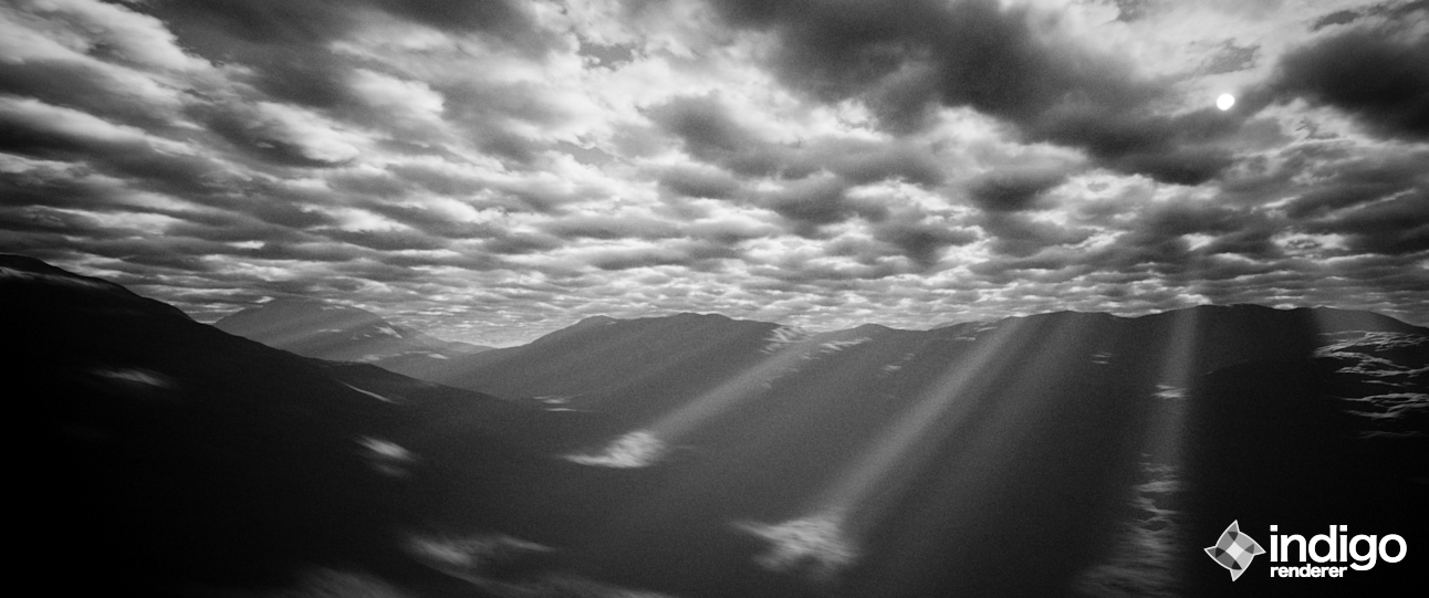

I never noticed that uniform phase function absorbs all the colors of the land, on my renders using uniform phase function for the clouds I get only the clouds being grey scaled, even in uniform sometimes they become colored from ground reflections.. on your render it looks like a black and white image or something from a horror movie

The uniform phase is right, I decided to post the image in BW with a stong contrast. I like this way, maybe an horror way but this is at the moment

9 h. and 5600 spp.
With a generated aperture runs very much faster than with circular one. The samples are of quality with an aperture radius of 0.4 (preset).
Absorption of clouds at 0.001 (more light).
With a little post process in lightroom (contrast, noise and light).
