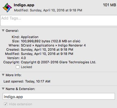

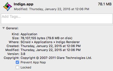

aside from the other OSX problems people have been seeing (I have the same lackluster results for GPU rendering that others have shown) I am wondering about the "app nap" feature that was introduced in Mavericks. you are able to selectively disable it on most apps, but I don't see the option with Indigo 4, see the screengrabs attached. I have a feeling that this is interfering with render performance when I leave something to run overnight, for example. any insight?

Post by fused » Fri Apr 15, 2016 3:52 am
FakeShamus wrote:aside from the other OSX problems people have been seeing (I have the same lackluster results for GPU rendering that others have shown) I am wondering about the "app nap" feature that was introduced in Mavericks. you are able to selectively disable it on most apps, but I don't see the option with Indigo 4, see the screengrabs attached. I have a feeling that this is interfering with render performance when I leave something to run overnight, for example. any insight?
Weird that it's missing. Having a look why.
in the meantime you should be able to set it like so on terminal:
defaults write com.glare.indigo NSAppSleepDisabled -bool YES
Actually not sure if it's com.glare.indigorenderer, or com.glaretech.indigo, or any other variant :D
FakeShamus
Posts: 512
Post by FakeShamus » Fri Apr 15, 2016 4:05 am
thanks, yeah I found the terminal commands for this.
also, looking into it a bit more, it seems that it's possible now for developers to include code that will prohibit app nap all together, and that check box won't appear. so maybe you guys have already prevented the app nap in this version somehow.
I'll have to see how it runs tonight. maybe there's some other factor I'm missing.
