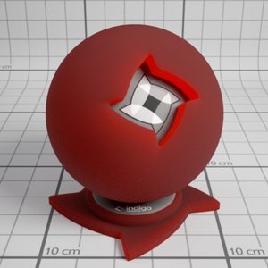

2: Found this beauty! (see pic 2) :)
3: Fast SSS is FAST AF :) Sorry for the language (pic3)

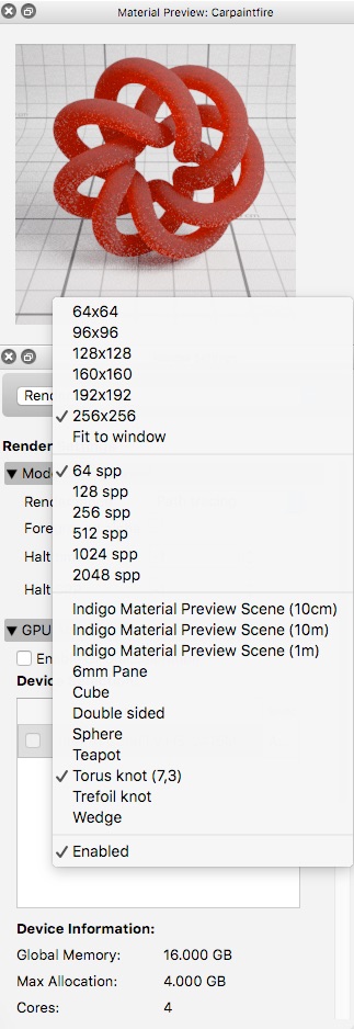

Regarding the material preview window you might want to right click and select fit to windows. Also there are dozens of other cool options there.

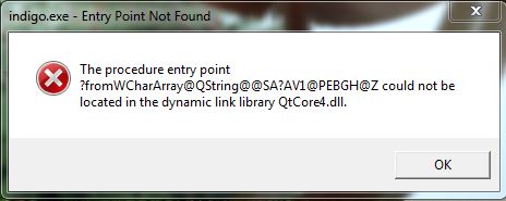

Post by aleksandera » Sun Apr 10, 2016 10:24 am
Driver 362.00 installed and still nothing happens.
Also installed Indigo RT and the first life sign looks like this:

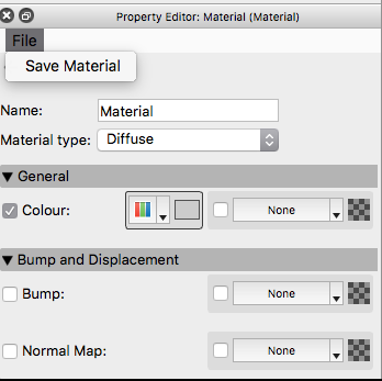

It 'possible that a material is changed or is created from scratch within the Indigo interface.
I wonder; you can save it for later use?

Post by Oscar J » Sun Apr 10, 2016 11:10 am
Yes contegufo, see screenshot.

Fast-SSS

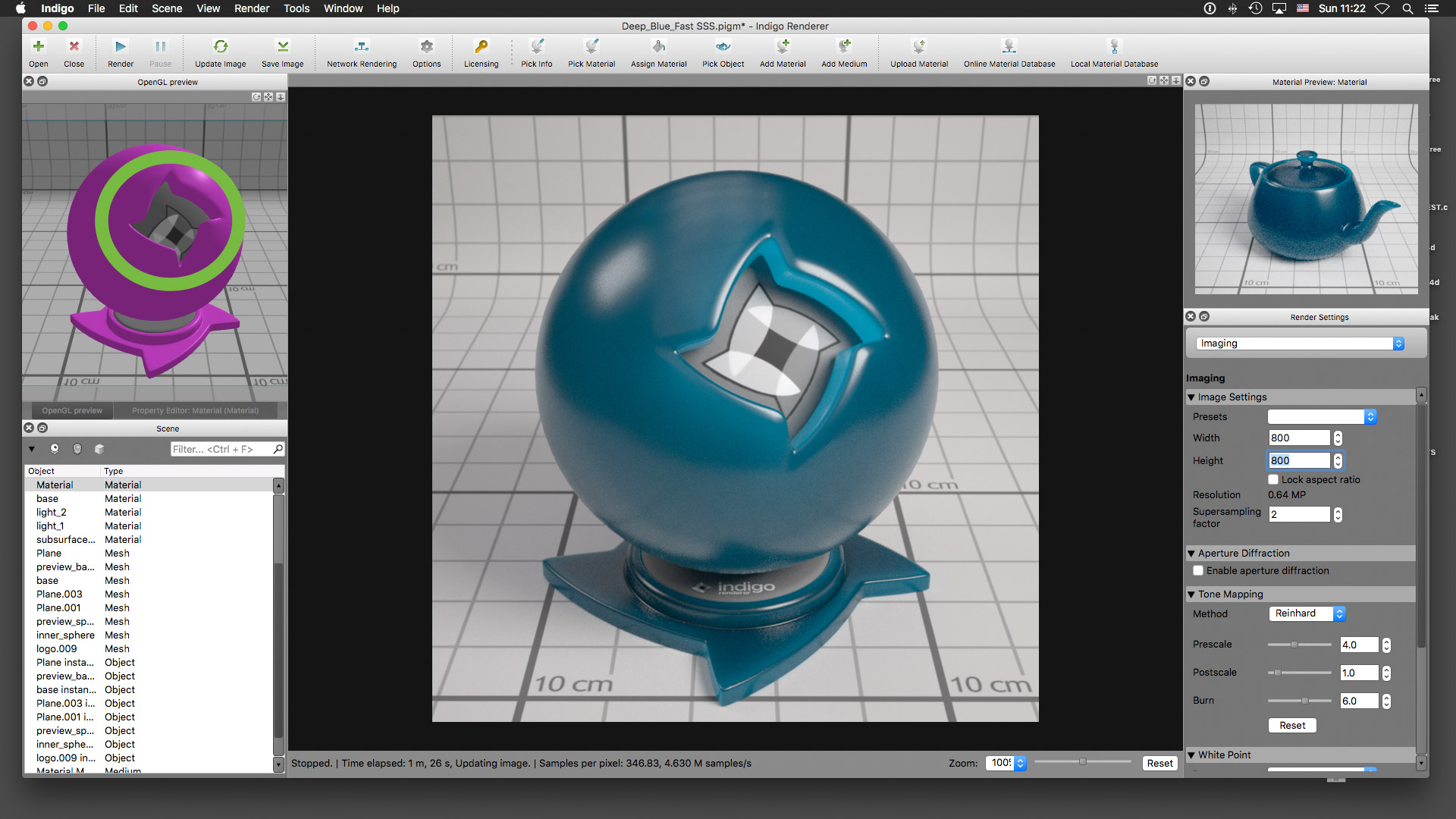

[ UPDATE ]
WOW! TON of new features in Material Preview window!! So usefull!
And by the way all of Indigo's UI is Modular now ( you can drag and drop windows and build out the perfect layout for your work! ) i think it was modular in the last v3 too...not sure how i missed that.
[ BUG ]
Found a superminor bug see the OpenGL preview on left. Indigo logo is not lining up correctly with the base mesh. ^ . ^
@ONO Very pleased to see the change in typography too! (In the welcome screen and all the way down to a more kerned UI front! Good job & nice pic on font! A Classic!
Last edited by Originalplan® on Sun Apr 10, 2016 11:26 pm, edited 3 times in total.
