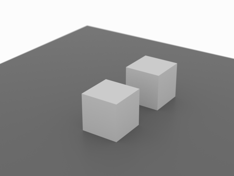

Post by pixie » Wed Dec 21, 2016 11:09 pm
I've set a simple scene, one cube has only colour another has a white colour image, then tweaked such as they would both present the same colour strength in render, I had to lower from 0.8 which I used to use to 0.61 to get equivalence.
I've been living a lie! :O
difference.rar
(196.42 KiB) Downloaded 390 times
ImageColour.pigs
(20.09 KiB) Downloaded 396 times
