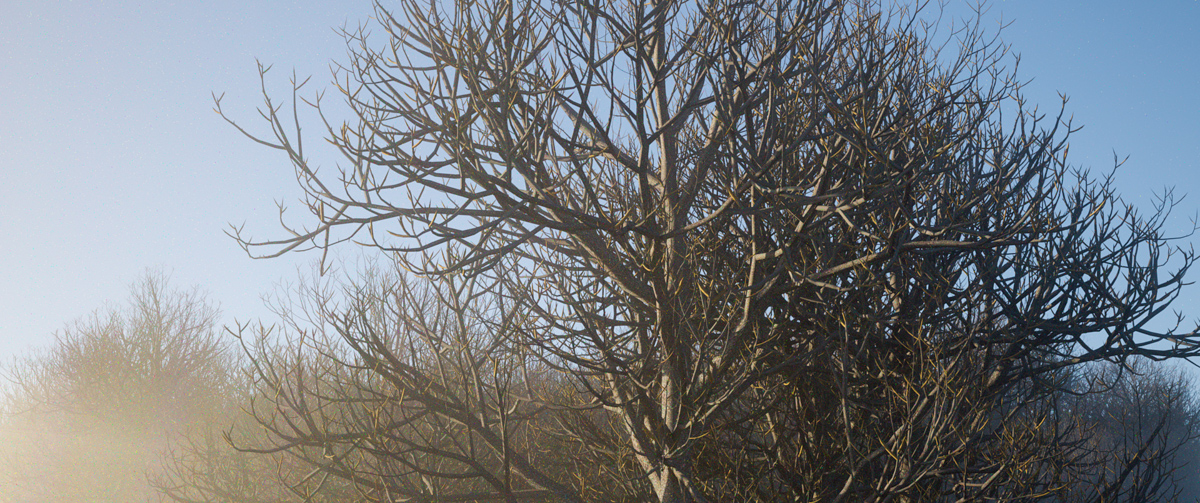

Yes Oscar. From nothing to this
Contegufo is so easy as use a box that surrounds your scene and apply a specular material with IOR 1.0 and some minimum values of absorption and SSS. There is a basic fog in the material database. There are three phase function in use, uniform (light direction don´t affects the SSS), henyey greenstein (the light advances or tend to backwards determine by a value) or mie_cumulus that is for clouds, mist, vapour...
3000 samples/pixel and downscaled from 1920 to 1200 again. Extremely peak this time... but so beautiful.
In comfort with adobe lightroom and with a new monitor no more mistakes of color and darkness hope.
If someone wants I can end the process of the HD (maybe I do anyway

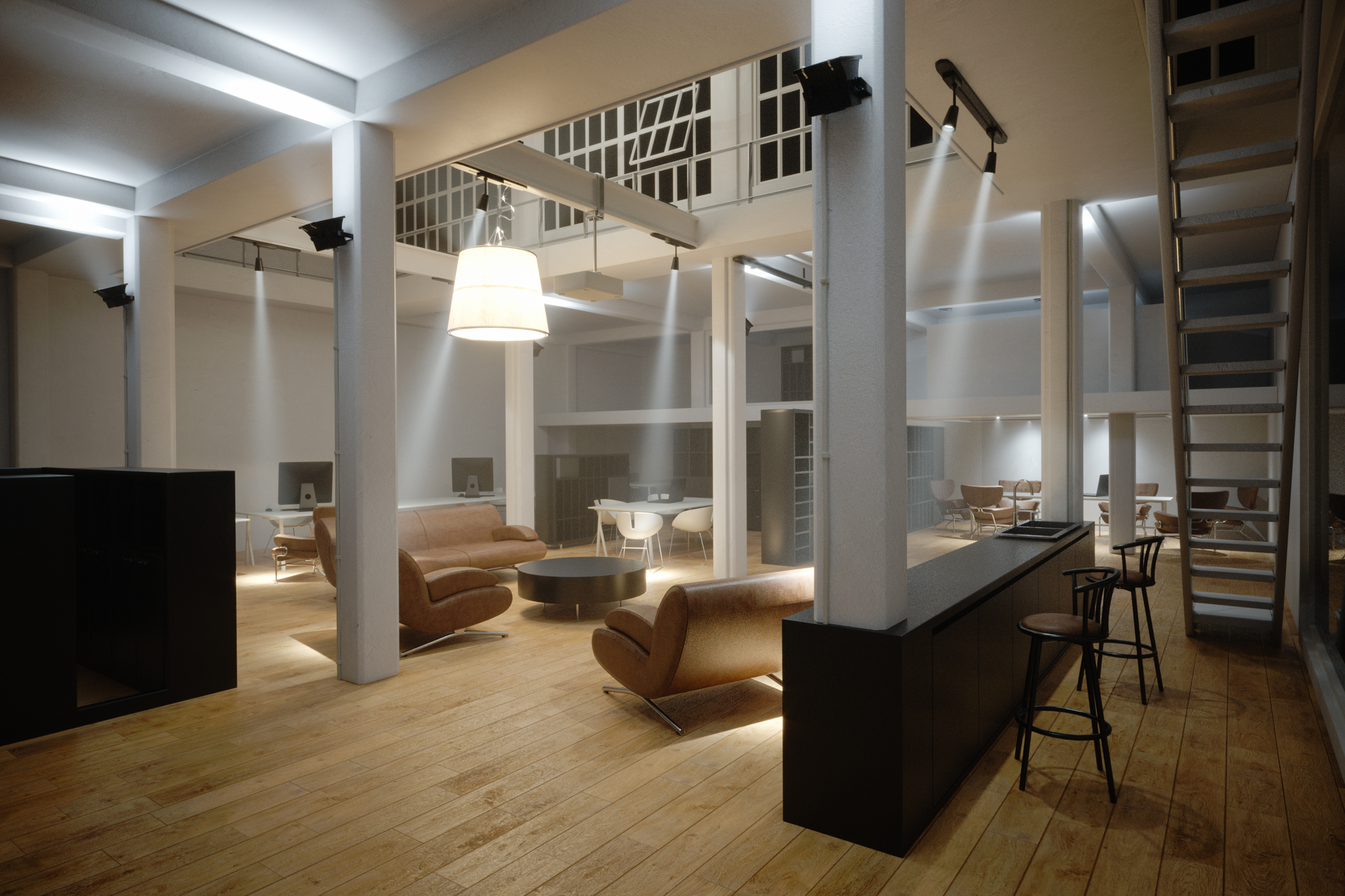

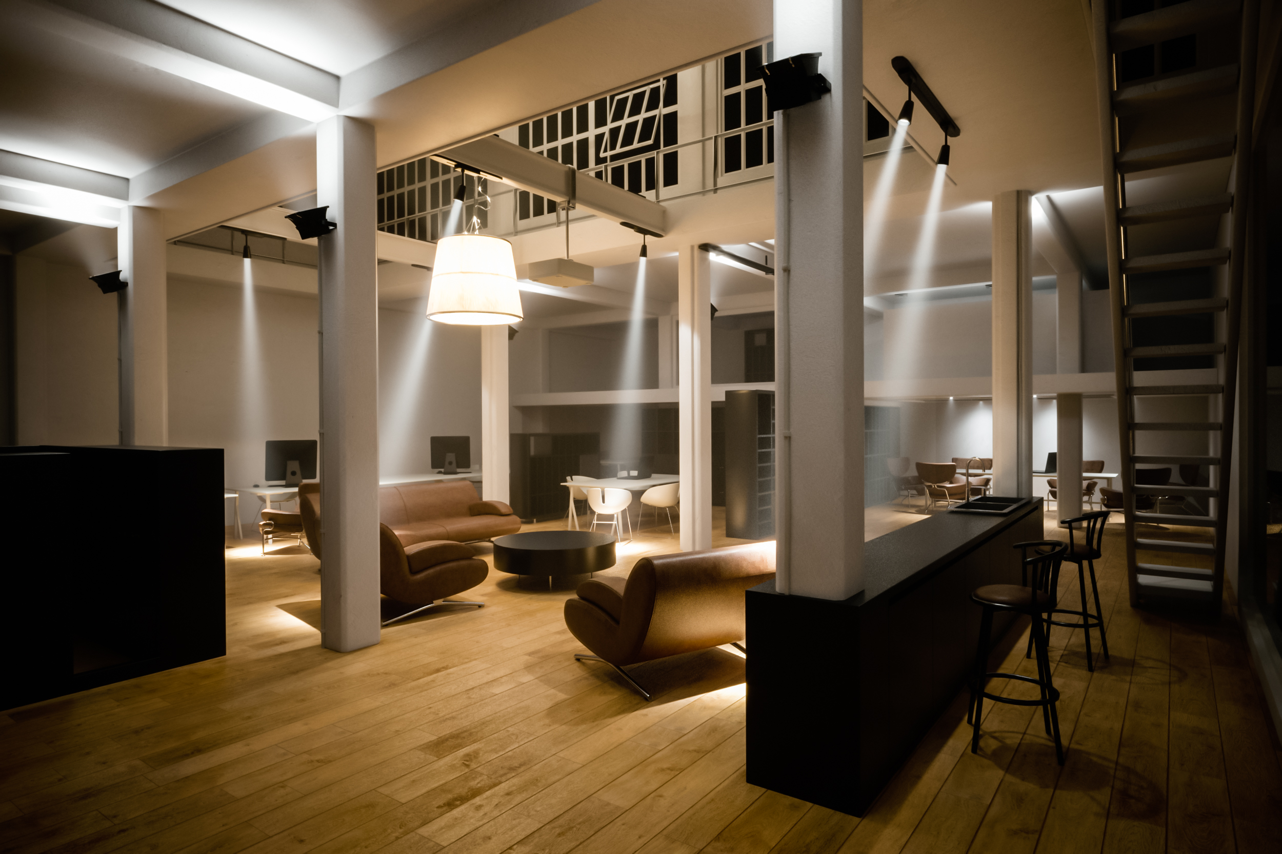

Working around with IES I realized that is not possible to simply apply the IES profile to the polygons of a bulb.
IES expetcs a simple polygonal plane. Almost here the light pattern of the IES is lighting from every polygon of the bulb with odd results.
Then I substitute some bulbs per polygons plane and the mie_cumulus phase per uniform and seems very correct. Next to come some mist in a forest

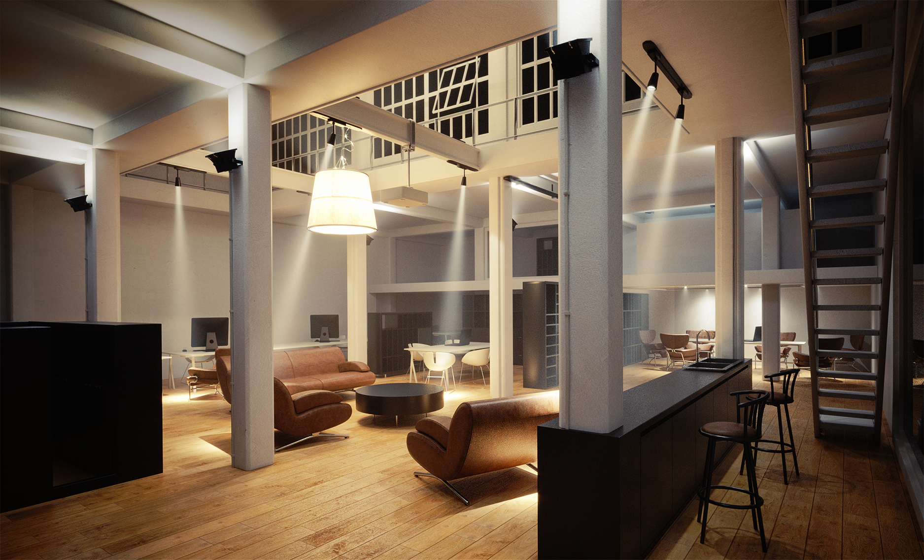

Re: A natural situation
Wow, nice one! To make the room feel more cozy, I'd make the light sources warmer, increase the contrast slightly, and lower the centre of gravity for the lighting slightly by toning down those highlights in the ceiling. Something like this
Hope you don't mind.
Yeah, that looks better!
An unfortunate side effect of using Blackbody for the emitter colour, is that the images colour balance sometimes can appear slightly green-ish (like parts of your wooden floor in your latest version). Can be fixed with the white point settings.
