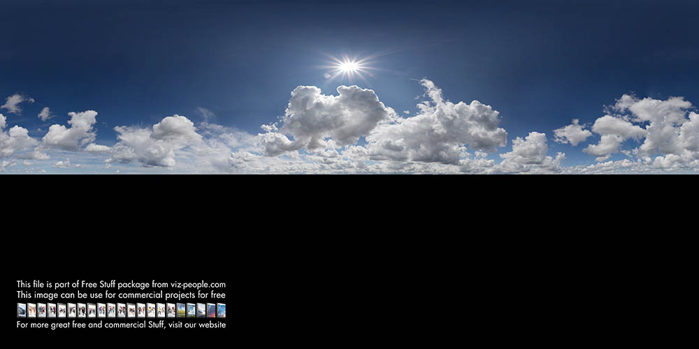

I downloaded some maps from the site http://www.viz-people.com/portfolio/free-hdri-maps/.
They have the black bottom what is the reason?

Probably because it's mainly for lighting. You're encouraged to either model the ground, or use a backplate.

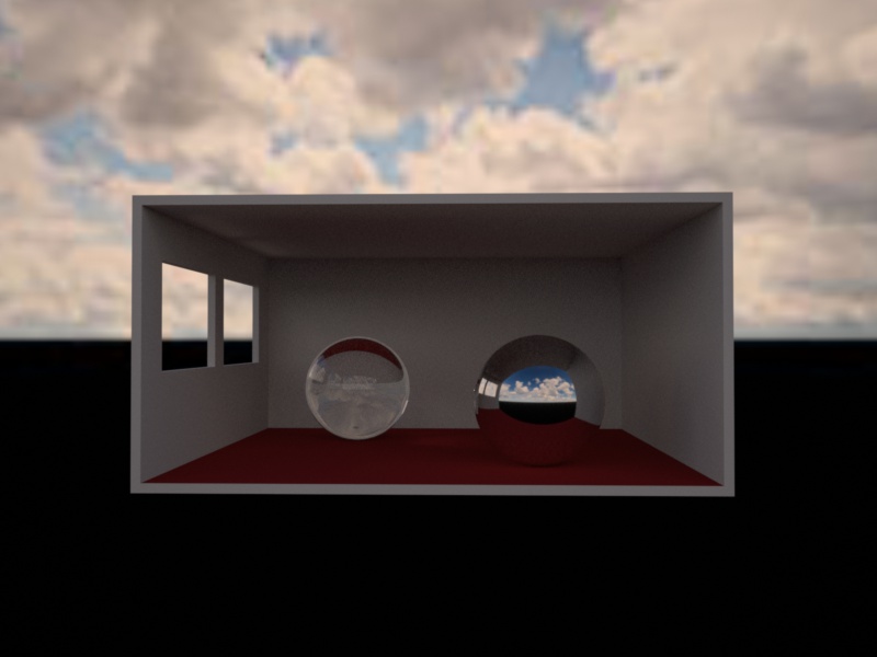

You have to build something below the horizon.

That looks crap.
Are you sure that's a HDRI? Not a jpg preview?
Re: Environment maps?
It was originally 20.000x10.000, was reduced to 1000 × 500 pixels to make a test.
yes it is a jpg.
