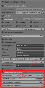

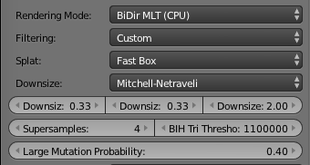

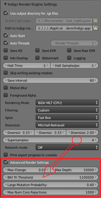

I needed to raise the Large Mutation Probability to possibly clear up the caustics in a test render a little better.
This was not adjustable through the Blendigo interface, so I've added it. As it's a parameter only used for Metropolis Light Transport it only shows up when MLT is activated in Blendigo.
Slowly but surely (but slowly!) I get the hang of the simpler things in Bendigo's Python code.

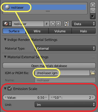

- 1. I want to add an Emission Scale sub-panel when External is selected in the Materials panel.

Not sure this has been explained before but some other settings in Blendigo have hard limits and soft limits.
For example Supersamples:
- The soft limit affect how high/low you can set the value with the slider and arrow through the Blender panel and I've set this to 6.
- The hard limit is 10. This allows yo to edit the value by entering the desired value with the keyboard between 6 and 10

OK. I now have aded an Emission Scale sub-panel to the External Material type.
Naturally that only applies when an external material is actually a light source.
The only drawback I've not been able to get around it that the Material Name must be the same as the File name. Maybe I'll find a way around that but for now I'll leave that alone.
This was definitely more complicated than I had anticipated but a good learning experience nonetheless.
Now I'll try to fix the light layer gain and hopefully don't break anything in the process.

Since you are on it: The 3 parameters of the Mitchell-Netraveli Filter aren't named all "downsize" but Ring, Blur & Radius...
Maybe you can adjust them quickly while you are browsing the code again
