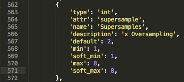

Oscar J wrote:Another minor bug: the max SS value in Blendigo is 4. In some cases I find myself having to crank it up to 5, would be nice to be able to do that in Blendigo.
as I am examining the Blendigo code at the moment this one should be very easy to change yourself.
Go into the Blender User Preferences Panel into the Addons tab and note down the location of the folder where the Blendigo addon is stored.
Navigate to the sub-folder /properties and locate and open the render_settings.py file.
Change the numeric values in Line number 570 & 571 from to whatever value you like (I arbitrarily chose 8 ) , save the file and restart Blender.
