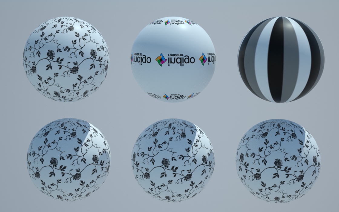

Ok, for variant A (random texture per instance) the code looks like this:
NUM_TEXTURES needs to be set to the number of textures in the shader.
<material>
<uid>4</uid>
<name>ball</name>
<phong>
<diffuse_albedo>
<shader>
<shader>
<![CDATA[
def eval(vec3 pos) vec3 :
let
NUM_TEXTURES = 3
tex_index = floorToInt(gridNoise(real(objectId())) * NUM_TEXTURES)
in
sample2DTextureVec3(tex_index, getTexCoords(0))
]]></shader>
<texture>
<uv_set_index>0</uv_set_index>
<path>indigo_logo.png</path>
<exponent>2.2</exponent>
</texture>
<texture>
<path>tester.png</path>
</texture>
<texture>
<path>blackrose_pattern.jpg</path>
</texture>
</shader>
</diffuse_albedo>
<exponent>
<constant>100</constant>
</exponent>
<layer>0</layer>
<ior>1.2</ior>
<nk_data></nk_data>
</phong>
</material>

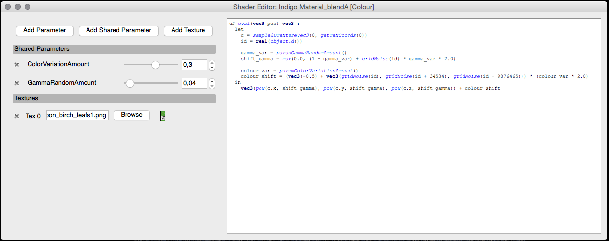

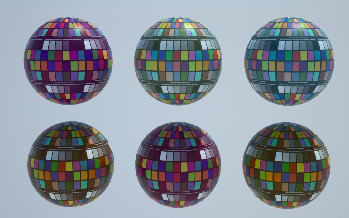

Colour and gamma variation shader:
PIGS attached to play with.
<material>
<uid>4</uid>
<name>ball</name>
<phong>
<diffuse_albedo>
<shader>
<shader>
<![CDATA[
let
c = sample2DTextureVec3(0, getTexCoords(0))
id = real(objectId())
gamma_var = paramGammaRandomAmount()
shift_gamma = max(0.0, (1 - gamma_var) + gridNoise(id) * gamma_var * 2.0)
colour_var = paramColorVariationAmount()
colour_shift = (vec3(-0.5) + vec3(gridNoise(id), gridNoise(id + 34534), gridNoise(id + 9876465))) * (colour_var * 2.0)
in
vec3(pow(c.x, shift_gamma), pow(c.y, shift_gamma), pow(c.z, shift_gamma)) + colour_shift
]]></shader>
<param>
<real>
<name>GammaRandomAmount</name>
<description>Amount of variation of texture gamma</description>
<min>0</min>
<max>2.0</max>
<value>0.3</value>
</real>
</param>
<param>
<real>
<name>ColorVariationAmount</name>
<description>Amount of colour variation of texture</description>
<min>0</min>
<max>0.5</max>
<value>0.04</value>
</real>
</param>
<texture>
<path>ColorChecker_sRGB_from_Ref_CMYK.jpg</path>
</texture>
</shader>
</diffuse_albedo>
<exponent>
</exponent>
<layer>0</layer>
<ior>1.2</ior>
<nk_data></nk_data>
</phong>
</material>

- zeitmeister
- Posts: 2010
Re: [REQ] Indigo instance color variation shader
Wow Ono, thank you very much!!
Do you think it would be possible to Access the Shader Input fields 1:1 in the plugin exporters? That would save a lot of time.
Cheers, zeiti
Cheers, zeiti

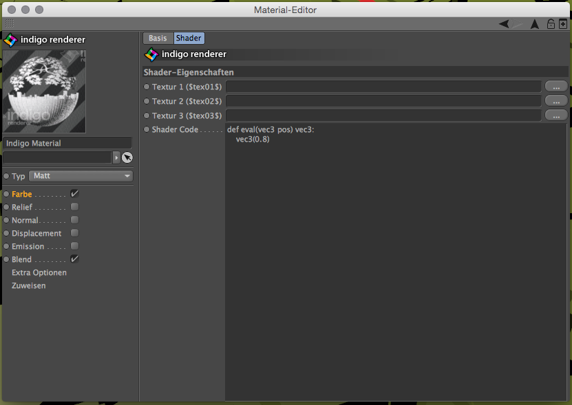

- zeitmeister
- Posts: 2010
Indigo GUI:
C4D GUI:
- zeitmeister
- Posts: 2010
Works like a charm, Ono!
Got to find out how to setup the Code for c4d...

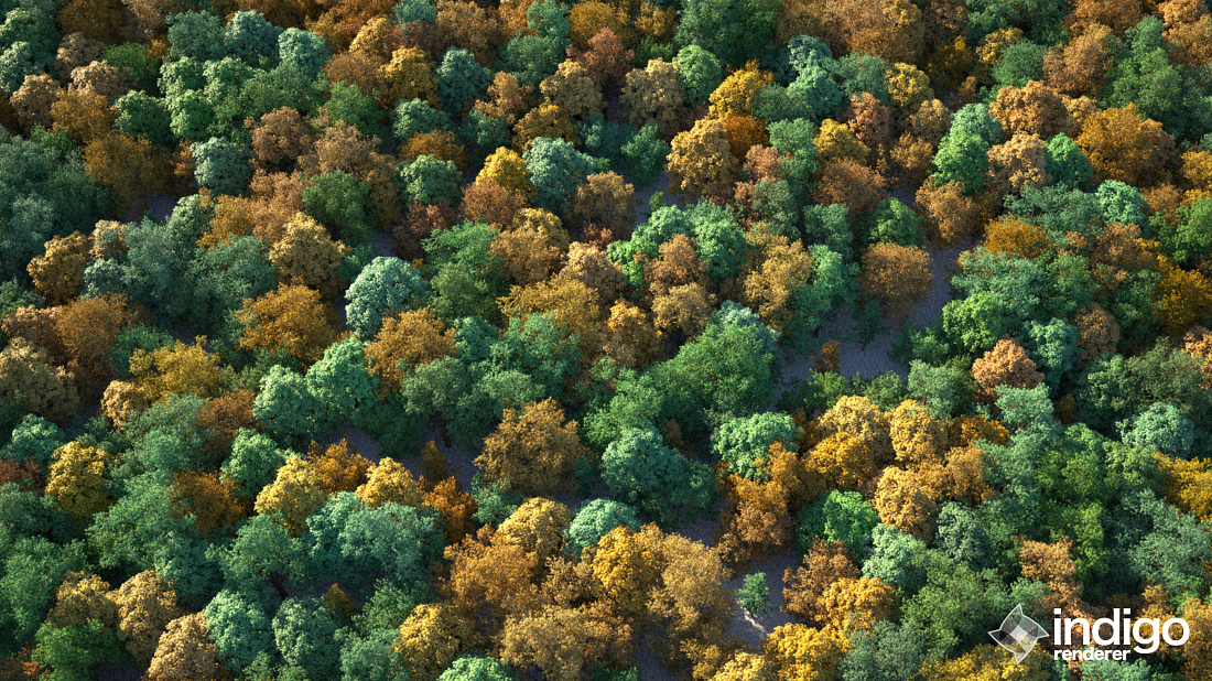

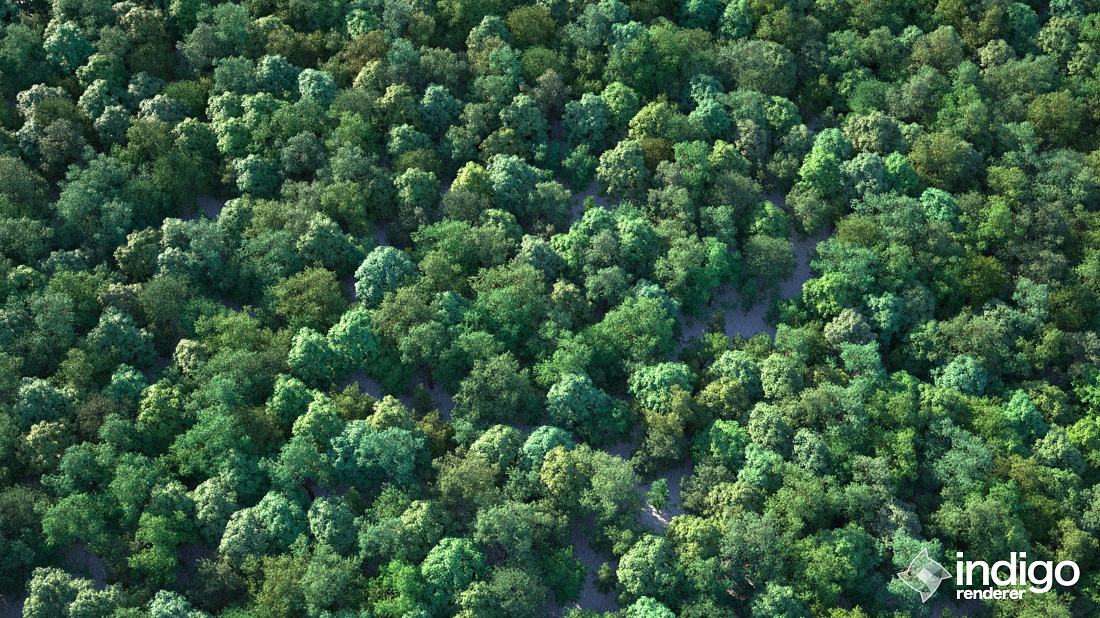

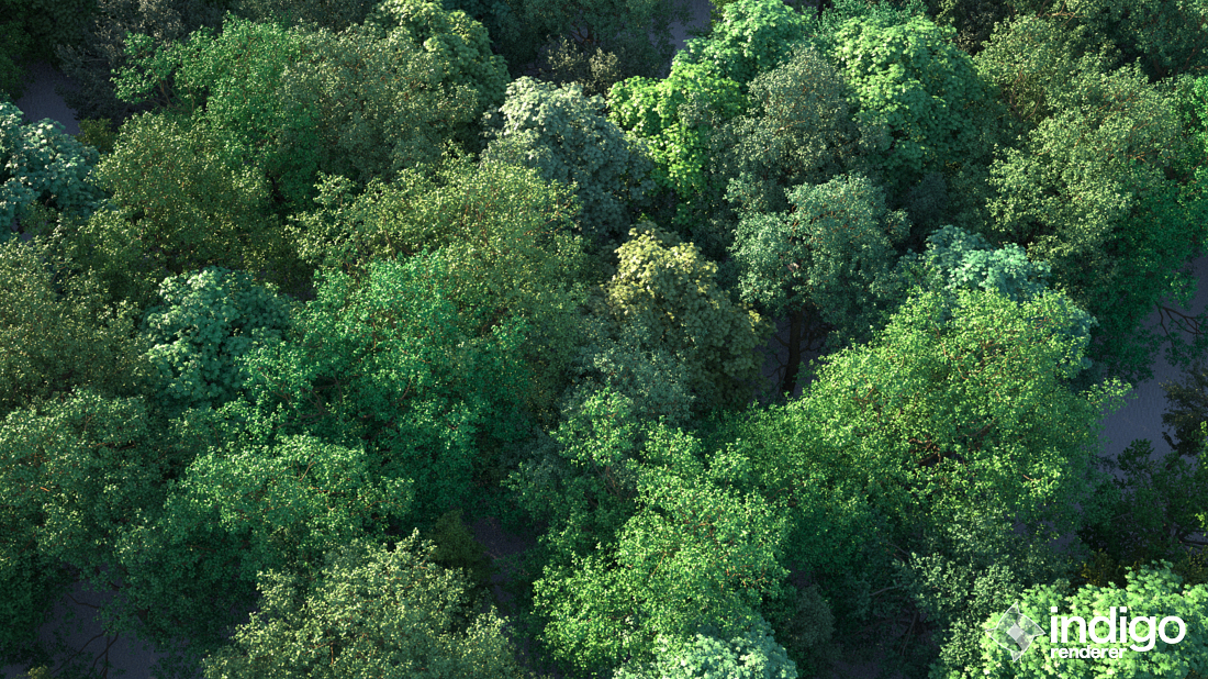

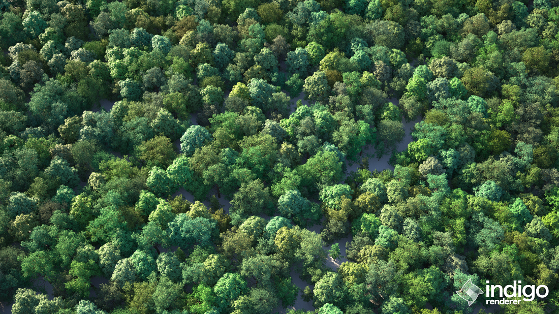

Got it!
First three images ONLY ONE color texture. There are 8 different trees with 8 different alpha leaf blend materials; all accessing the main color changer material.
So this way I got to change/apply/setup the color variation shader ONE TIME, but get 8 different alpha leaf materials out of it.
Last picture using ONLY TWO textures, but color and gamma variation applied.
let
NUM_TEXTURES = 2
c = sample2DTextureVec3(tex_index, getTexCoords(0))
in

- zeitmeister
- Posts: 2010
Thank you a lot!
The only knickknack is the fact that setting up the shader is not possible in the C4D exporter.
fused may have to invest work here, so that the C4D Indigo shader window offers the same possibilities as the Indigo standalone GUI shader window. Plus working and exporting things correctly.
BTW: Ono, does that shader "flicker" or sample everything new when rendering an animation?
And if yes, how can we interdict that?
