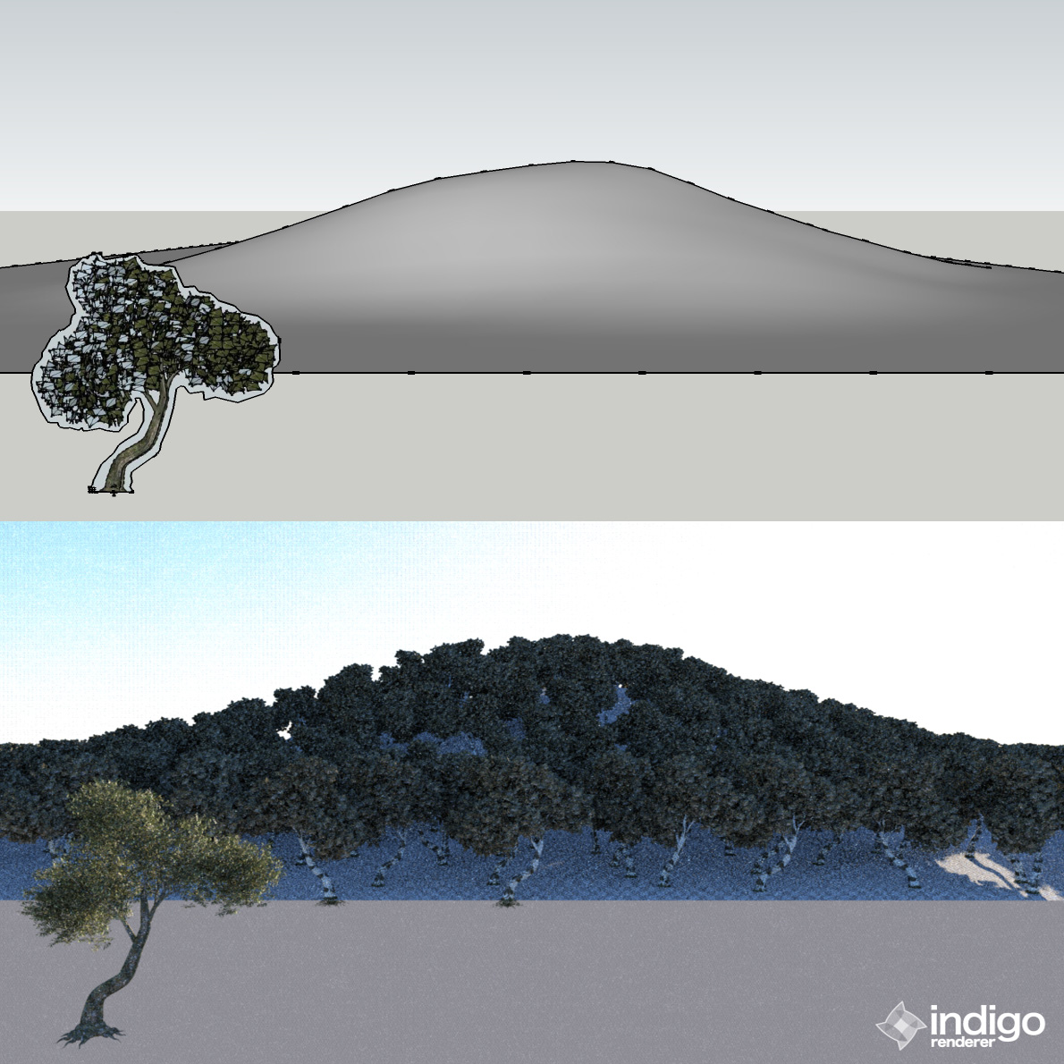

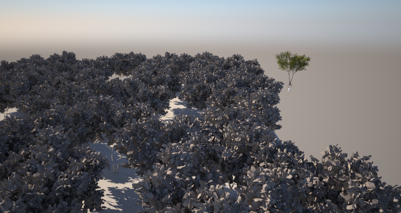

I have the same problem with linked obj trees by Xfrog. As you can see in the Indigo screenshot, there are many proxies which were not replaced by external meshes. And the strange thing for me is, that original proxy is replaced by linked model. Am I doing something wrong?
SU screenshot
Indigo screenshot, only one (original) proxy was replaced...

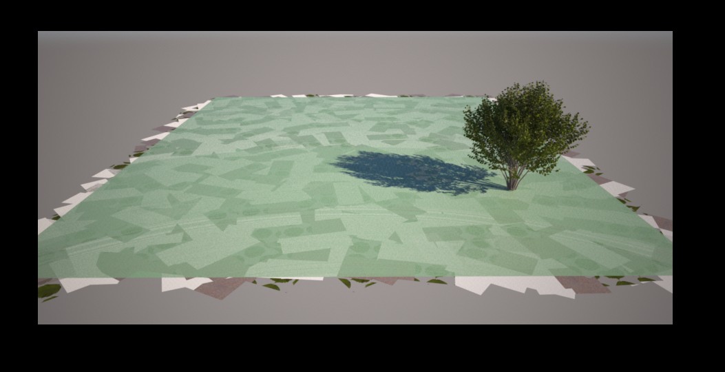

I have been trying to find a solution for described problem. So I made a new group linked to external .obj model and tried to scatter it. The result I got was image full of scattered object, but with wrong textures - you can see it in the picture, that bark texture is wrongfully mapped on needles and branches. And the original model is OK, as it was in previous case. Does anybody know, how to solve it? :(
indigo screenshot

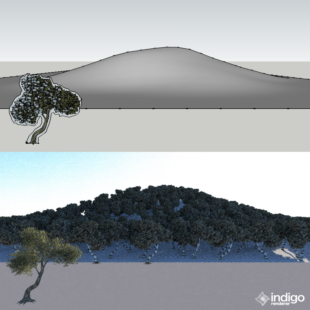

Post by Antonis777 » Mon Mar 02, 2015 4:02 am
These are the results I got. Wrong textures with scatter editor.

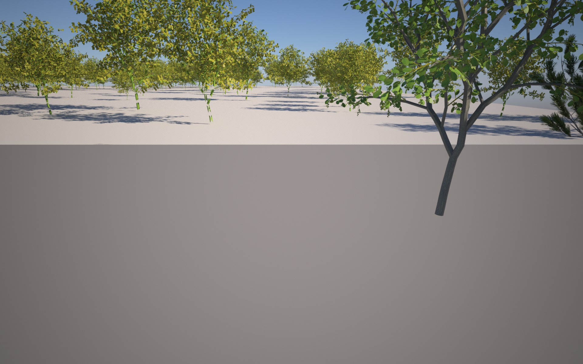

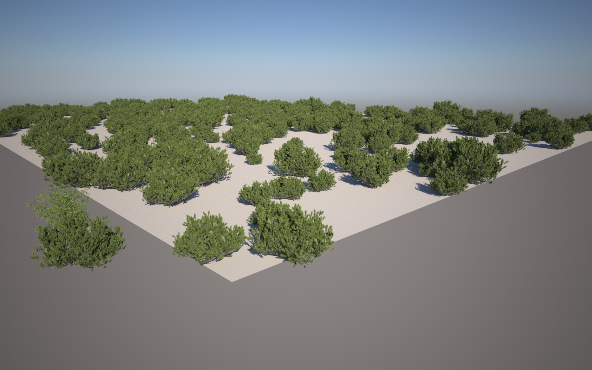

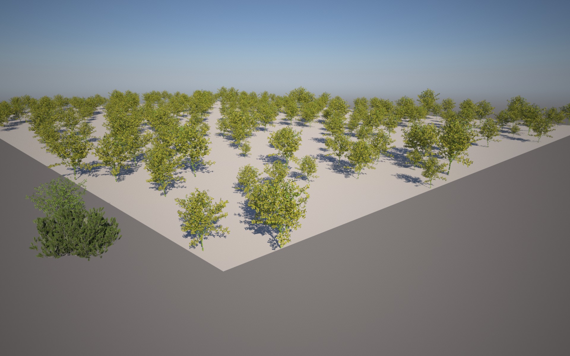

thanks for the link. I have tried to do it as you advised but with no success. Are you really sure it is working? It seems to me, that scattering tool exports only two materials of external obj (or some order of materials, I am not sure). Let me show it:
There are two models in my test scene:
Dwarf pine (Pinus mugo), containig two materials (needles and bark, no default material)
Alder buckthorn shrub (Frangula alnus), containig five materials (bark, trunk, leaf1, leaf2, leaf3, no default material)
When I scatter dwarf pine, everything seems ok. When I scatter alder shrub, first it looks good, but there is something wrong with the color of leaves. When you take a look in the detailed picture, you can see that textures are (again) wrongfully placed (twig texture instead of leaves, leaf texture instead of bark).
Antonis777:
Yes, I am doing it with the scatter editor.
dwarf pine scatter, good result
alder scatter, seems good but what is wrong with the colour of leaves?
alder scatter, detailed view, wrongfully placed textures, leaves instead of bark, etc...

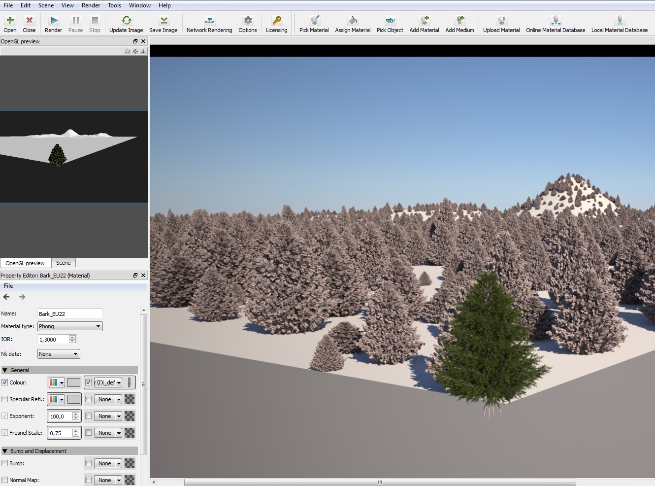

I am having the same issue as Snorky. Dummy components referencing external meshes render properly, but when scattered, the same dummy components have no textures. (See attached picture.) In the link above, the suggestion was to replace the default texture on the component with something (anything?) else. I tried this, to no avail.
Has anyone found a solution? Could someone share a file that worked correctly?
